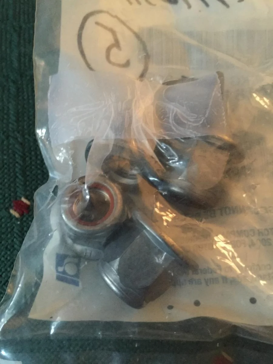

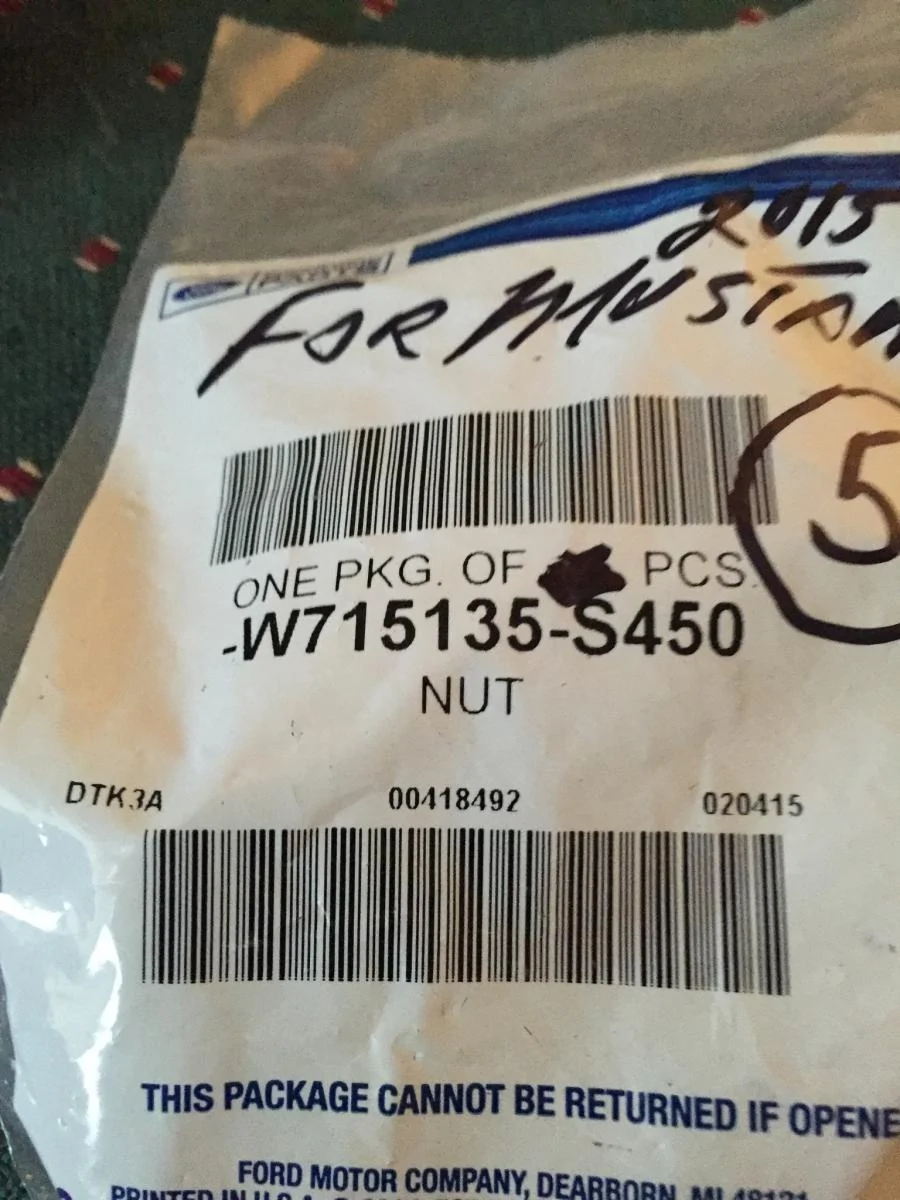

nk
Thank you for the part numbers. However I believe that these nuts will be included in the Ford Racing Strut Tower Brace Kit that I ordered from CJ Pony last week to get the cowl C-Brace. With the GT Cross Strut Bar I currently have install on car I used 15mm nuts that I bought at local auto parts store. It turns out there 3 different pitch 15mm nuts. The courses pitch is the correct one. I had to try all three to find the right pitch. Also I tried to buy the nuts at the ford dealer where I bought my car and they did not stock them. When I sell the black Ford Racing cross bar I will include the nut that I am now using. I will install brace when I install the Steeda Pro-Action Shocks & Struts that I ordered today. With the installation of these two items it complete all of the suspension mods I intend to add to my car. I can't lower my car because it already slightly scraps going in and out of garage.

Less Weight
Dec 20, 2015
431
139
East Coast
2016 Mustang GT
[MENTION=20461]Less Weight[/MENTION] I installed this on my non-PP car and went to Lowes hardware section and got 4 bolts M8-1.25x30mm and some 5/16x1-1/4" fender washers. I wasn't able to find the bolts in the diagrams on ford parts website.
Thanks man. Much appreciated.:)
This photo is the strut nuts you need.... Hope this helps you. :cheers:
Thanks! :)
