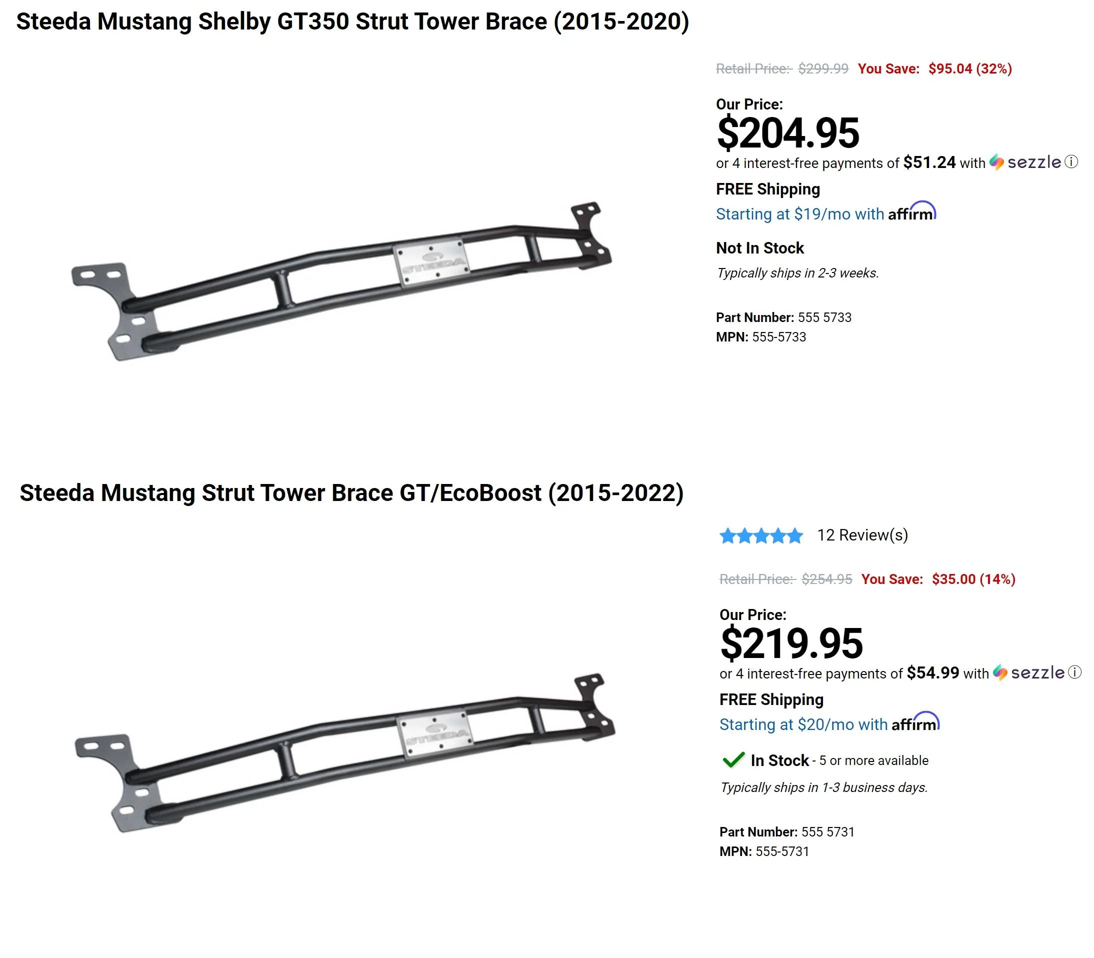

What are the differences in the Ecoboost, GT, Mach1 and GT350 strut tower braces? From searching, it appears that the GT350 is aluminum. But when looking at the aftermarket (such as Steeda and others), there are two different part numbers (Part Number: 555 5733 vs Part Number: 555 5731 for Steeda). So, what's the difference?

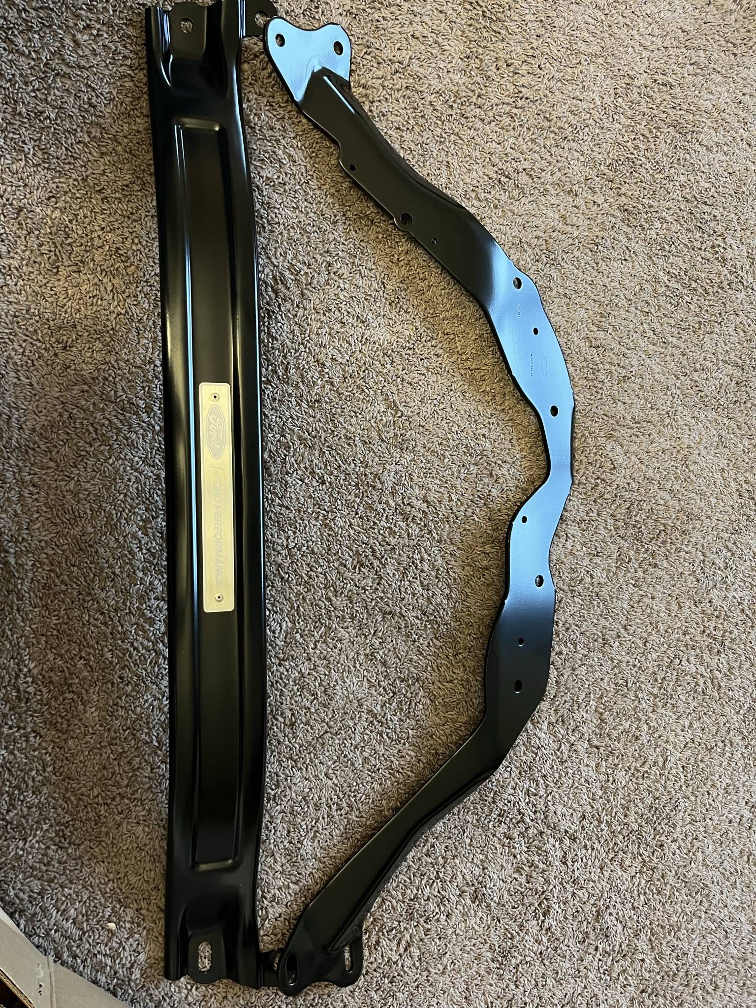

It appears the factory is just one piece of stamped steel.
Thought it appears that the GT350 is three pieces welded together.

Right, but why are there two different part numbers for seemingly similar aftermarket braces? I assume the GT350 has different fitment issues from the standard GT/Ecoboost. What is it? Why won't they interchange?
I went to the source, our head of manufacturing:
The braces themselves are the exact same. The spacers that come in the kit are different.
Hope that helps in your purchase decision - please let me know if I can help assist further.

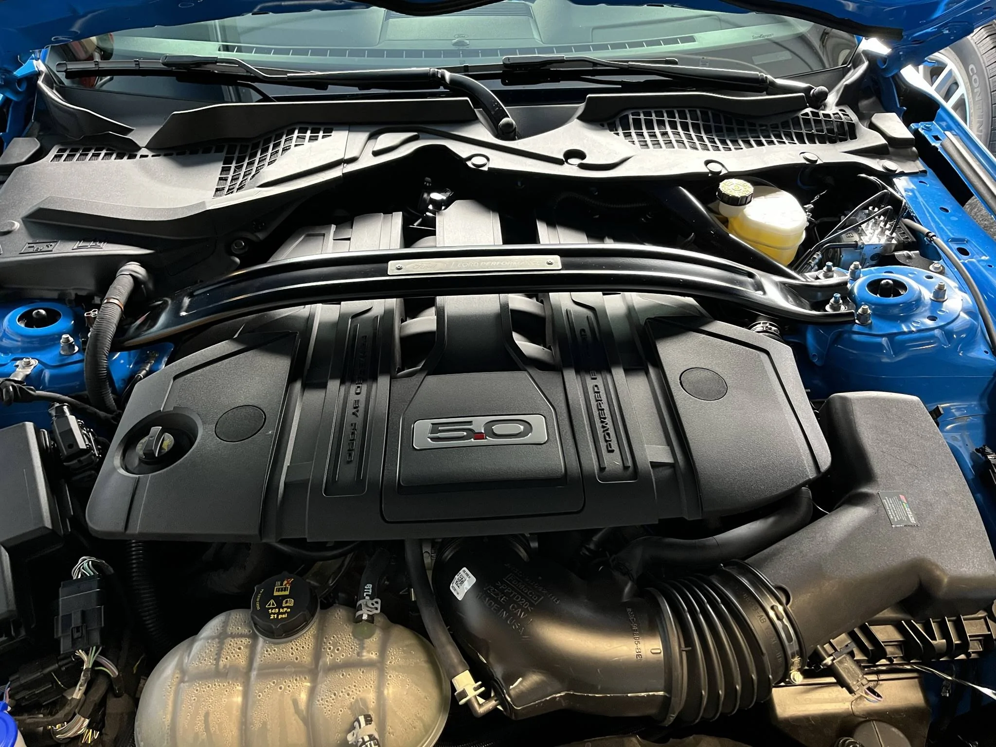

I did the FP kit and it’s a 2 piece from FP. You have to buy the extension piece referenced in the thread that CJ posted separately. Here’s the FP kit and the kit installed. I did purchase the extension and installed it just didn’t take any pics of it
