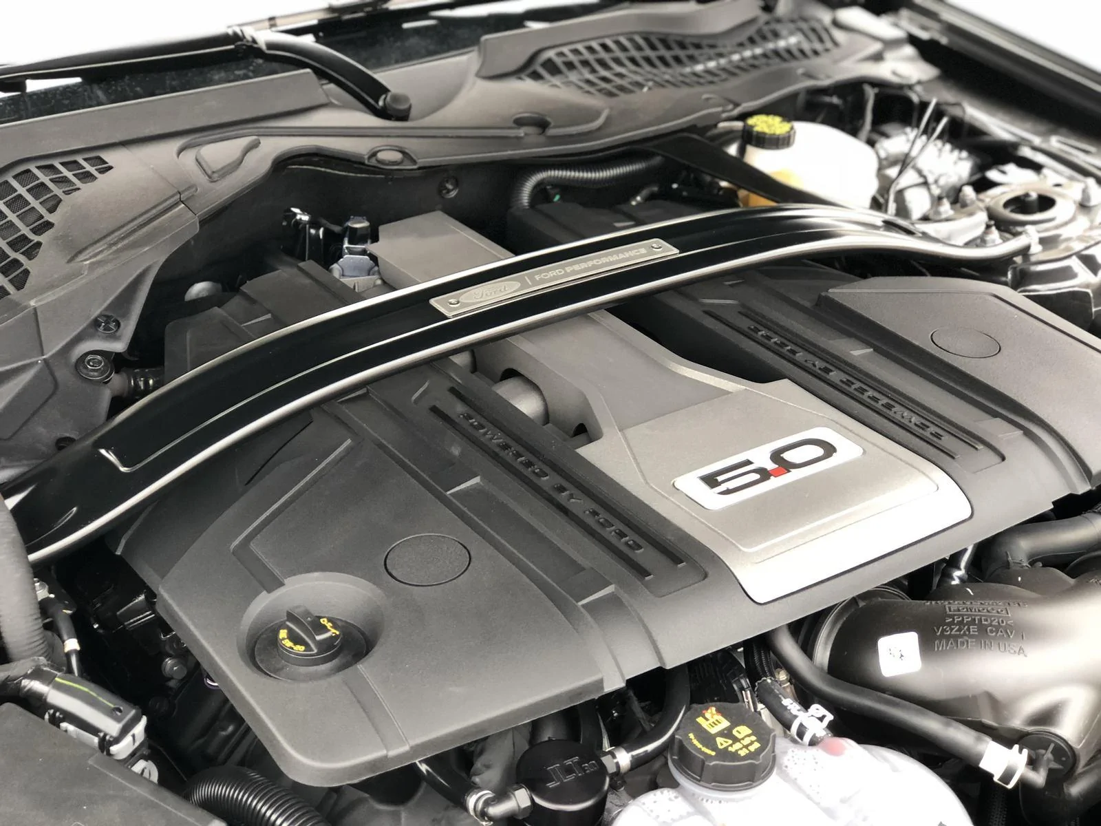

Installed the Ford Performance strut/cowl brace on my 2018 non-pp. super easy 30min install!!
Do you know if you can remove the engine cover with the bar on without the rear part scraping on the bar? I know it was pretty close with the 2015-17 engine cover.

Just installed all three of these parts doing. I got the firewall brace on without taking off the windshield wipers, but getting it in there was an exercise in patience, then getting the bolts in and tightened was it’s own separate exercise. I couldn’t get the wiper arm off without a tool so I had to accept my fate of patience.
Everything looks good. The cowl brace anchors to the firewall brace with three bolts. You’re gonna need extra beyond what is already on the car, 7 in total, but like someone said 4 are already on the car. Took an hour altogether.
