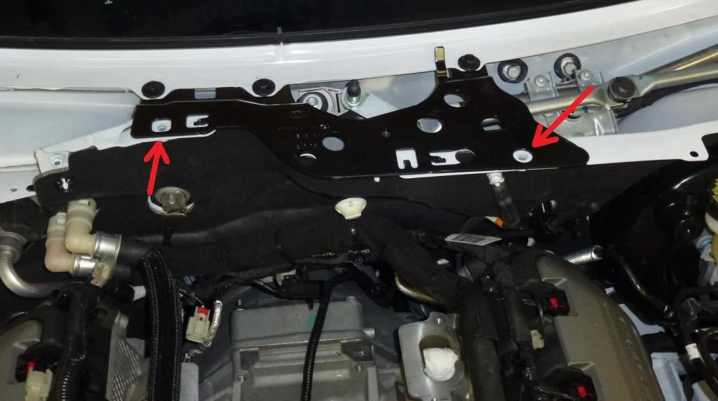

1.) Regarding the picture below, which 908ssp originally posted, are the two threaded holes, highlighted with red arrows, the intended point of attachment for the K-brace?
2.) If so, does the K-brace mount above the pictured firewall bracket, sandwiched in between the firewall bracket and the sheet metal, or directly below the sheet metal? I'm almost certain that it goes below the sheet metal (From top to bottom: firewall bracket, sheet metal, K-Brace) but I just wanted to verify.
3.) I assume to install the 3 bolts of the firewall bracket, one would likely have to remove the windshield wipers. True or not? I have read that many of you have not removed it in its entirety to install the K-brace, however, the bolts of the firewall bracket are set further back than those of the K-brace, thus making install more difficult.
4.) Has anyone taken a picture of all 3 parts installed and exposed (without the windshield wiper shroud blocking the view) ?

You can do the K-brace without taking off the wipers, but no way to get the pictured bracket in without removing them.
I installed mine a few months ago. Just get a gear puller and the wiper arms come off in 2.3 seconds. Easy, breezy, beautiful, CoverGirl

There are instructions for doing it without pulling the wipers. I cannot see your pictures at work sorry but assume it is the standard K brace. Look around CJ Pony parts or AM has the way to do it.

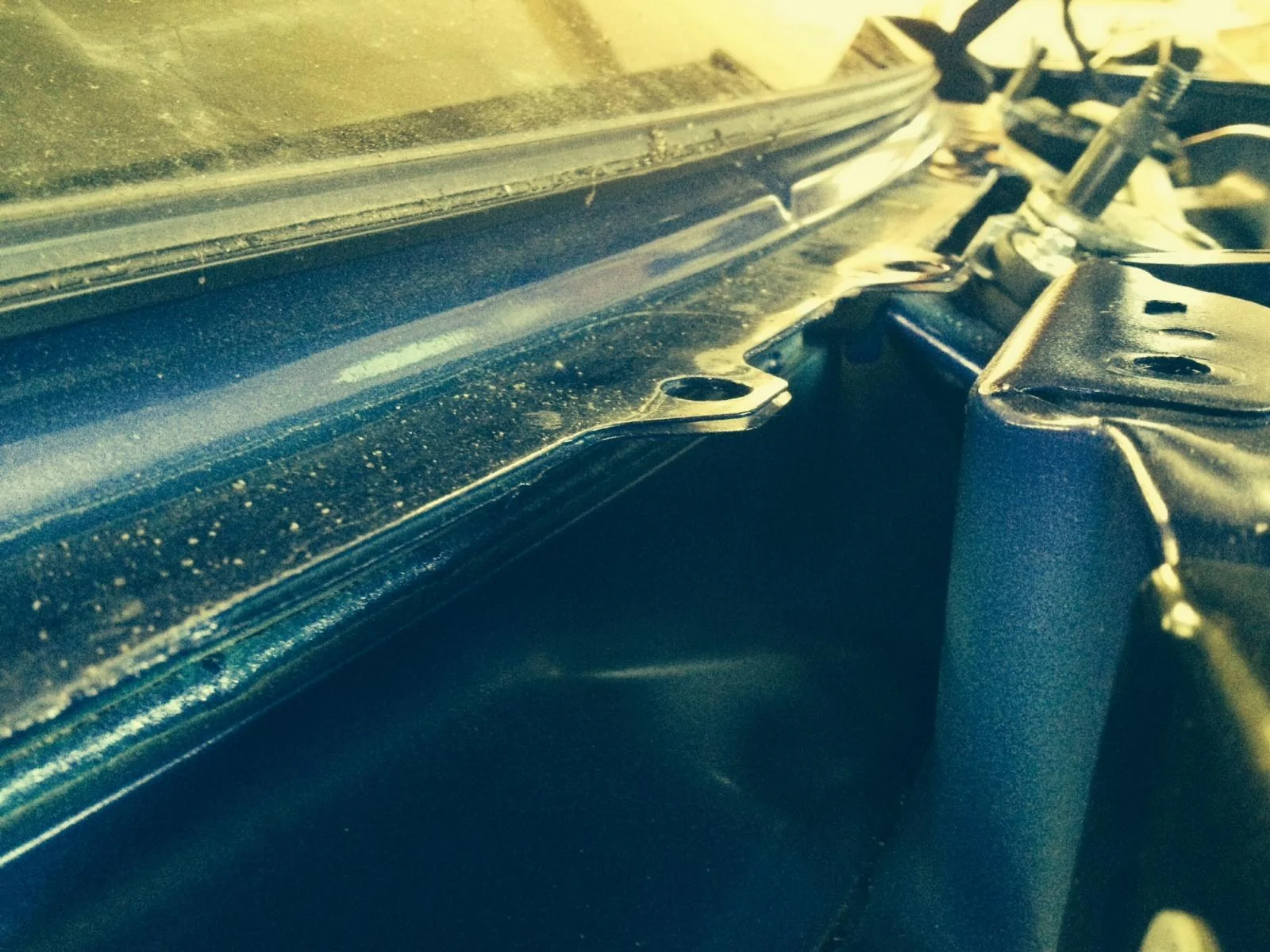

I pulled the wiper arms off because I am also installing the smaller firewall connector brace. Not to mention it's a breeze to remove the wiper arms (only took about 5 minutes for both with a gear puller). Also, I'm not sure how people are fitting a torque wrench under the plastic shroud. Without taking off the wiper arms and then the shroud, It seems highly unlikely that someone could fit a torque wrench under that space.
Also, I noticed before installing the firewall brace that the insert holes are splayed/split on the front lip/leading edge as shown below. Does anyone know why that is so?

LESS WEIGHT---those tabs are separated by the seam sealer at the factory, no problem.
