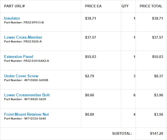

Someone please verify the info in this table, trying to create a central spot where all of the parts and #s are located so we can stop re-asking questions.
This excludes the $179 (going price on ebay) the upper strut tower brace/cowl brace kit from Ford Racing (which includes hardware). These are the parts needed to add the cowl firewall bracket (extension panel and 4 front mount retainer nuts), and the GT PP lower K-brace and plastic shield with oil filter access panel (insulator, lower cross-member, lower crossmember bolts, under cover screws).

I ordered all of the parts in my screenshot plus the FP STB/cowl brace kit. Guess I'll do the install on all of it next weekend. $344 total. I'll take educational pics.
