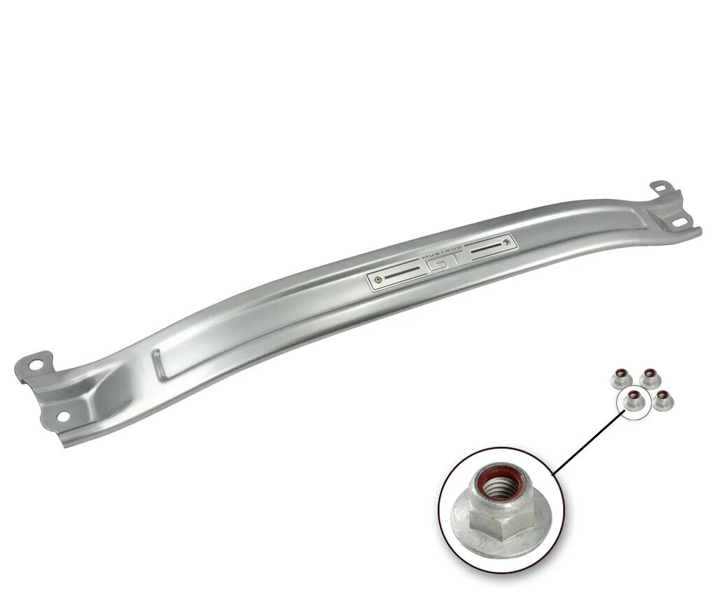

Does the Ford Mustang GT FR3Z-16A200-A Engine Strut Tower Brace come as standard equipment on a 2020 GT Premium (non-Performance Pack) or does it have to be added after-market?

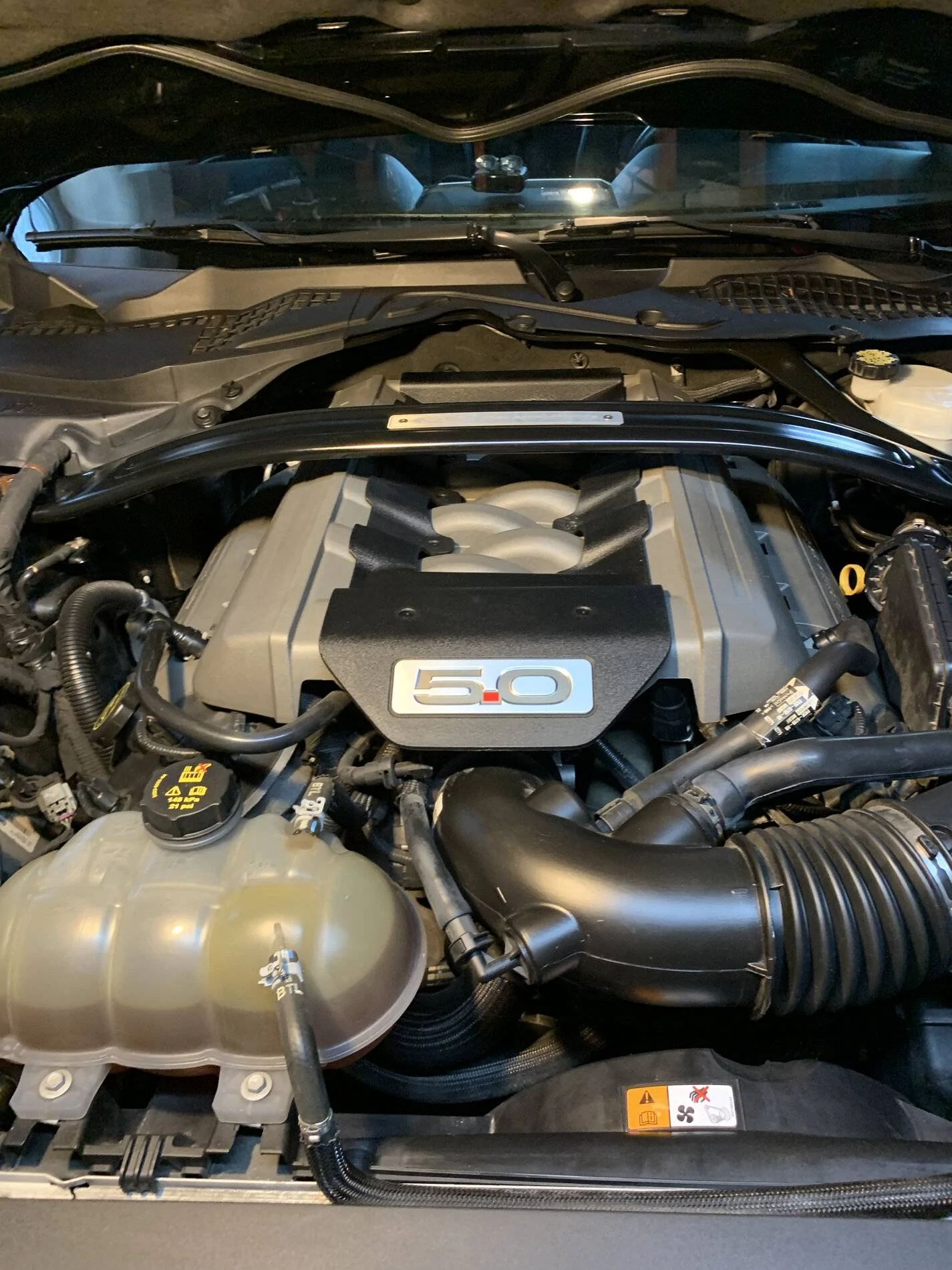

Here’s what I put on
