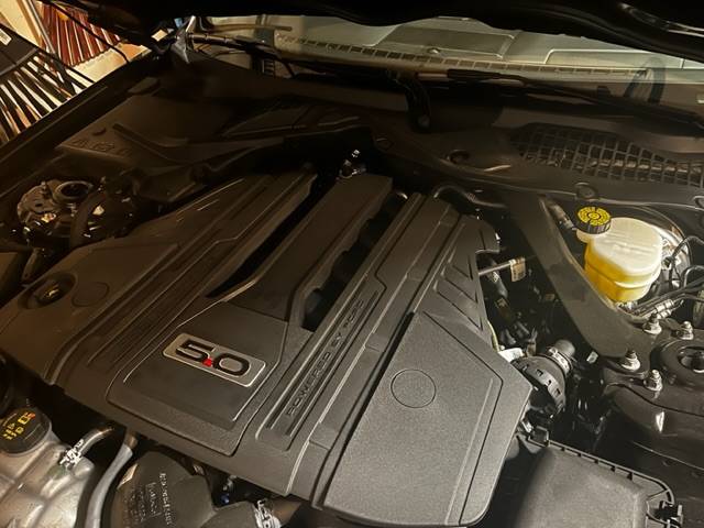

I’ve got a ‘23 non-PP GT Premium with the 20” wheels. Check out the photo attached…
do I have the factory cowl extension brace? Or is this the plastic one people mention? It sure feels like steel to me.
If that is the case and I have the OEM cowl extension tower brace, can I just add a strut tower brace on top of it?

Based on that photo alone, your car looks to be set up the same as a euro GT i.e. it's only missing the tower to tower brace - which is an easy retrofit.
