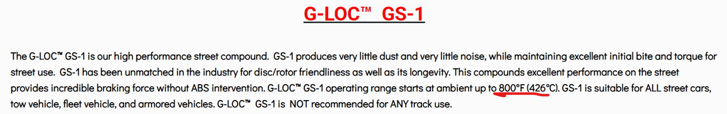

2) GS1 are not recommended by GLOC for the track, so you're going against their explicit instructions and basically asking if running one track pad is better than no track pads, and the answer is that you need two track pads to be safe. One terrible thing can be better than another terrible thing and they can still both be terrible. The R10 would work ok, while the GS1 pad performance drops significantly on the track, so if you try to run very hard, you're basically relying on one pad to not fail. Not very safe.

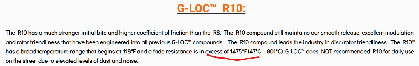

Whatever application you drive your car in, you should expect a certain about of heat to need to be removed in order to stop the car (converting motion to heat). When on track you are removing much more motion, much more frequently. As such, the right pad makes a difference. When you look at the specs for the different pads you can see that they are optimized for a heat range relative to the application they are designed for. In the case of the R10 vs. the GS-1, the R10 can remove at least 675 degF more heat than the GS-1. Dusting and noise are irrelevant, necessary, byproducts. Deviating from the product's intended purpose will only lead to problems. In the case of mixing pads, the GS-1 will have burned to a crisp while the R10 is in its optimum operating range.
