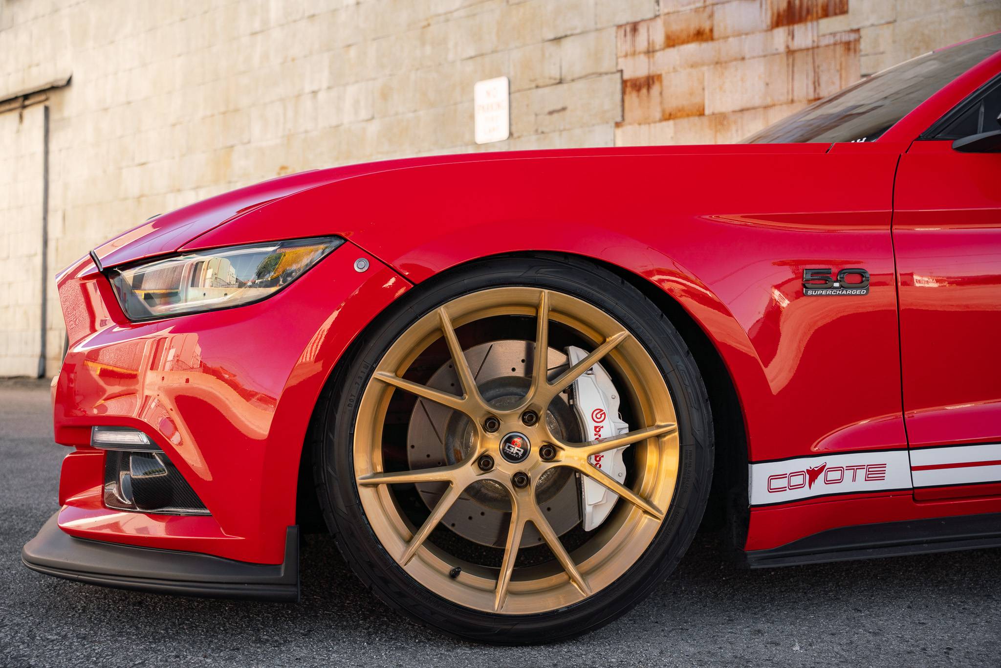

Hey this is Junior from Need4speed Motorsports. On my personal car the factory brake pads that came with the brembos would give off a lot of brake dust it was bad. I swapped them over to the Powerstop Z26 Carbon Ceramic Pads along with their drilled and slotted rotors, performance feels great and they don't dust as much. Would highly recommend that brand or R1 Concepts too. I currently have the R1 concepts rotors on the car. That is what is shown in the picture.
