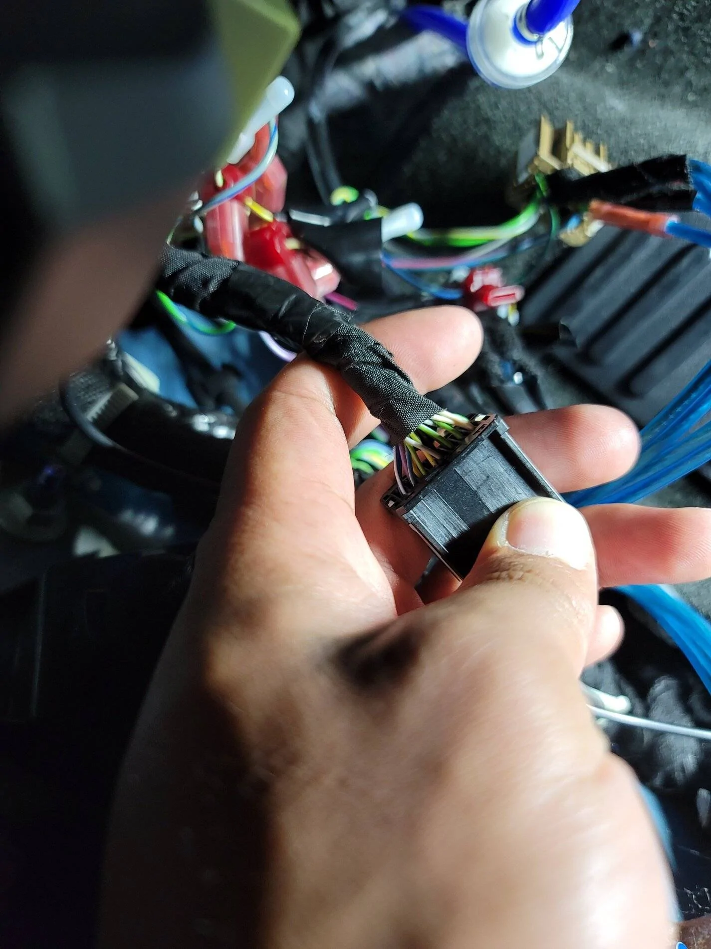

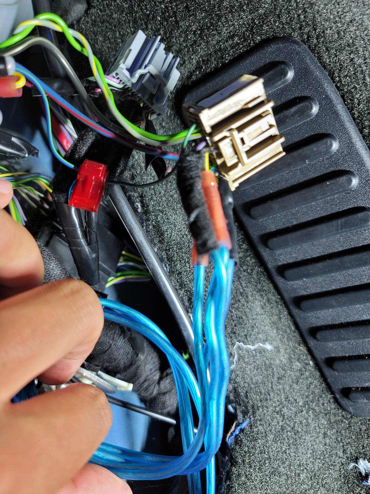

It seems he did some funky wiring off the factory amp original to tap audio signals.

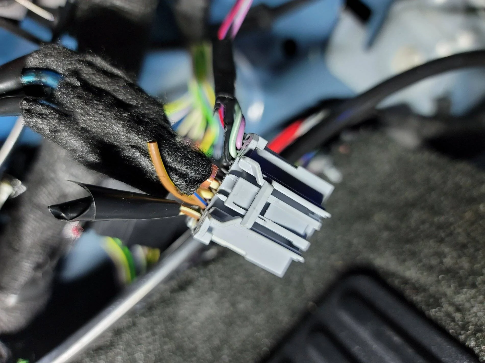

This photo is courtesy of @StangTime so he gets credit.
It appears your current amp was spliced right into the 3.5”/tweeter output plug of your stock amp. Not the best way to do it by far but if he was doing it cheap and easy this is what I’d expect.
An AF03 harness would plug right into this one and the gray plug that runs out to your 6.5” door speakers. The black harness is the amps input from the ACM (head unit).

Oh my goodness.... 1.5 years ago and he still f*cked up your stock wiring while the adapter aFO3 was already available at that time and only cost 40$ and would've been plug'n'play.
I'm sorry, but your installer is not worth the money.
Now you need someone to revert everything back to stock and then use the correct wiring adapter harness.
If he was doing it cheap and easy he definitely would've used the aFO3 harness. Which does not mean that this adapter harness is cheap! It's the single best way to integrate into the Shaker system as you have everything in the plug that you could potentially need, amp turn on wire (although only 6V, but you can use relays, cant you?), constant 12V, ignition, ground, signal wires, speaker wires, you name it.
Splicing into stock wiring is not cheap (in labour and long term costs) and definitely not easier than to just plug some connectors together.
As said above, this installer wasn't worth the money.

You'll just have to very carefully remove all the barnacles he added to your wire harness. Insulate every exposed wire and wrap with Tessa tape. Then you can safely add the AF03 harness.

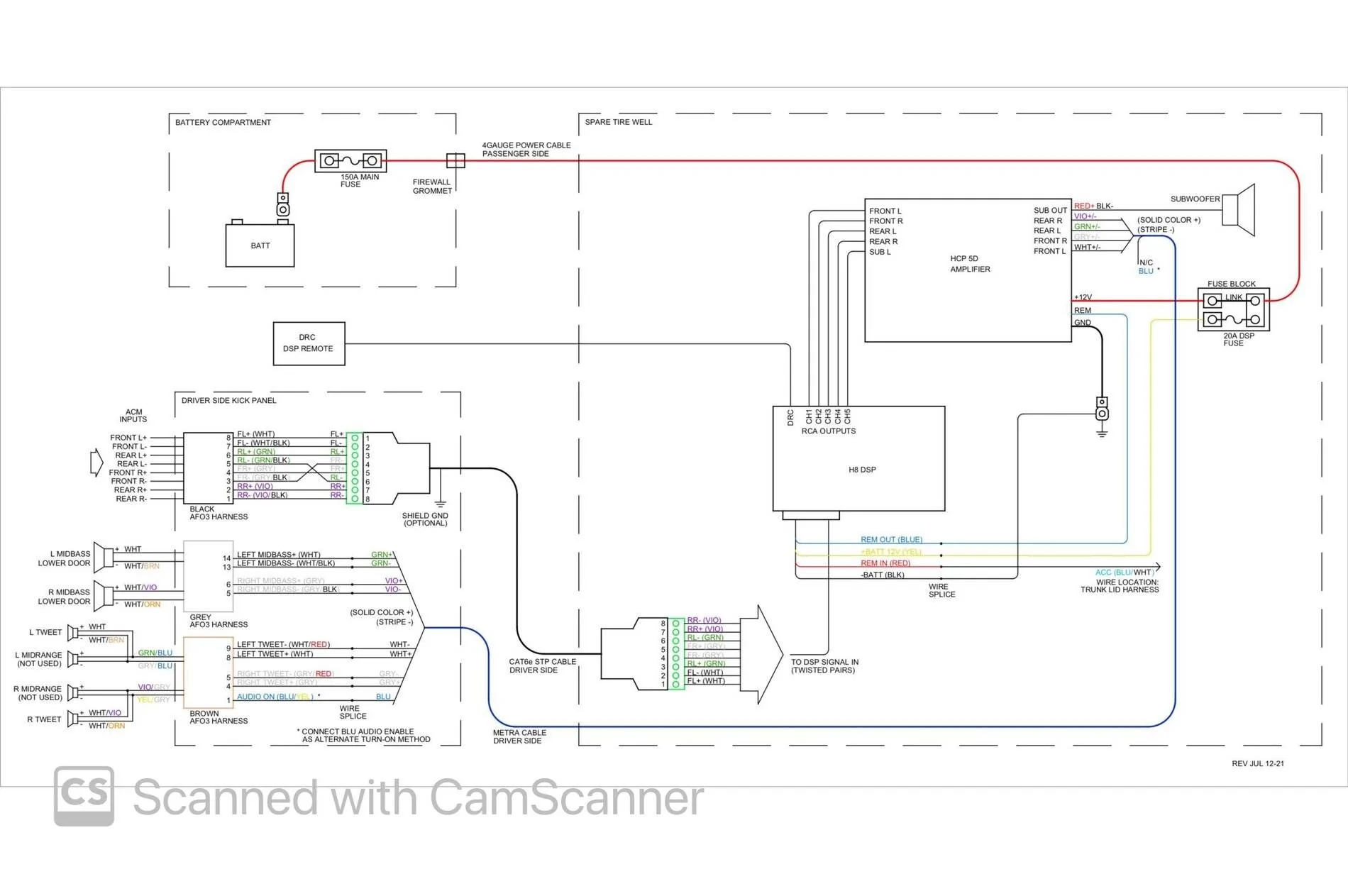

Check out the diagram I shared in post 1222. The brown plug is your 6.5” and 3.5” door speakers. The a-pillar tweeters are wired in parallel with the 3.5”s.
your the man, sorry i read over it and forgot, thank you
