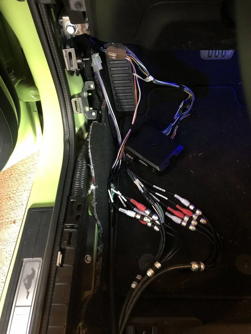

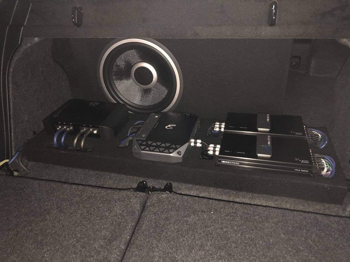

I would have left the stock amp wires uncut (tap into them instead or use a T harness, even better) and used the outputs into the LOC, if you have a quality LOC they can handle 40 volts. There is a bus system that runs in the car that connects your camera, chimes, etc. The LOC can take that input, knock it down and then you can feed another amplifier but still receive the outputs from the ACM. You will have amplified chimes but they will work. That is why I went with the Maestro, it handles those ACM calls and plays the chimes and backup notifications, call sound muting, etc. and you can just adjust the level of them.
Pics of when I did this a few months ago:
