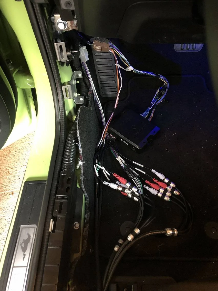

I used the DSR1 and aFO3, pretty much same as you except I bought some speedwire and soldered into the end of the speaker input harness of the aFO3. I ran RCA connections from the DSR1 back to the amps and then used the speedwire back to the aFO3 harness speaker connector.

Here is a couple pics I took before I wrapped everything up.

That looks awesome man thanks for sharing. I picked up another 5 channel kenwood to use instead of the alpine to cover everything. I hope mine come out as clean as that!

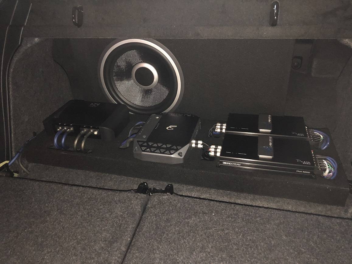

I really like my Audio Designs sub box...way cheaper than stealthbox. Pic during my self install.

Is the audiodesign subbox bolted down to the car, or just pressfit?

I have a single thick bolt going through the center bottom of the box through the frame. It hasn't moved a mm the entire time its been in there (a couple years).
