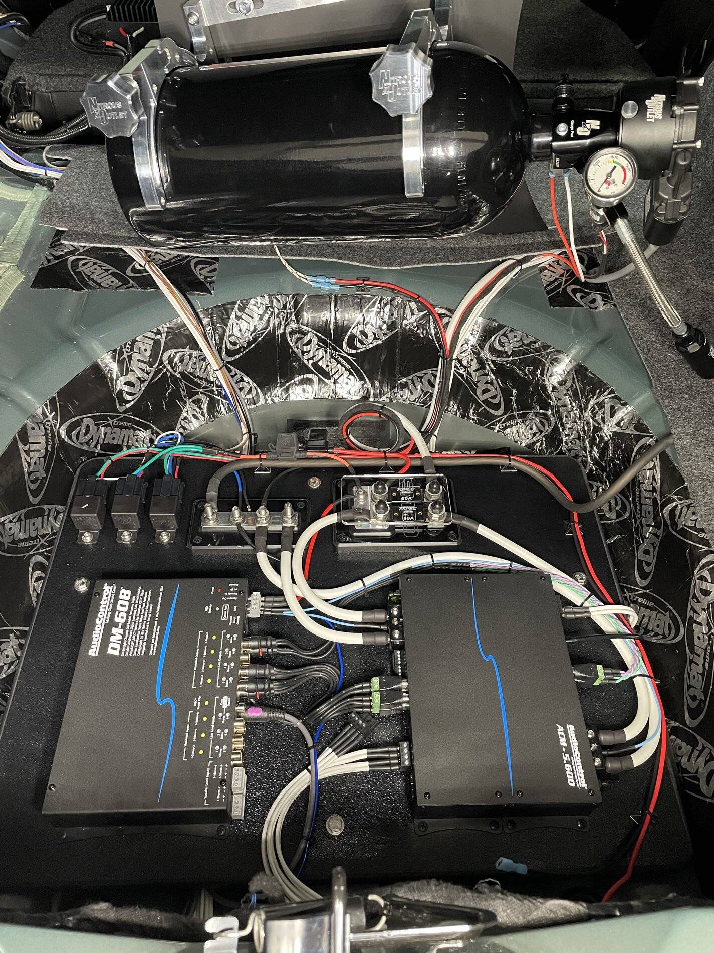

Yes for B&O dedicated am for sub or other.
For my B&O stereo enhancements, I run an AudioControl 1.300 micro amp for my 12” JL Audio Stealthbox, an AudioControl 4.300 micro amp
for my Hertz DSK 165 mid bass woofers in the doors and Hertz 24.3 tweets in the A-pillars. I’m also running an AudioControl DM-608 digital sound processor.

Is that NOS to cool the amps?
Haha! When the nitrous is on, the stereo is off and I’m saying to my car; “give me max speed and power now!” It looks a little confusing back there, but the amp rack actually doubles as a mounting rack for some of the nitrous wiring and relays as well.

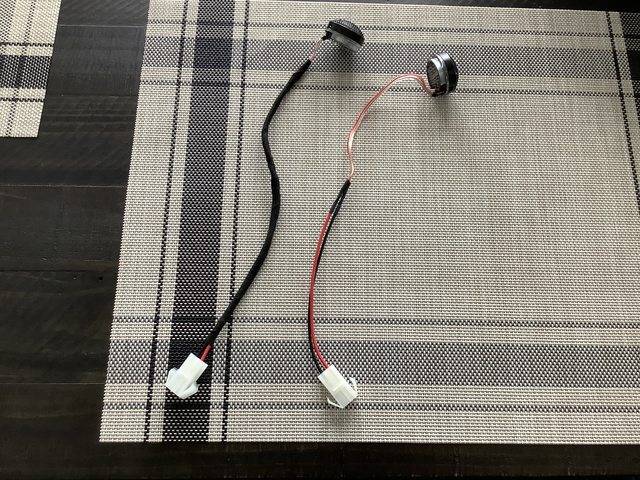

Here is a pic of my Hertz DSK 24.3 tweeters. I installed molex connectors on them to make them plug and play.
