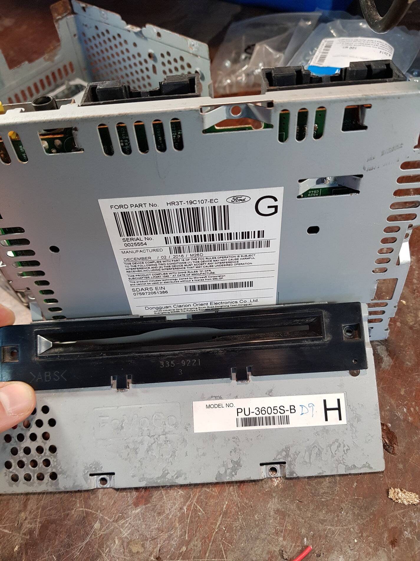

Hello everyone. I will immediately say thanks to the developers of the site, I found a lot of interesting things.
And now about the main thing, I need help. I am from Ukraine I have a 2017 Ford mustang premium with 9 speakers. The audio unit ACM is dead, I ask for advice:
1. what ACM number is suitable for this car (I will attach a photo of my unit below). Asking because its difficalt to faind the same number in my area.
2. Which number to pay attention to for the Ford part number (top) or Model number (front) of the ACM?
3.will Acm fit from another model Ford fusion, focus etc?installed ACM with fusion 2014, asked a friend to programming it for me by vin code, unfortunately I did not receive anything except a new DSP error U0237: 00-0A (short to graund).
I'm looking forward for any advice, I'm sure there are people here who are well versed in this topic. thank you in advance
P.S. sorry for my English(translated something). Probably something not so clear
