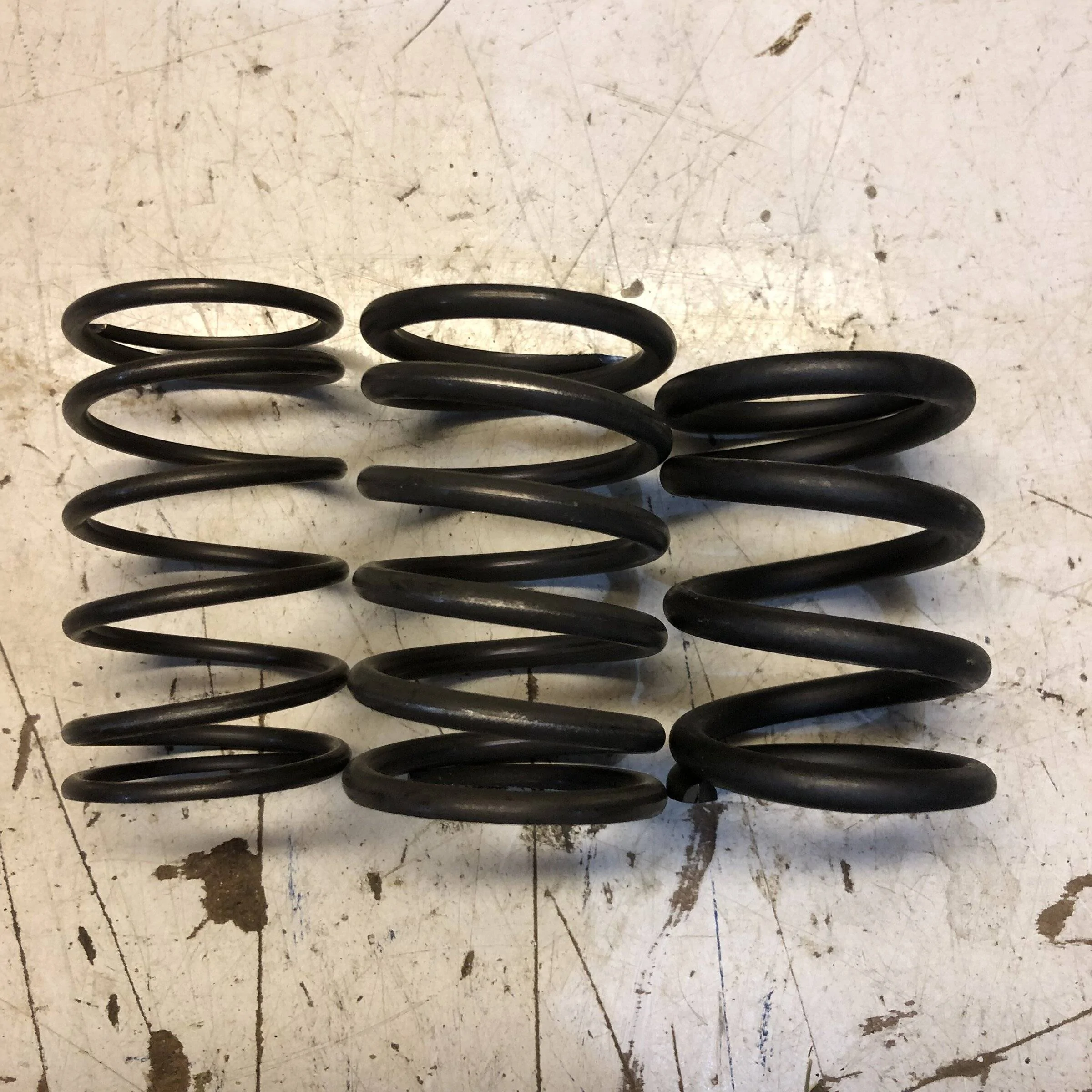

I found a 97 lb spring that should fit and will have it tomorrow to try out. Compromise between the 35 lb Steeda and the 185 lb stock springs. Half the delivered price of the Steeda spring too. McMaster-Carr 9657K573 Compression spring, 2.5" long, 1.687" OD.

It went well! I like the 97 lb spring. More effort to depress the pedal than stock but not as much as the Steeda spring. But also easier to modulate than the stock spring. Will keep this one installed for a longer trial period. Needed the needle nose vice grips to install it but it was still pretty easy. Here's a pic of the three springs side by side, Steeda then McMaster then stock.

The third one is shorter than the other 2, the spring material looks thicker.
