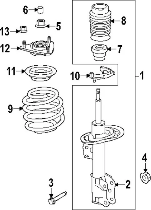

My money is on the camber plates/top mounts. That's some pretty good clunking.

My audio quality is not that great, but I bet it's the camber plates. If the strut shaft nut was loose at any time it can quickly destroy the upper bearing.
Thanks for the feedback. The strut nuts were loose until the recent reinstall. It wouldn't surprise me if that was it.
That will do it, just think of the impact from the looseness.

Honestly I don't understand how that works exactly. Any further explanation would be great. I'm not sure what the function of those bearings ever is.

Was an impact used on strut shaft nut?
I recently had two brand new strut bearings ruined by an impact wielding imbecile who crushed the bearing seat into the ball bearings.
Too me 3 hrs triple checking everything then took newly assembled strut off compressed the spring to discover ruined bearing.
If an impact was used at all it's highly likely parts were damaged.
