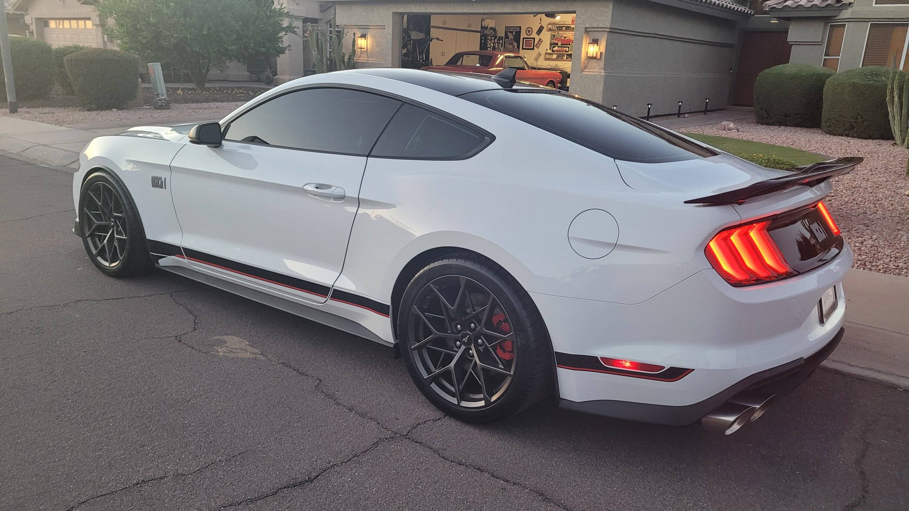

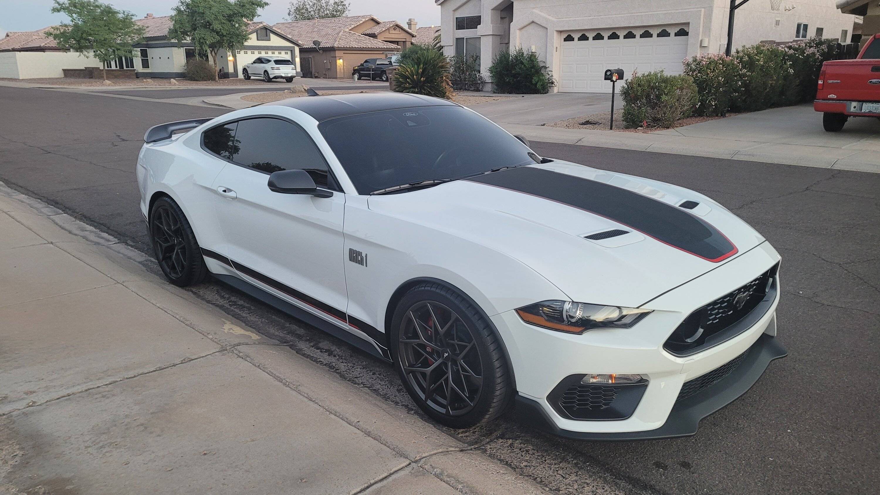

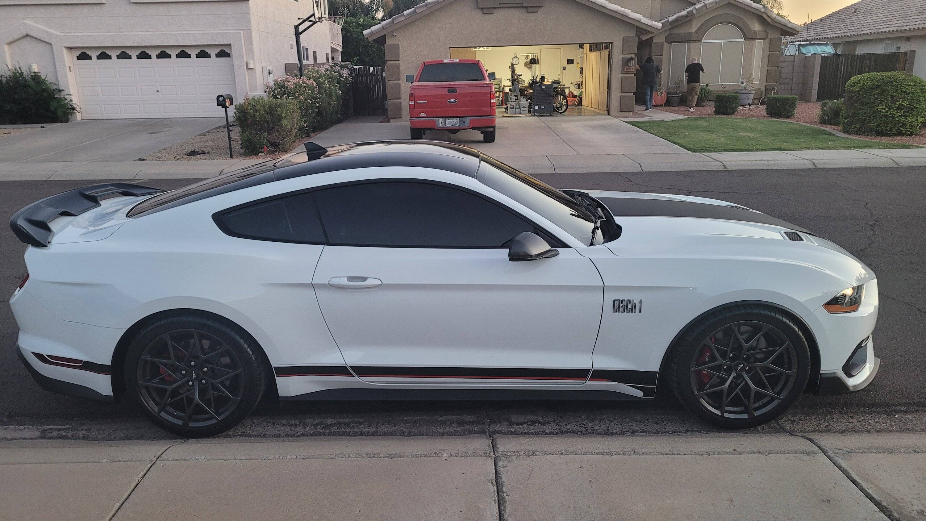

Just to clarify my car has the Steeda sport magneride springs. I'm not super clear on what the difference is between those and the Duel Rate springs. The steeda site does not specify M1 cars in their lowering specs. But I can tell you that I had just barely 4 inches of clearance at the front splitter (before i removed it). My guess is these lower a non HP car close to 1 inch. It does close the wheel gap pretty nicely and I do not have any rubbing issues. All in all its maybe slightly more aggressive than I wound have chosen but it does look and handle very nice.
