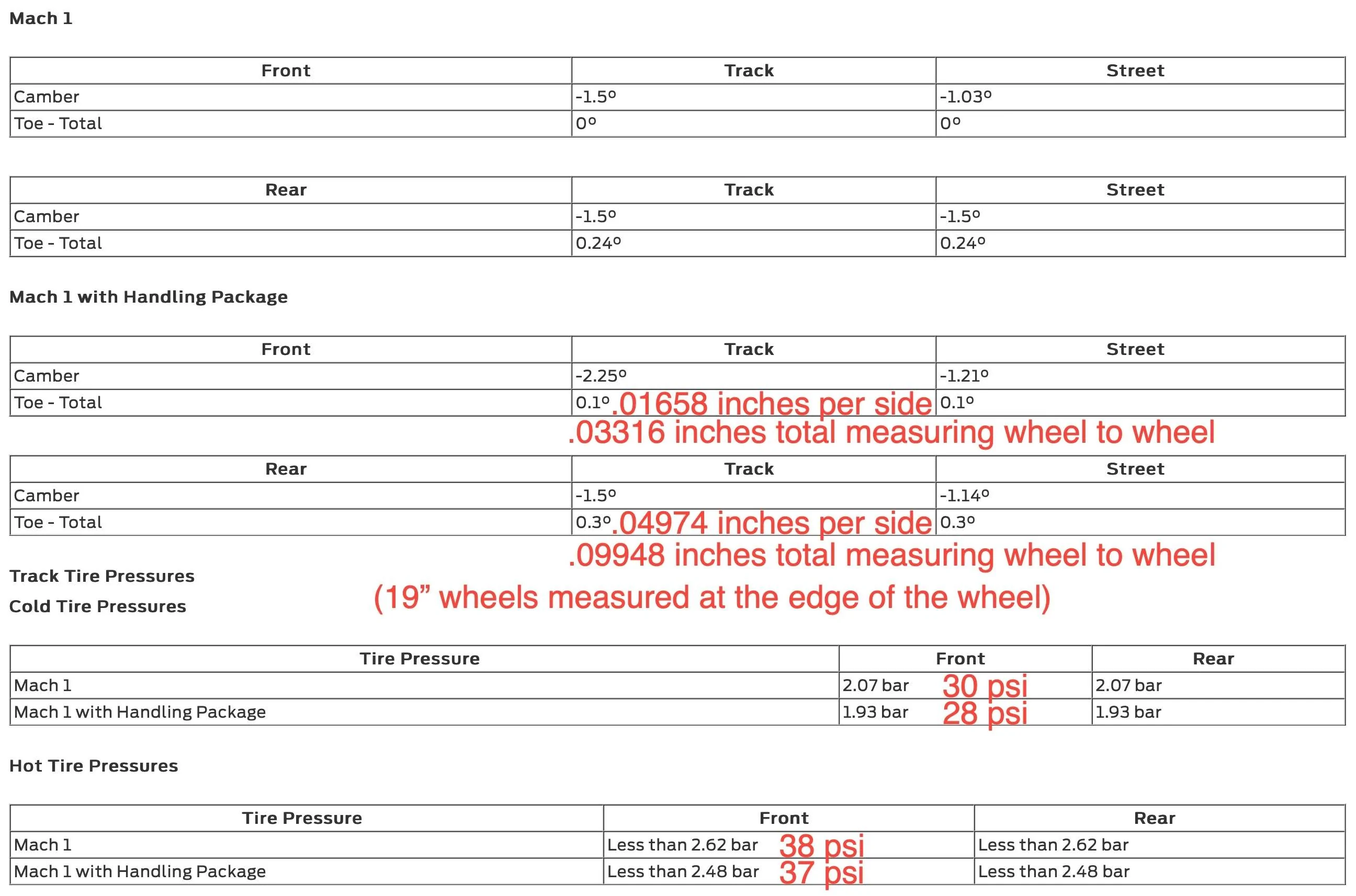

You shouldn't need to change anything if your alignment tech can get it back to stock street specs. I have Steeda Dual Rate springs but it only lower the chassis 1/2". I have front camber plates and rear camber arms from Steeda but track my car and run more camber that you might need.
