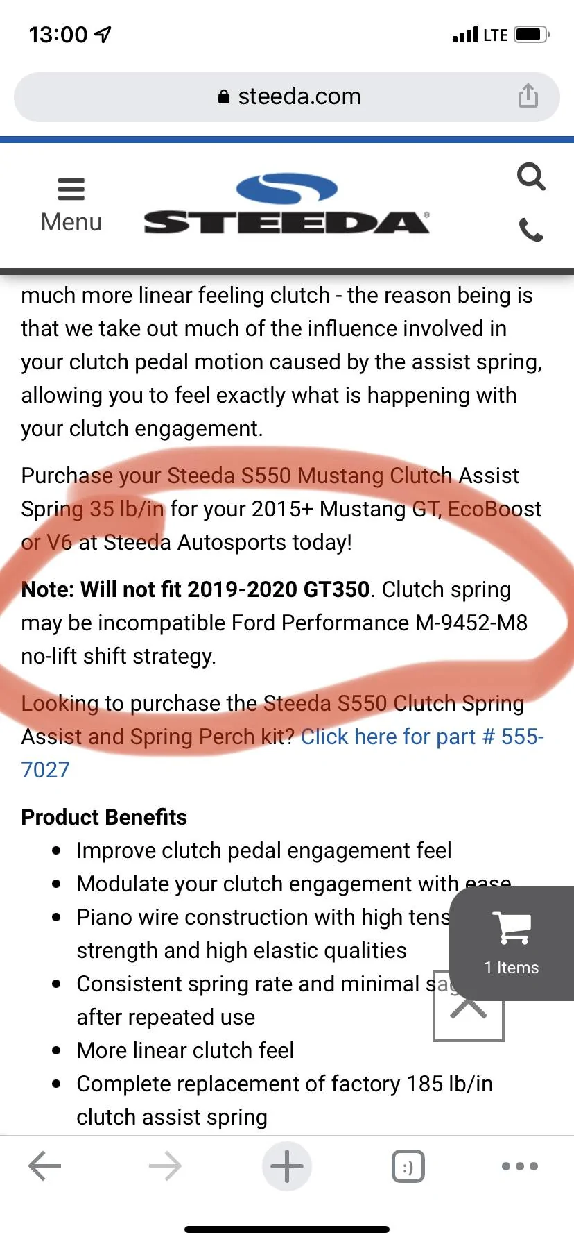

Has anyone done no lift shifts after installing this? See attached and no I’ve not called Steeda but I’ve seen some other listings that say not for Mach 1 due to potential no lift shift strategy issues.

I called Steeda before buying. They advise no issues and have these installed on at least one of their own Mach 1s. Feel free to call and confirm though. Nice folks easy to get hold of

IMO unless they changed the pedal assembly design, it should drop right in. For the low cost I think it's worth a try. It's not an earth shattering difference, but I think it makes the clutch a little easier to modulate.
The 2019 GT350 changed its assembly, its possible the Mach1 uses the same assembly as the 2019+ GT350.

Yeah, I couldn’t see there being an issue with NLS with a Steeda spring/perch installed. Stab the throttle, snatch some gears and don’t let up until you either, win the race or cross the finish line.

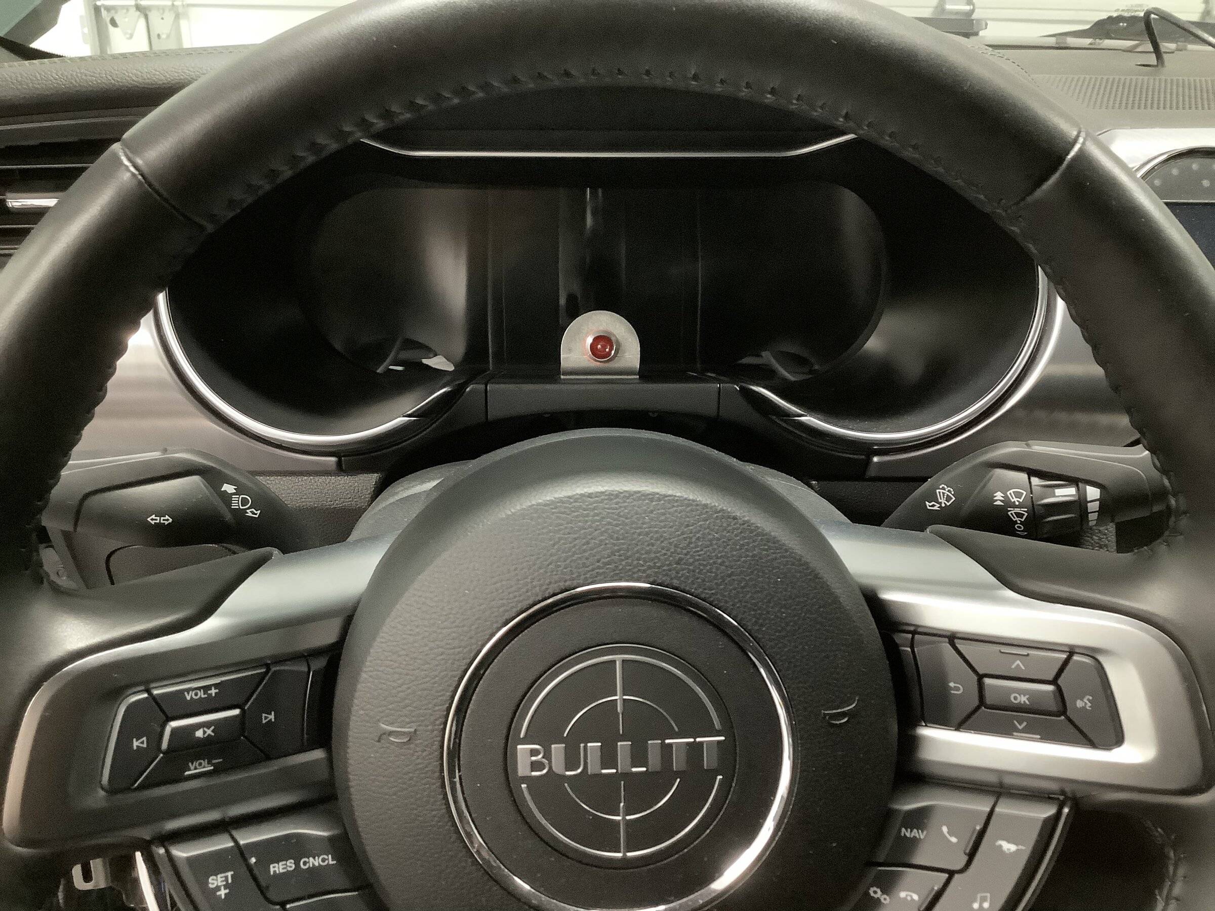

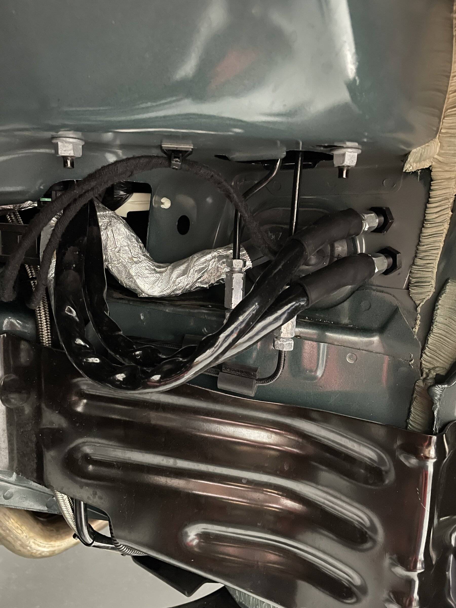

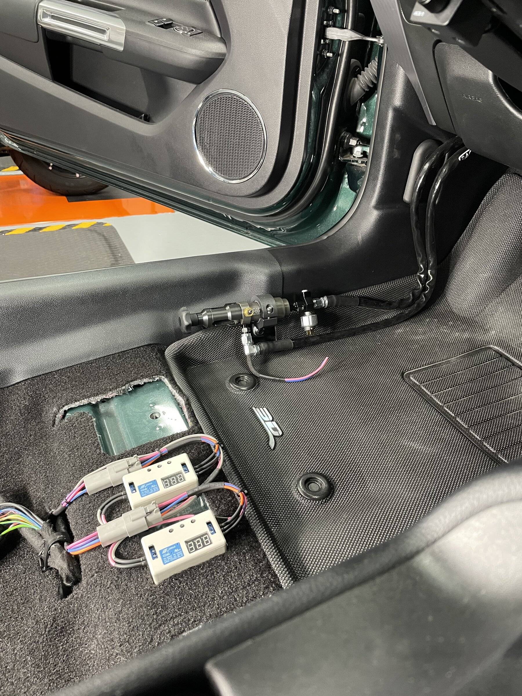

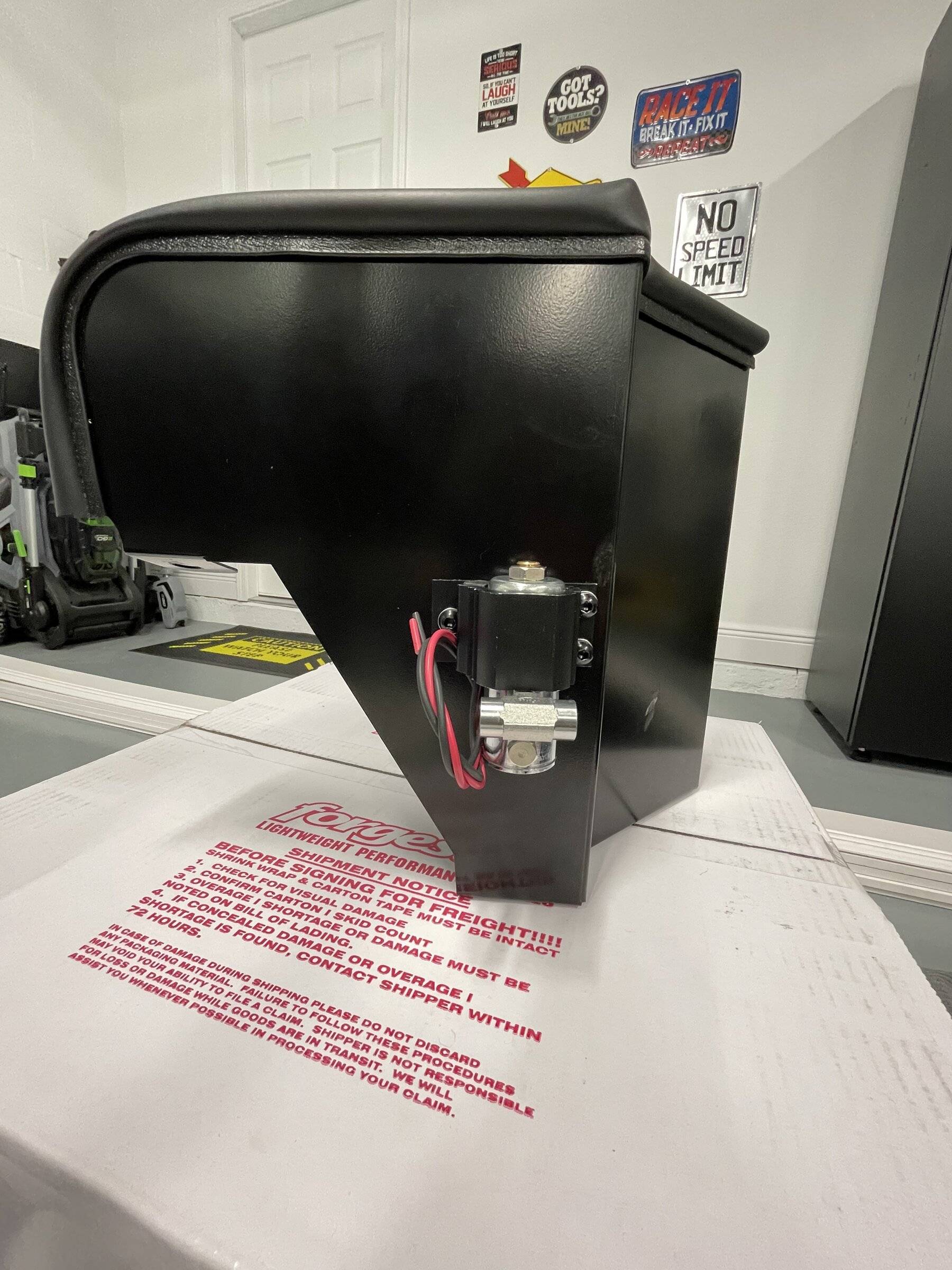

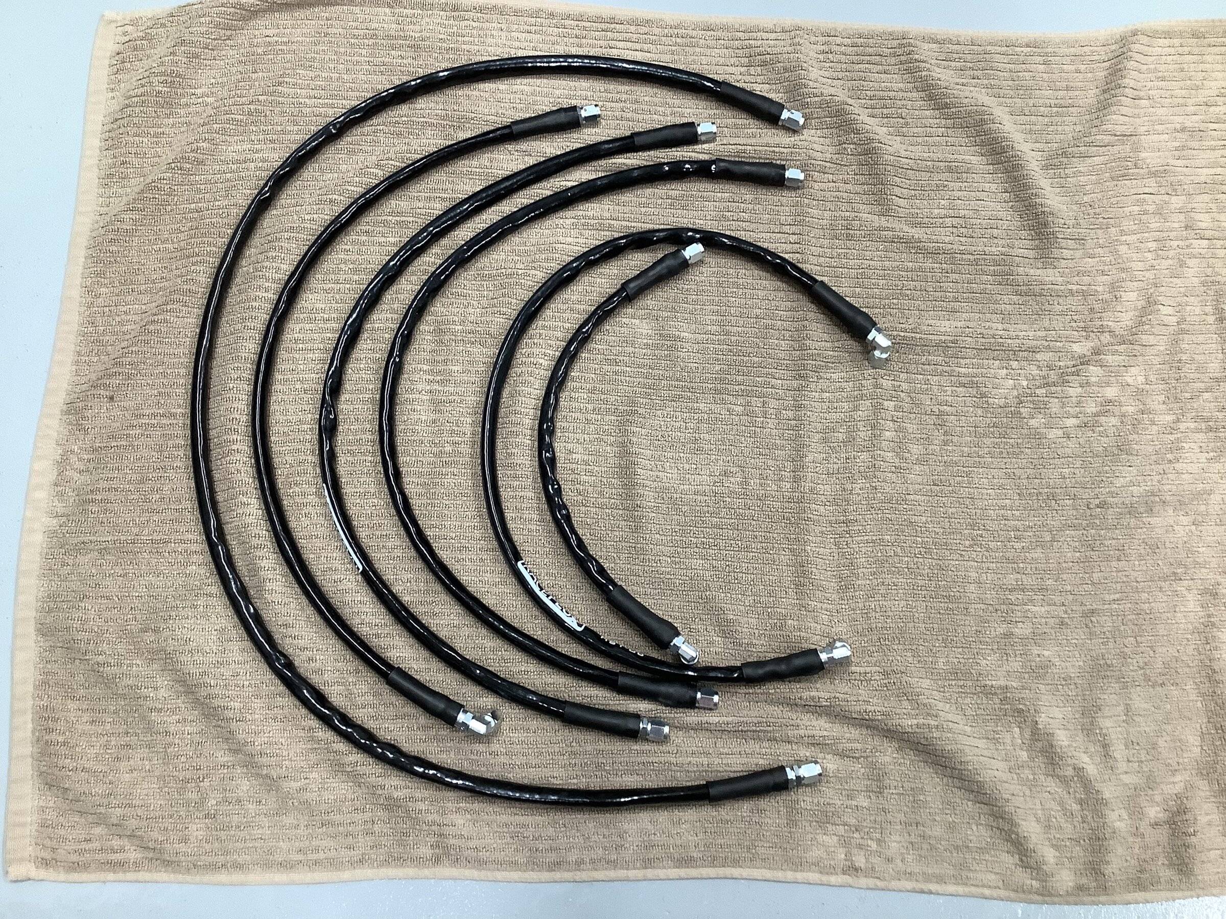

If the spring and perch don’t give you what you’re looking for, take total control of your clutch and dial it in with a Hitmaster Clutch Hit Control System.
Ford could have very easily given the end user the ability to adjust the hydraulic clutch to their liking, but nooooo! Thank God somebody had the foresight to make that option available to me.
