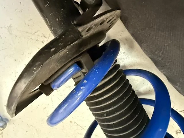

Which insulators are you referring too? Are you talking about where the spring seats at the top? Pictures would be great.

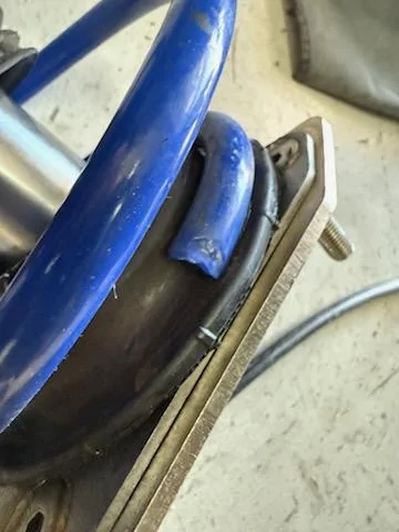

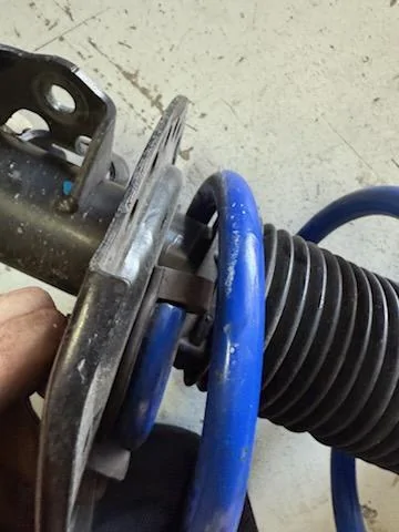

These are pictures the mechanic took this weekend. He said they were clocked wrong and there was some play on one side. But im pretty sure he said the isolators looked fine.
@zero_chance maybe you can speak better to what you found. You had some better pictures and I remember something else was damaged on one side.

Make sure that all the isolators are in place and in good condition. There should be two from the factory, one around the upper spring seat, and one attached to the strut lower spring seat.
Pay close attention to the spring coils for rubbing or contact with each other.
Some springs require wrap type spring coil isolators to prevent these types of noises. This may have been left off the springs during installation.

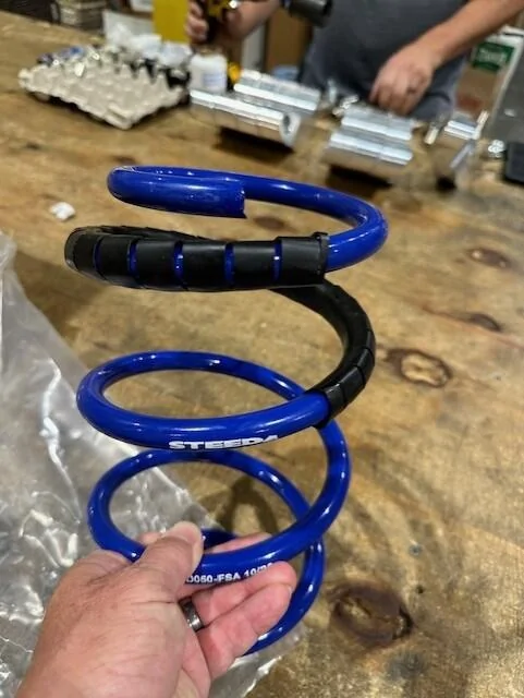

This is the wrap isolator - other options are here: https://www.steeda.com/search-results-page?q=Isolators
I've got the sport progressive springs as well. I messaged you last year about those isolators that wrap around the coils (because the website had them pictured on the sport progressives, but my springs never came with any. When i sent you a pm, you told me that the technical guy at steeda said the sport progressive don't use them.) Which is it I'm wondering now? I haven't installed mine yet and after hearing this I wouldn't mind more confirmation if possible because I'll be paying a shop $$ to do this and want it right the first time. Thank you.
