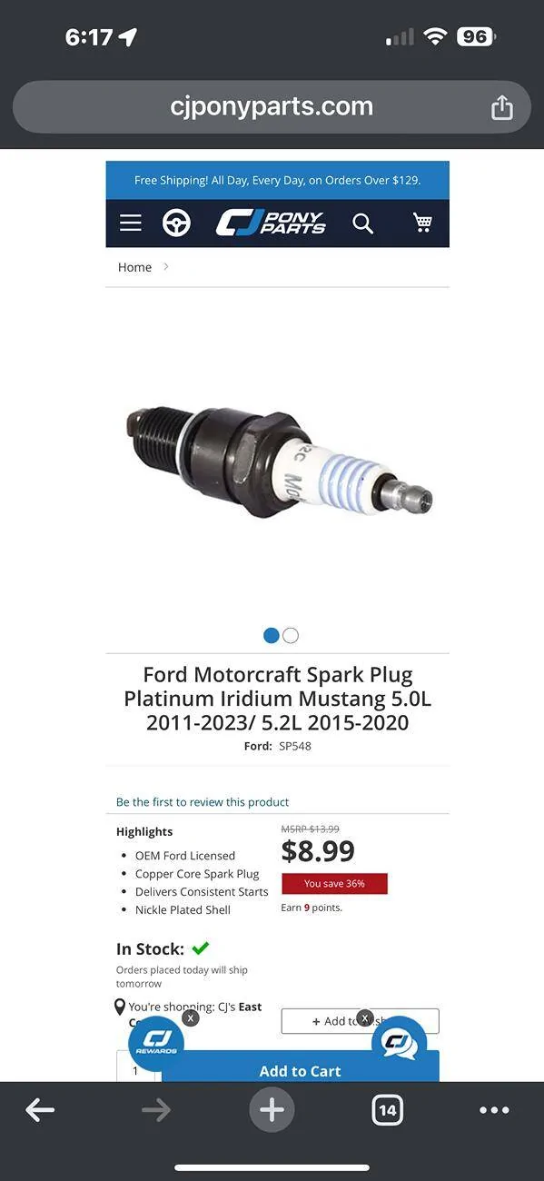

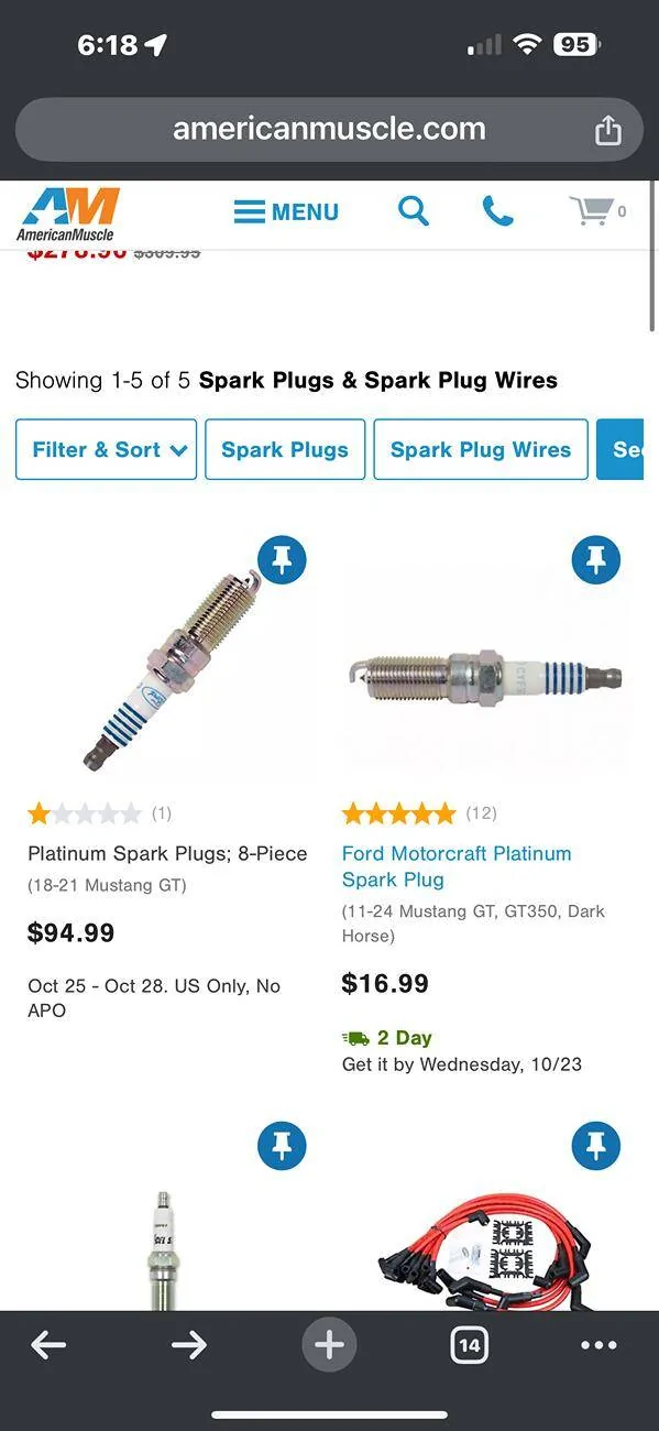

The Motorcraft's are NGK's so it doesn't matter. Although the new Motorcraft part number that supposedly supersedes the old plugs is the wrong heat range for a 2020 (I went through this debacle myself). You want the NGK 94862. LTR7CP13.
Ordering from this website ensures you won't get fakes.

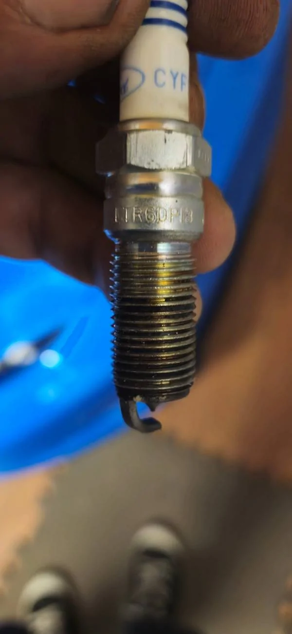

As someone suggested, I'd pull a couple and check them for wear and gap. In a stock engine they should easily last 100k+ miles. As for the coils, why would you replace them? Unless you're getting misfires you can directly relate to them, or they're damaged in some way, you're just spending money needlessly.

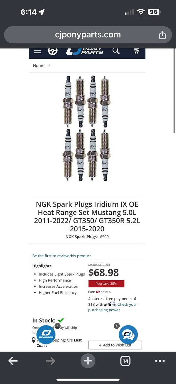

At 39K miles, my OEM plugs were worn anywhere from .054 to .060, so I decided to replace them. Now, granted I track my car and daily drive it so the spark plugs are going to wear faster than the mileage suggests.
I originally went with the 6509 plugs based on the NGK site's parts picker, but then later realized those were 1 heat range hotter than the LTR7CP13 plugs that originally came out of the car from Ford. I went back to the LTR7CP13 plugs and everything has been perfect.
So, I would suggest pulling your plugs, inspecting the gaps and replace with the exact same plugs based on their part numbers/markings. šŸ‘
