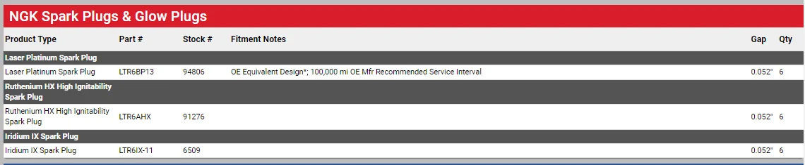

NGK Makes both the Iridium and Ruthenium plugs for you car, as well as the OE equivalant platinum plug

@angelg1674 , if you want to roll with Iridium, just upgrade to the NGK plugs. Be sure to gap them properly.
I think that’s what I’ll do thank you! Only thing is what do I need to gap it to for a 2015 mustang v6 with minor upgrades nothing crazy I don’t have a turbo or anything
