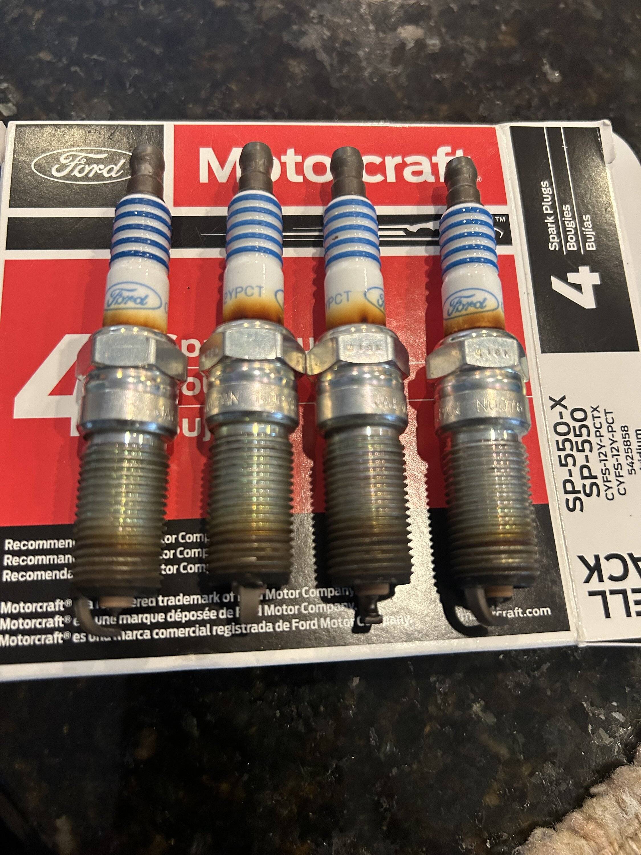

I replaced my spark plugs today, I understand how to read a plug, but I’m not sure why the insulators are scorched, is this normal? 61k on the odometer

What are we looking at? A little bit on the car, please.

2022 ecoboost premium with 61100 mi. I bought the car in January, it has been idling rough when hot.

Are you talking about up top? That's probably from moisture. I assume this is your first plug change at 61k miles? I wouldn't worry about it.

Normal for a turbo car imo. Just did plugs on my brothers Cadillac 2.0T and they looked the same. New plugs had it running right again. Ditch the engine cover if you have one unless you just commute with the car.

Very normal imo. It's some kind of ionization reaction that occurs with the atmosphere over time and leaves that residue.

The condition is called "Corona Stain".
https://ngksparkplugs.com/en/resources/5-things-you-should-know-about-spark-plugs#:~:text=Corona stain is completely normal,seal inside the spark plug.&text=While most NGK spark plugs,off the fine-wire electrodes.
2. Corona stain
Corona stain is a light brown or tan discoloration on the outside of the ceramic insulator above the metal shell/hex. Corona stain is created by the high voltage traveling thru the plug that attracts the dirt or oil particles surrounding the exposed ceramic insulator between the wire/coil boot and spark plug metal shell. Corona stain is completely normal and should not be mistaken for exhaust gas blow-by or a broken seal inside the spark plug.
