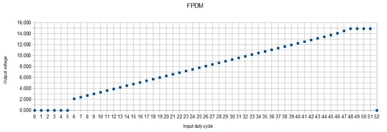

There’s a parameter in the tune for max duty cycle sent to the fpdm. It’s understood that the output to the pump is double this number since the range is 6.5 - 49 in the stock tune. Many, myself included, have increased this to 49.9 or even 50 to try to get a tiny bit more out of the pump. In this particular case, it only requested 49% in the log and the flow was still rising rapidly as the duty cycle ramped up, so we wanted to know if there was more on the table. So, the owner bench tested a stock fpdm and actually learned that the fpdm output hit max at only 48% commanded, and that it loses around .2 volts in all cases. Suffice to say, he’s right at the limit of the pump at 18 psi boost, e85, 55 psi lift pressure, and low 40’s ambient. There’s more available at lower pressure but he’d probably need bigger injectors to allow it.
It is interesting though, that the 22v bap “ez” ramps up voltage all the way to 49% so the 1% between 48 and 49 may not change the fpdm output but it does increase the voltage fed to it.
In this setup, due to current limitations the max bap output is 21.1 volts but only 20.9 is actually delivered to the pump and it only touched it briefly.

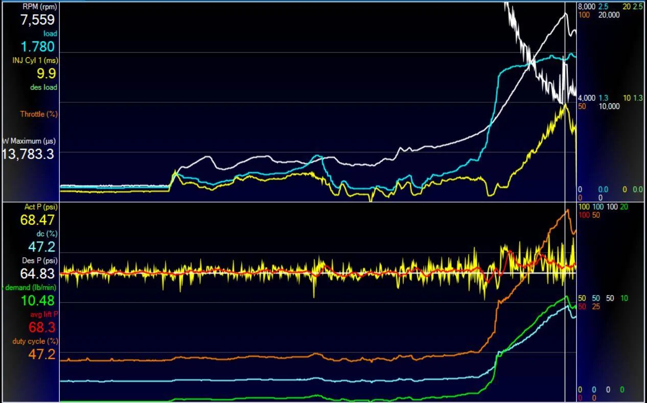

I returned to DW400/BAP tuning, as we came up with a better idea for control. There are two issues with the typical setup and tuning:
1. OEM fuel pressure runs 65 psi most of the time, but attempts to control to 73 psi at 3500+ rpm. However, if you're running a high power system and stock bucket, you can't reach 73 psi at high rpm and load anyway.
2. The OEM uses a feedforward and feedback control, which if tuned improperly can cause pressure oscillation. Then throw in a dynamic switching BAP, like the JMS Fuelmax, and now you have essentially 3 things trying to control pressure which can fight each other.
The JMS Fuelmax can operate at 14.5v and 22v, switching to high voltage a number of different possible triggers. However, most likely the BAP is always generating 22v and using PWM to cut it to 14.5v when in low voltage mode. Then we use the FPDM to control by cutting it down further most of the time but the PCM and FPDM don't know whether the input voltage is 14.5 or 22v. Rather than using multiple means of controlling voltage, why not just run 22v all the time and use one PWM (in the PFDM) to cut it down and control with it? So, this is exactly what I did. I made a jumper to trigger the JMS Fuelmax to run 22v constantly, then retuned the feedforward table to control pressure at this higher, constant input voltage. I also set it up to run 65 psi all the time. Once the feedforward table was calibrated, I turned feedback control back on and it controls beautifully, not to mention I was able to delete the pedal position intercept harness.
I'm very happy with the result, the simiplification of the system, and the improvement in control. Also, I checked temps of the BAP and FPDM and neither are building up much heat at all.
If anyone is interesting in replicating this setup, I'd be happy to share the tuning parameters and details on the BAP high-output trigger jumper and settings.
