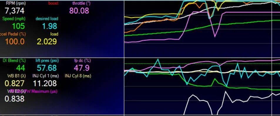

Another update on this now that we had some cooler weather. This log was taken in the low 40's ambient, again, Whipple 3.0" pulley and E85. And to say that traction was sketchy would be an understatement. The DW400 is still hangin in there and still didn't hit max FPDM duty cycle:
It's actually running up against the max duty cycle of the DW95s, which according to the injector data are within 2% of id1050's. Basically, it appears as though the DW400 can supply enough fuel to max out the 1050's at 55 psi. This car has the stock GDI pump as well, though the tune was tweaked to get more DI blend out of it.
