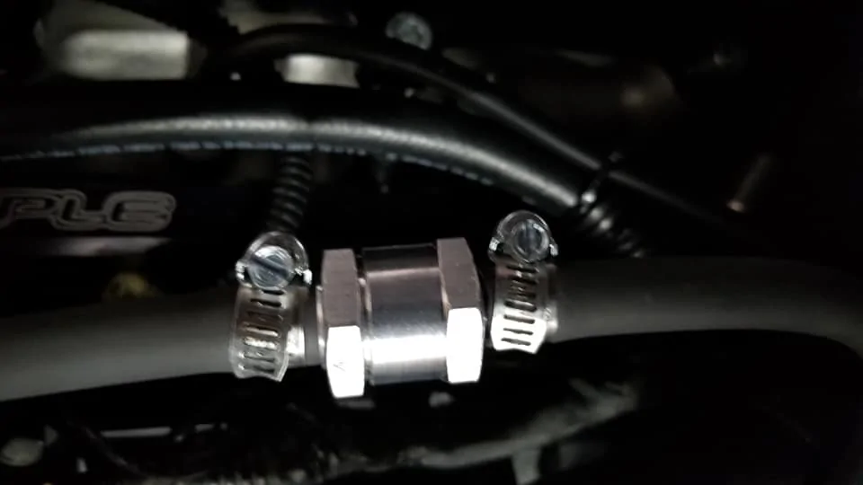

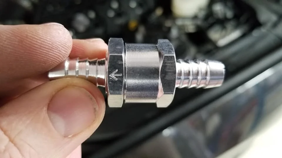

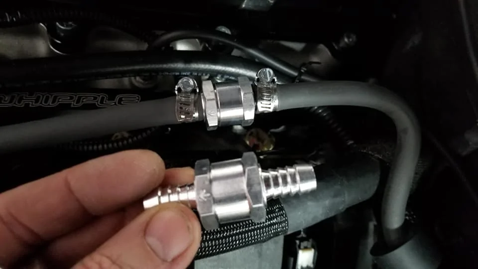

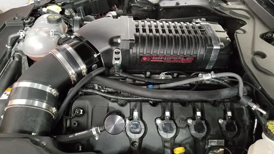

I installed a DW-400 to my Whipple 2.9 2016 GT Auto. Also running ID-1000 injectors, VMP 40A (18V constant) fuel pump booster. Lund said they had customer complaints of hard starting with the DW-400 as it does not have a check valve like the stock pump has. So, I invested a whopping $4.95 at www.anfittingsdirect.com & 5 minutes of my time to install an E-85 rated 1-way check valve. (8mm barb fittings) I've let my car sit for 7-10 days without starting it...and it fires up like it's stock. So...no hard starting issue.
I am going to give this a try... running 93... I will let you know if this works for me...
