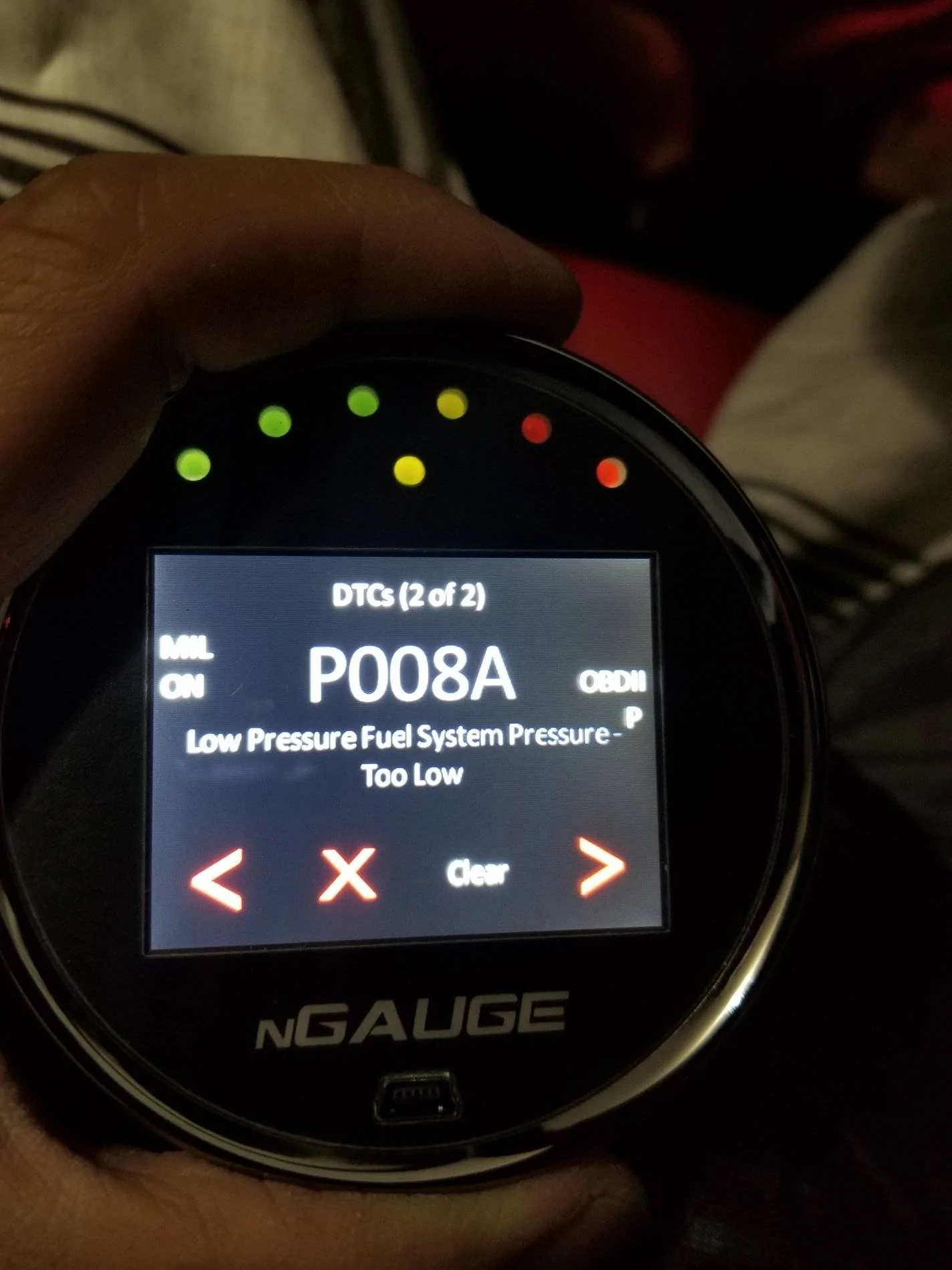

I have some problems with my DW400 with BAP
(the pump have the check valve). I installed the pump and when I try to pass 3000 rpm the car present the error P008 low fue pressure, I remove the pump and use the stock pump with the BAP and problem solve. Another issues is when the car have only 50 miles for empty automatic the car loss power and blow out automatically. In others words you dont have reserve of fuel. This is my experience with DW400 (PD Customer Services of Deachwerk its excellent).My fuel combination its DW95 injectors,fore fuel rails,VmP bap and now the stock pump.

Damn did you ever figure out what caused this?
I hope I dont have this issue because I plan on going dw400 with a BAP.
I'm running the dw400 with a bap, its marginally better then the stock pump with a bap on my car. I think the restrictions are the factory regulator, fuel line and rails at that point.
