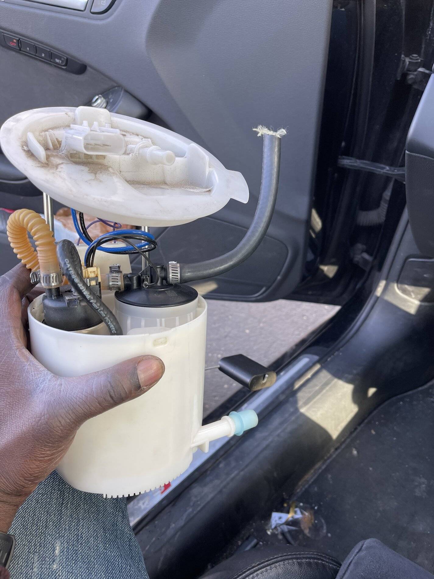

Do you have the black rubber hose ?
Here is what happened to mine when I was running the single DW400 and BAP
