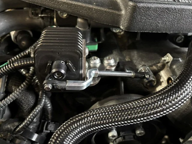

I can't say enough good things about drivability now that it's installed. I'd say the servo starts moving at about 20% throttle and reaches full close at about 80% throttle. That controlled progression makes for a fantastic driving experience, offering partial closure during those daily drive moments. The car no longer feels dead out of boost, and feels almost linear like a NA car.

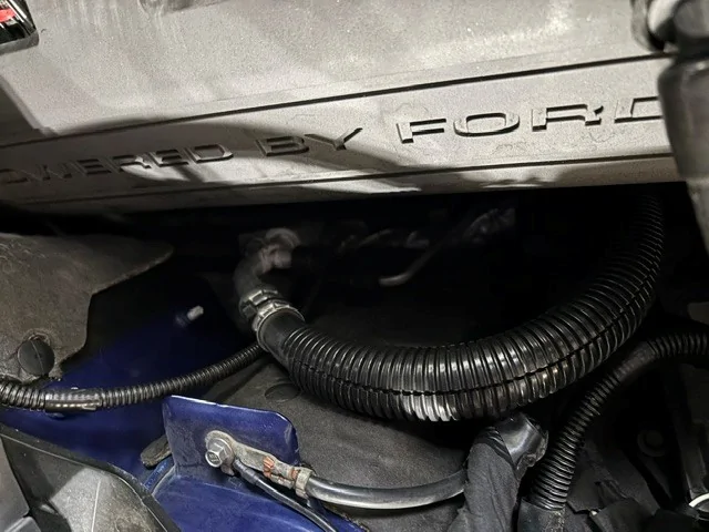

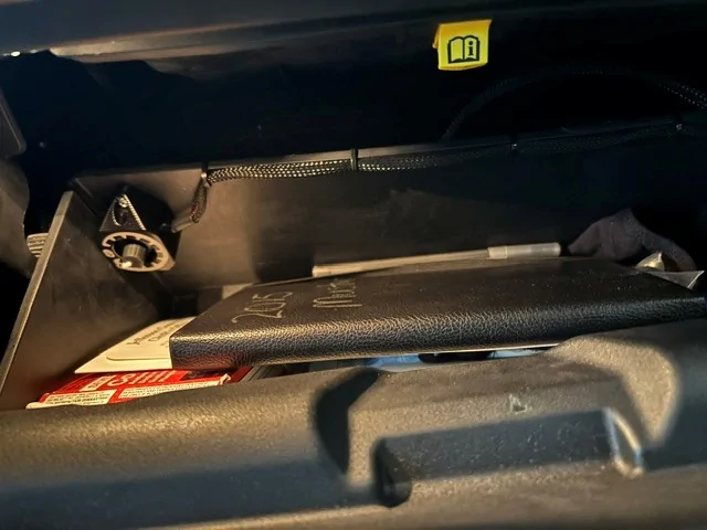

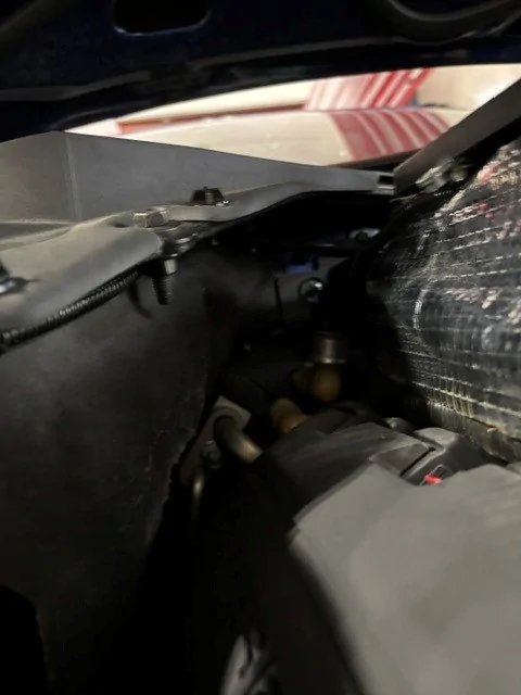

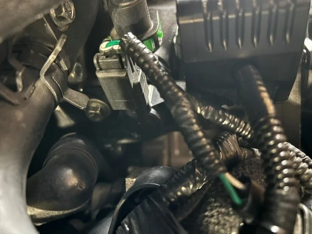

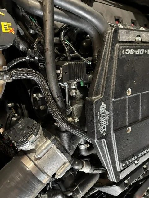

Not gonna lie, install wasn't the easiest. The wiring itself is fairly straight forward. I de-pinned the engine bay harness and ran it through the passenger fender grommet that I and everybody else use to run the amp power wire. If you opt for the plug and play harness, you simply connect the throttle tie-in at the accelerator pedal like it's a factory connection. I mounted the control unit out of sight on the passenger side behind the radio stack, and ran a 5A fuse tap for 12V and grounded with a bolt at the factory fuse box. I also opted for the boost control knob and mounted it in the glovebox. In retrospect that was silly, and there are wiring combinations to ground on the harness where you can disable movement if you're in snowy conditions with a simple toggle switch.

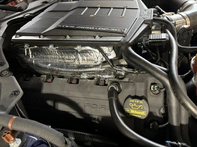

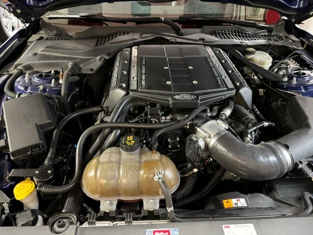

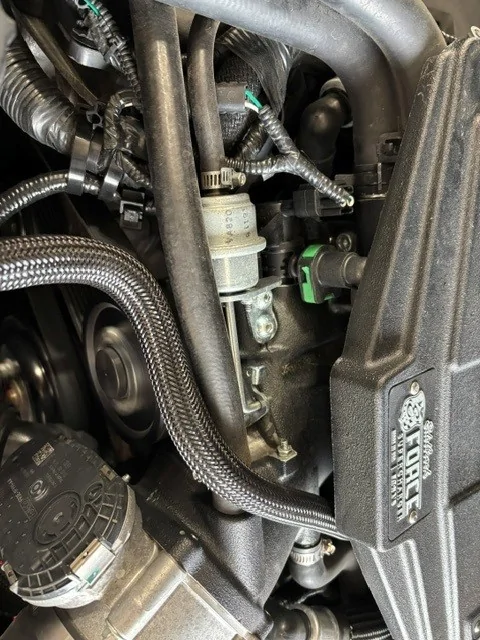

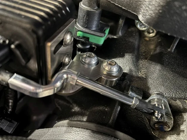

The difficulty was actually in attaching the servo motor itself. I'm not sure how Roush, Whipple etc. mount the Evap valve, but on the e-force it's right underneath the vacuum cannister mount. There's no physical way to mount the servo as shipped (with an e-force specific bracket) where the arm isn't at a ridiculous angle that I didn't feel comfortable with or the servo interferes with the top of the valve. I ended up using 1/2" stainless spacers and extended bolts to mount the servo higher, which in turn required me to adjust the throw of the arm while my wife floored the pedal. If you get one, do yourself a favor and remove the cover plate before you mount the servo. The arm throw adjustment is literally loosening a bolt and extending the lever arm position, but removing the cover is a size 0 Phillips, and it's hard to get to when mounted.
Hope this helps somebody in their search. I'll throw some pictures of the install below so that anybody who wants can see the setup.
