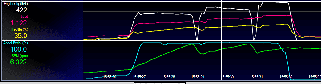

As you can see from this screen shot, at WOT (light blue line) in second gear it is limiting the torque (white line) to ~400 ft lbs. You can see that first gear is lower and third gear is higher. In this data log I had it set to 300 ft lbs in first, 400 ft lbs in second, and 500 ft lbs in third. You can see load (pink), torque (white), and throttle blade percentage (yellow) increase with every gear change corresponding with how I have the torque limits set in the calibration.

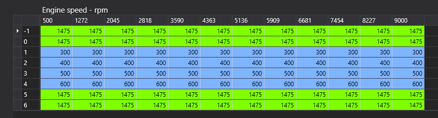

This is nowhere near fully dialed in. Each gear can take more power, and as you can see below it is also based on RPM, so I can really dial this in. This was a guess at how much first gear could take and then an increase with each gear change for testing purposes.
There are several limitations or possible issues that need to be contended with to make this work. For starters, the way the stock Mustang GT (and most all other V8 Mustang calibrations including Whipple) control the throttle blade for WOT operation is very simple. It basically ignores the driver demand table after a certain, calibrate-able, throttle pedal percentage. In order for torque by gear to work, the driver demand for WOT needs to be configured more like an Ecoboost, where it uses the driver demand table at WOT rather than ignoring it. The second limitation is that it only works through 6th gear, which I assume is a left over from either the 6R80 and/or the MT-82. I don't see this as a huge issue, becuase as you can see in the below screen shot I have it maxed out by fifth gear, but I guess some might find this limiting.

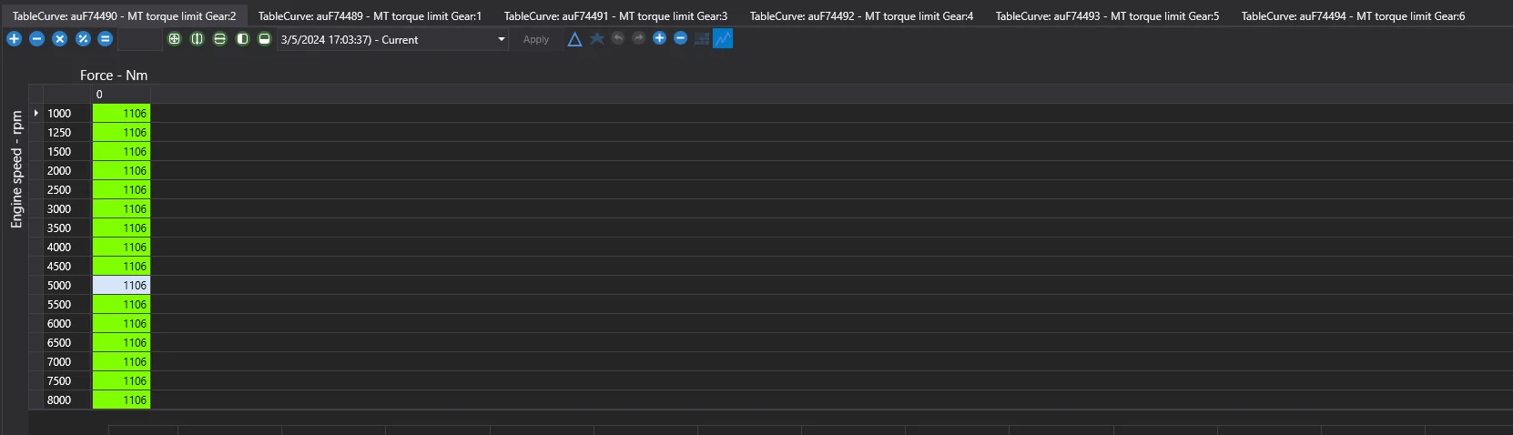

The MT-82 is easier. There is an array of transmission torque truncation tables that just work. For whatever reason, on the Whipple OS, the transmission torque truncation by gear table doesn't work. I have tried it a dozen times.
You can see one of the tables in this screen shot and then tables for each gear along the top.
