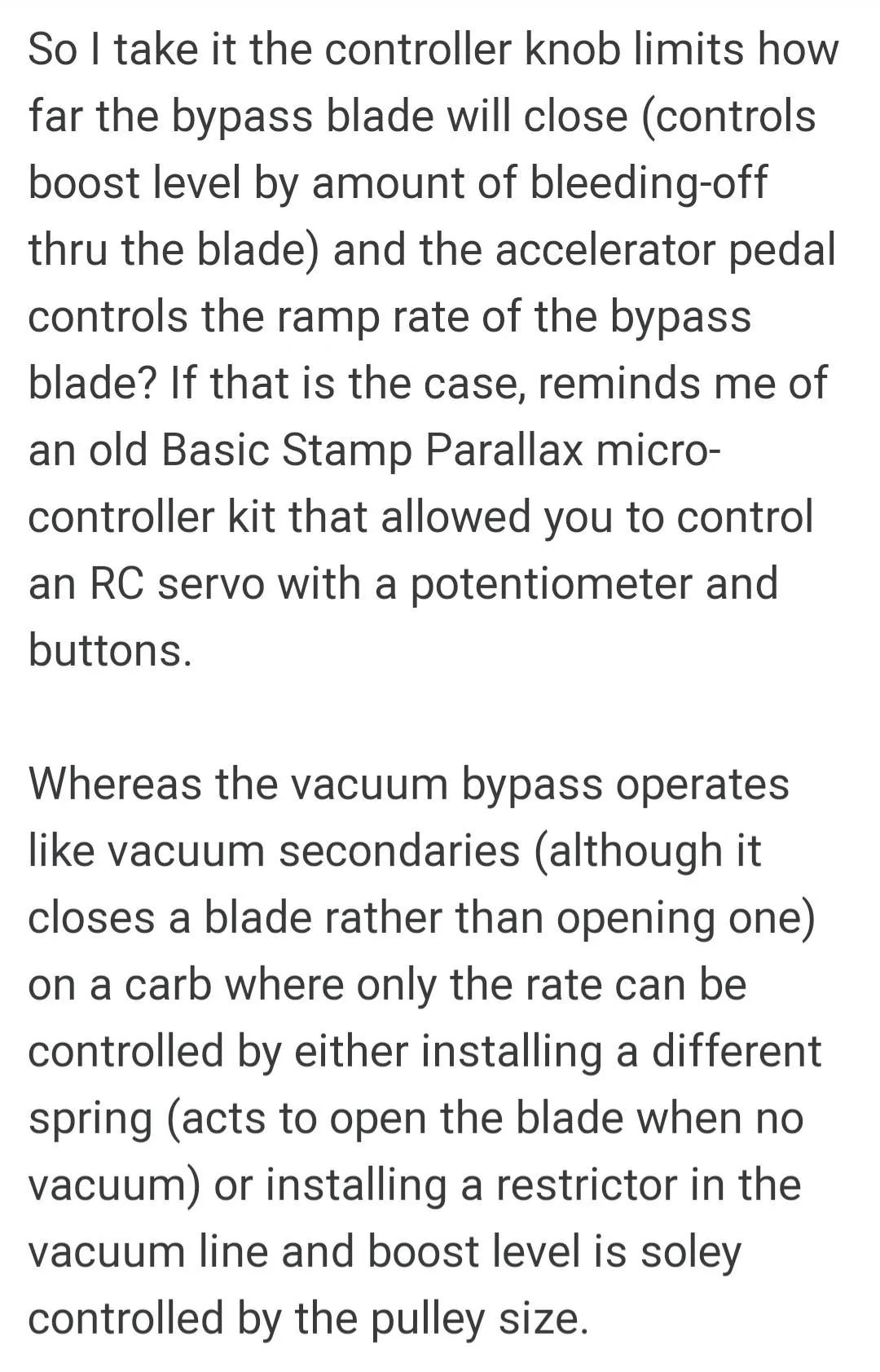

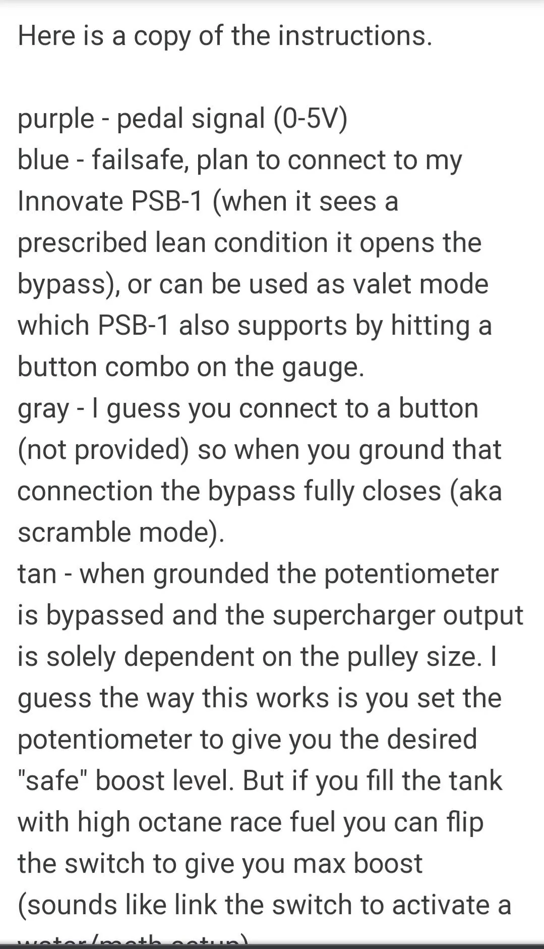

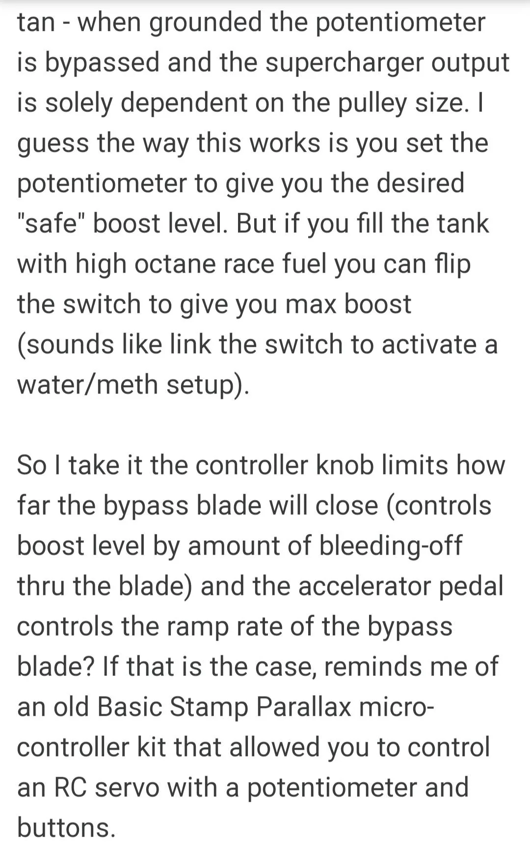

A bit of info I found on a Challenger forum.
