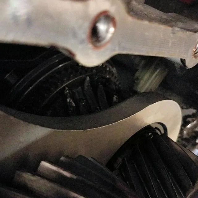

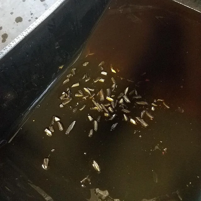

I installed the spec stage 3+ clutch and fly wheel in my car last week. i saw it was a sprung hub and rate to 875 ft/lb which should be nice for my street driven and rarely tracked whipple car right? Did 500 miles in town to break it in. LITERALLY, the first WOT 3-4 shift I did broke 4th gear. 6r80 time I guess..

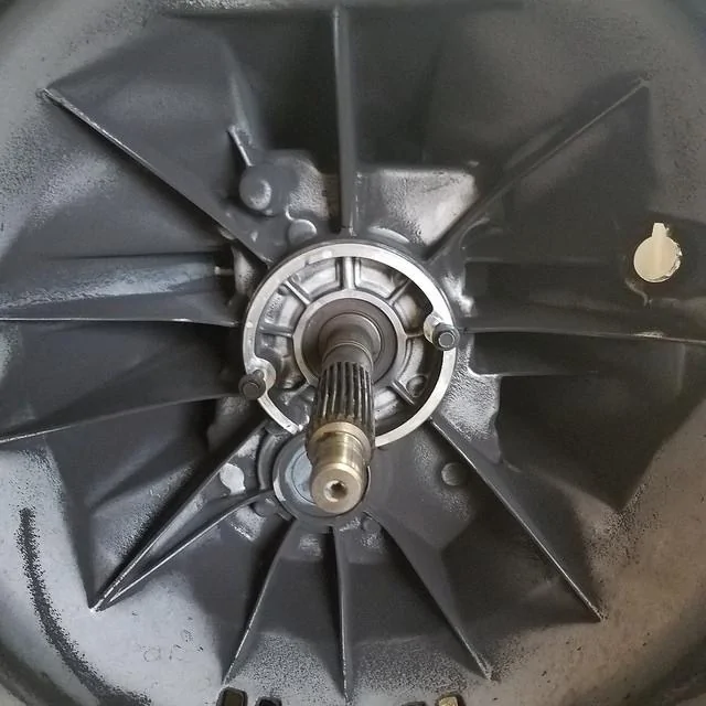

Oh a couple of questions, were you running an aluminum flywheel and did you have to change the output shaft of the MT82?

There's no DOUBT it's a strong unit. I've made several passes at the track on slicks, broken a few parts in the rear end and lost 4th gear aswell. Installed a friends USED trans (had over 100 passes easily) and went back to the track with out power shifting managed a PB. Power shifting will almost always break an MT82 with any aggressive clutch. Ive since added a WOT box and it made a massive difference in how the trans feels.
