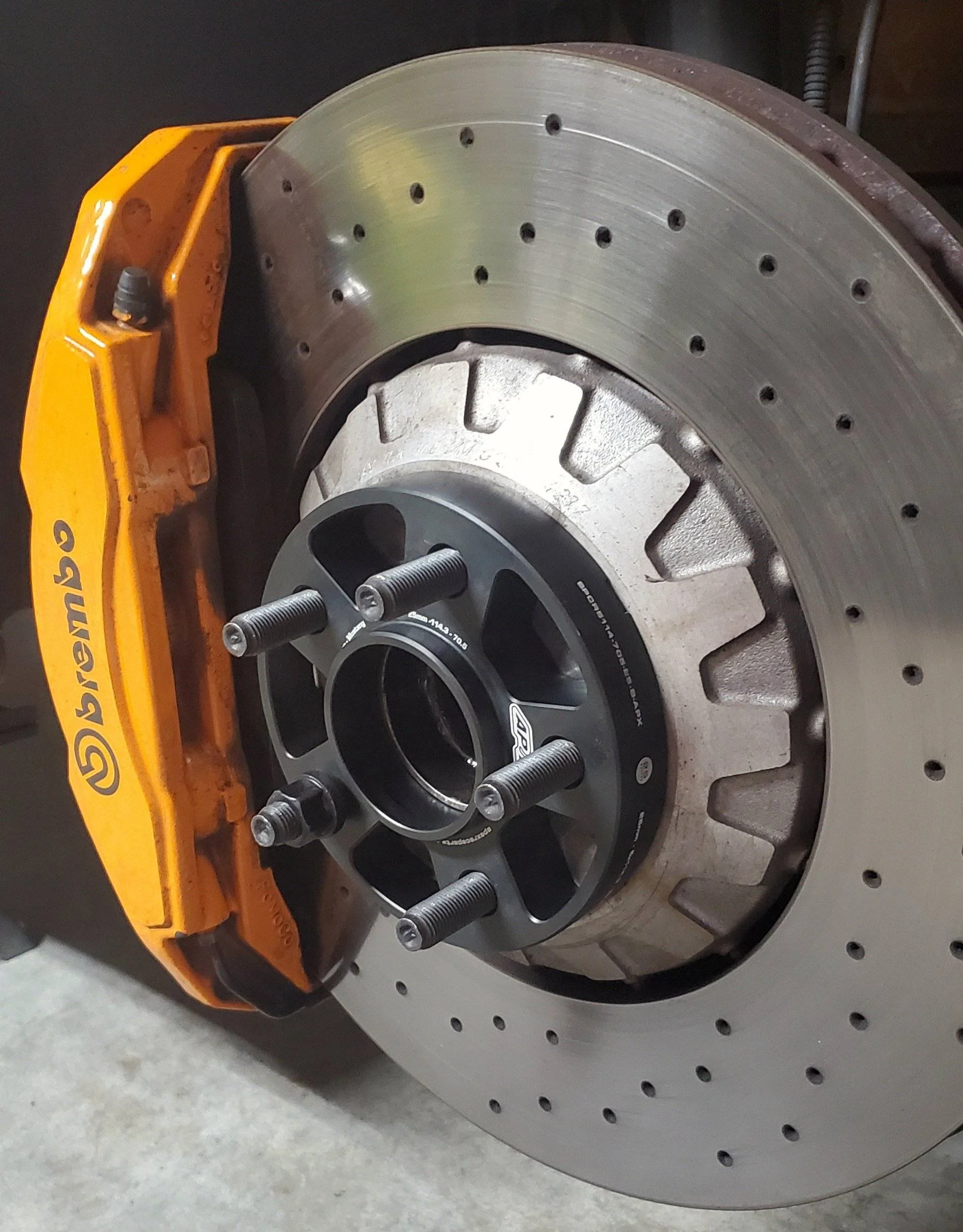

Is it possible to swap to the longer studs and slip on spacers but trim the studs so you can still used closed end lug nuts? I hate the open end lug look on a street car.
Customers do it all the time. Depending on the spacer and wheel, the studs may not need any trimming.

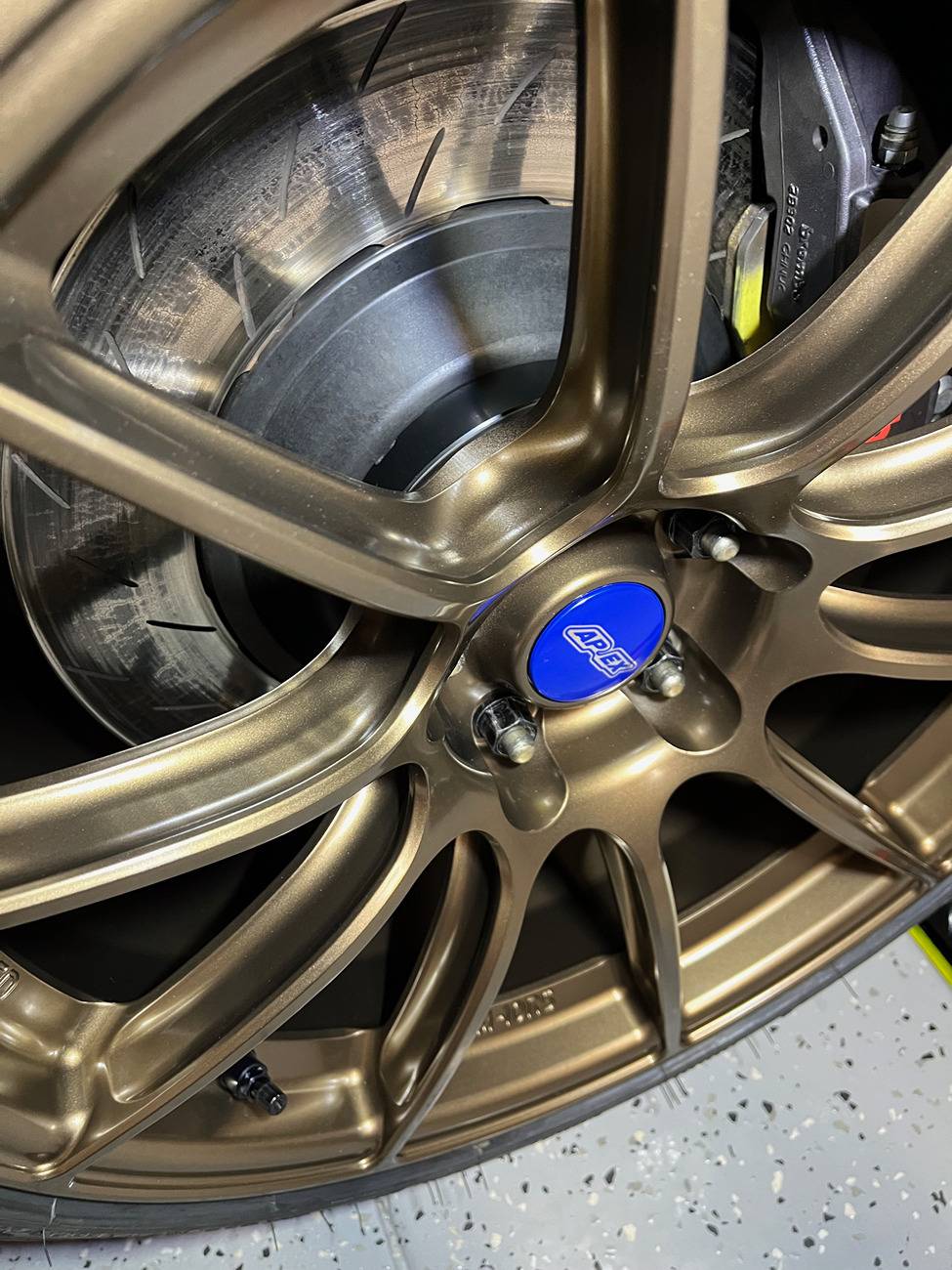

A lot of Customers have gone to 28mm spacers, gives more clearance for 315 tires.
I personally run 31's because I have a lot of camber at the strut at the moment.
Certainly not opposed to going with a 28 and an extra 3mm shouldn't make much of a difference, but going with a 50 offset, was hoping to keep it as tight as possible.
Car is primarily a weekend toy, have yet to see a track or formal event.
a +50 is already out 2mm from an APEX wheel, a 23mm spacer would be ideal.
yeah 31mm here too. 315s on 11” front wheels.
