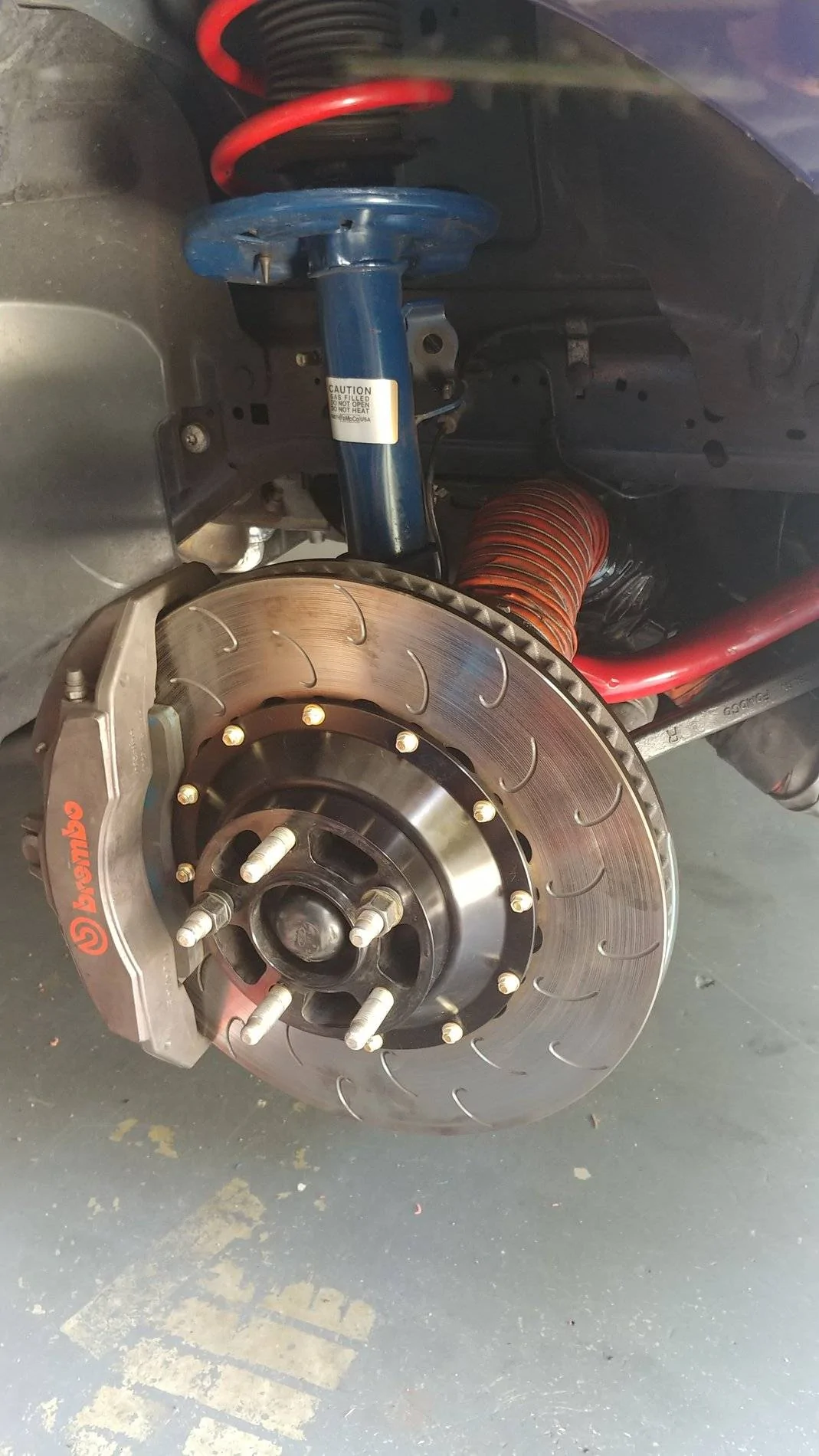

I'm running the CJ pony parts 1" slip on spacer (w/o studs) and ARP extended studs with those EC-7 18X11 wheels up front. Solid setup and then as Ewheels mentioned, you can simply run open ended lug nuts on the street. I have only heard bad things about those spacers with the studs integrated into them... I wouldn't even consider those for the street to be honest. You really don't want a wheel/stud failure going 100+. That could be a very bad day.

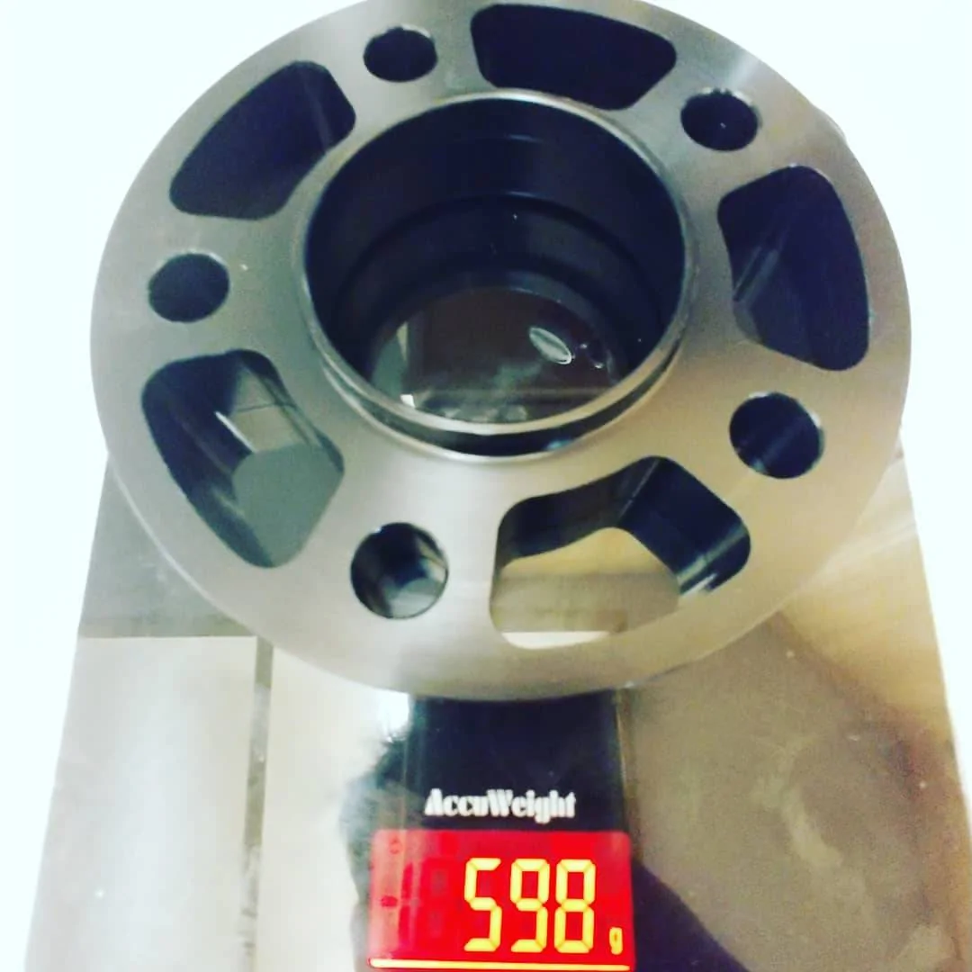

Sellsnthe best spacer in the market.
All the mustang guys racing or tracking use them. Great product. Light and resistant
Got the same combo for mine too.

Yes op is the best I have seen and I also have them on my car. But they are +$100 more than the steeda type 2 then you add nuts and studs +$70.
Steeda type 2 is 70 bucks with studs and nuts. Racing always costs more money.
