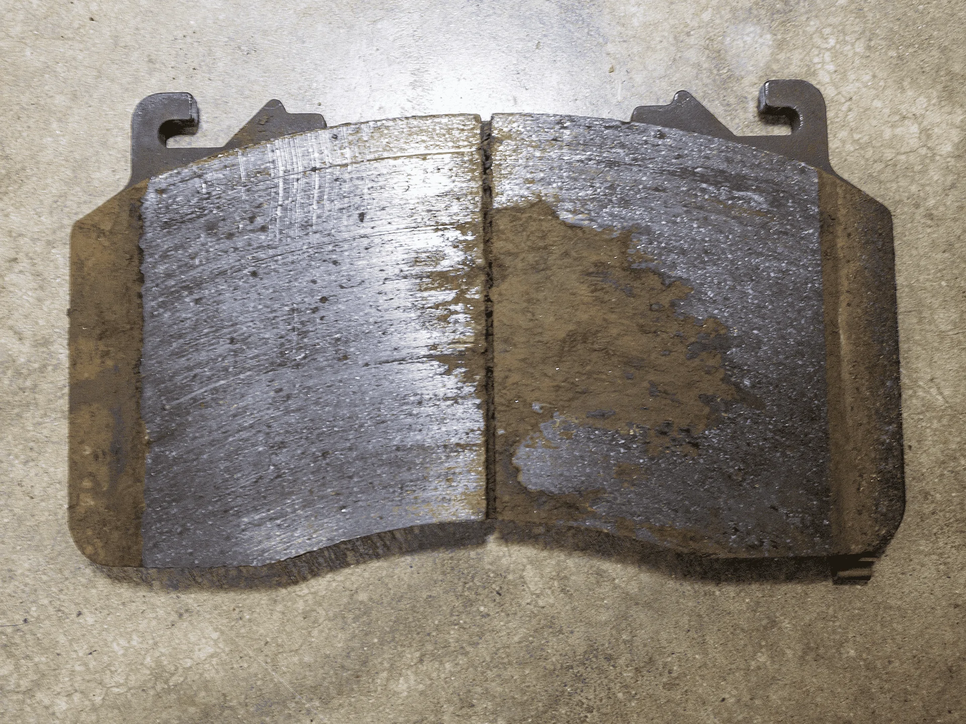

After the car washing is complete and the vehicle has been dried, at least for the S550 GT 500's, it is absolutely, positively imperative that you drive the vehicle AND give the brakes a good workout. Reason is, your rotors and pads will still have moisture and if you simply park the car when you're done, the rotors will start the rusting process and can easily freeze the car in position.
Then, when you go to back it out of the garage, the car won't want to move. You give it a bit more throttle and BANG, the stuck pads will finally release and you'll have an ugly, perhaps even pitted, spot on your rotors. Ask me how I know. Never had this happen with a previous vehicle but I learned the hard way with the '20 500.
So be sure and get her on the road and warm up those brakes before you put her away. Those pizza plate fronts should be pristine and shiny.

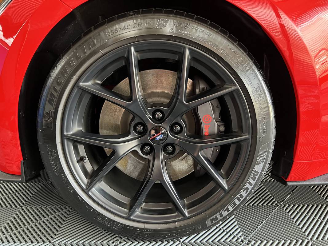

KB, my process to prevent the rusty rotors is to roll the car up and down my inclined driveway a couple times while dragging the brakes. No need to go for a drive and dirty up the freshly cleaned car.
I’m also going to look into a rust inhibitor spray for the drying cycle. I never even considered that until watching a Obsessed Garage video where Matt used a spray on his rotors and stated he absolutely hates rusty rotors.

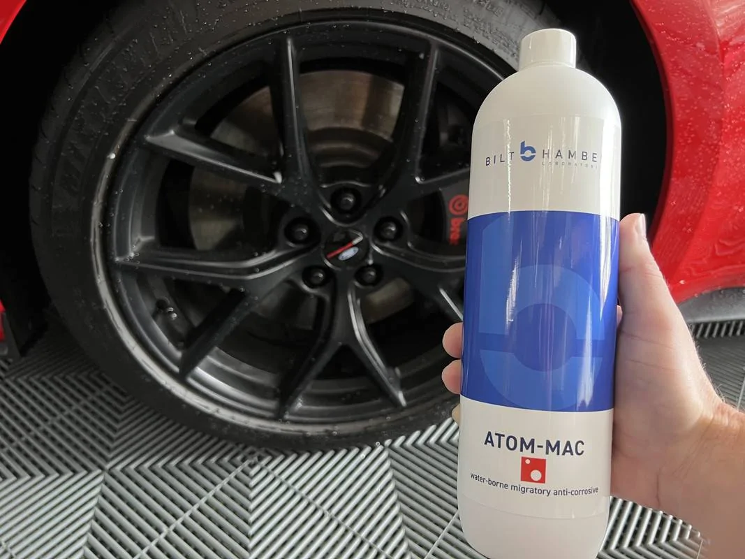

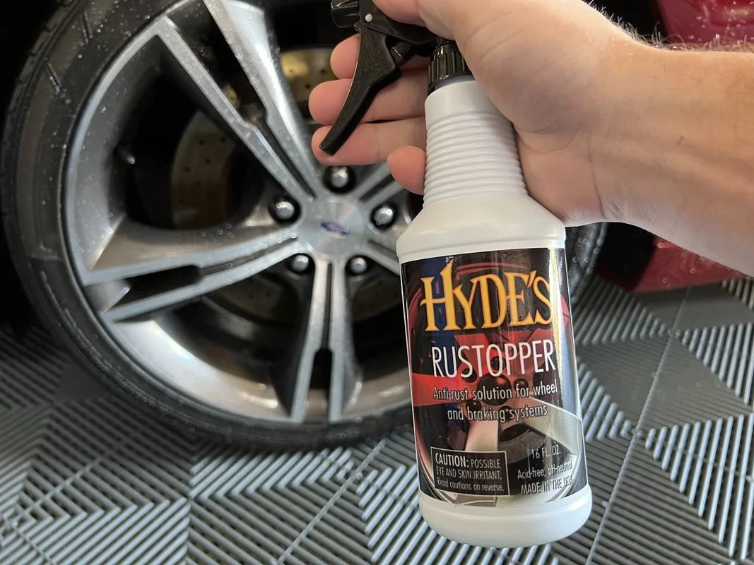

Having used two now, Hydes Serum Rustopper and Bilt Hamber Atom Mac, I would say Atom Mac is superior. At the moment, for those in the USA, you will need to import Atom Mac from overseas. However, Obsessed Garage have taken on the distribution rights for Bilt Hamber in the USA, so Atom Mac should be available within the next few months.
Rust Inhibitor For Cars | Hyde's Serum Rustopper | Obsessed Garage
Atom-Mac - Bilt Hamber
In both cases, you need to apply liberally to get a good result, less so with Atom Mac.

I had been using Hydes, D., until the rusted in place event. Keeping the rotors dry and free of rust is only half the battle, it's the pad that got me. When I pulled the wheel and looked at the pad, it had a great big ol' hole in it.

I have the Hydes and it works pretty well, however I agree with Kilobravo. I have to take mine around the block and use the brakes a few times or mine do stick pretty badly over a few days. Plus if you apply the rust inhibitor liberally, it makes a mess inside the wheel barrel that I have to clean up :) I have found that Brake Buster helps too, since it has a rust inhibitor built in. I usually use an iron remover type cleaner first then foam brake buster on both the wheels and wheel arches for a final touch up. Rinsing with DI water helps some too, my rotors rust within seconds when using non filtered water.

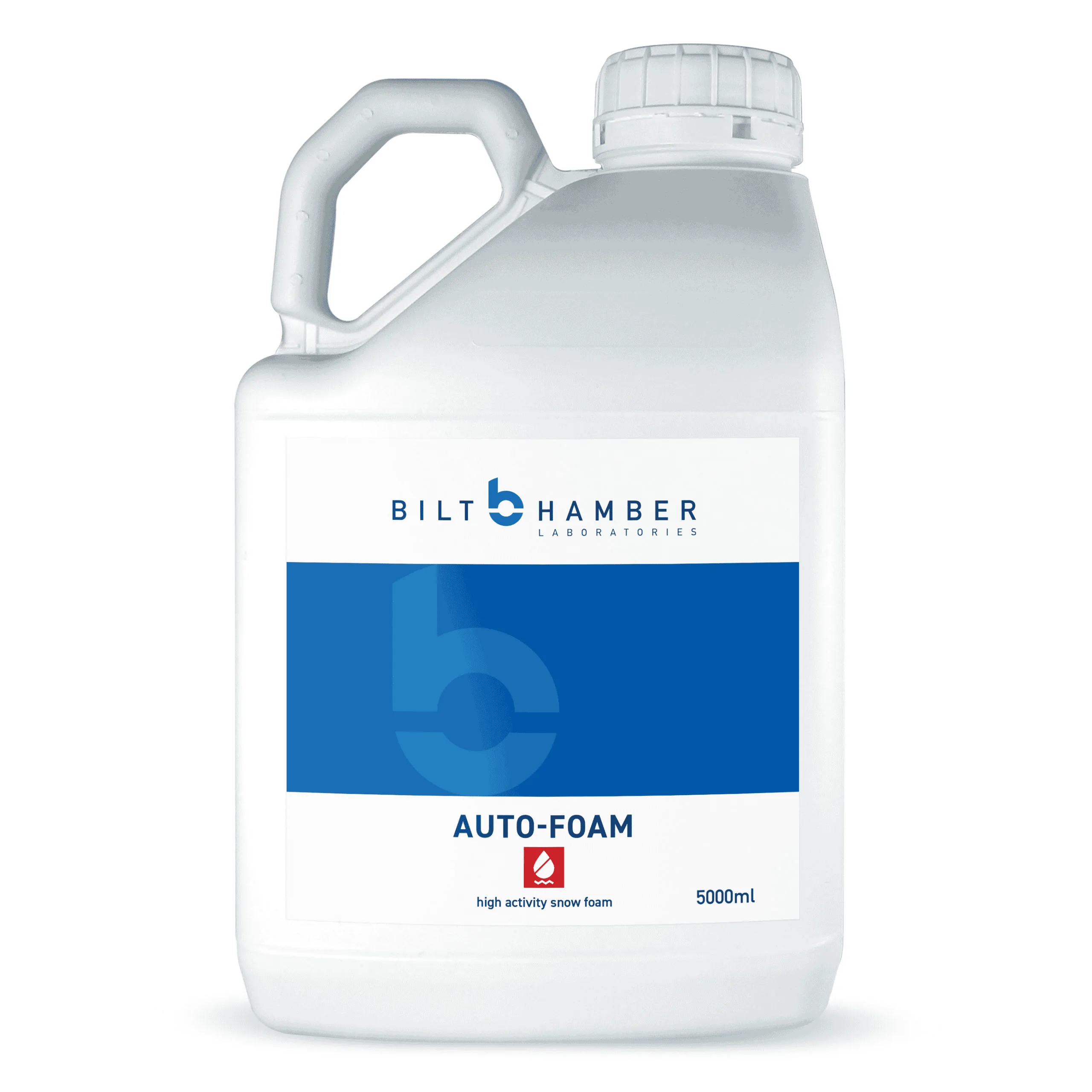

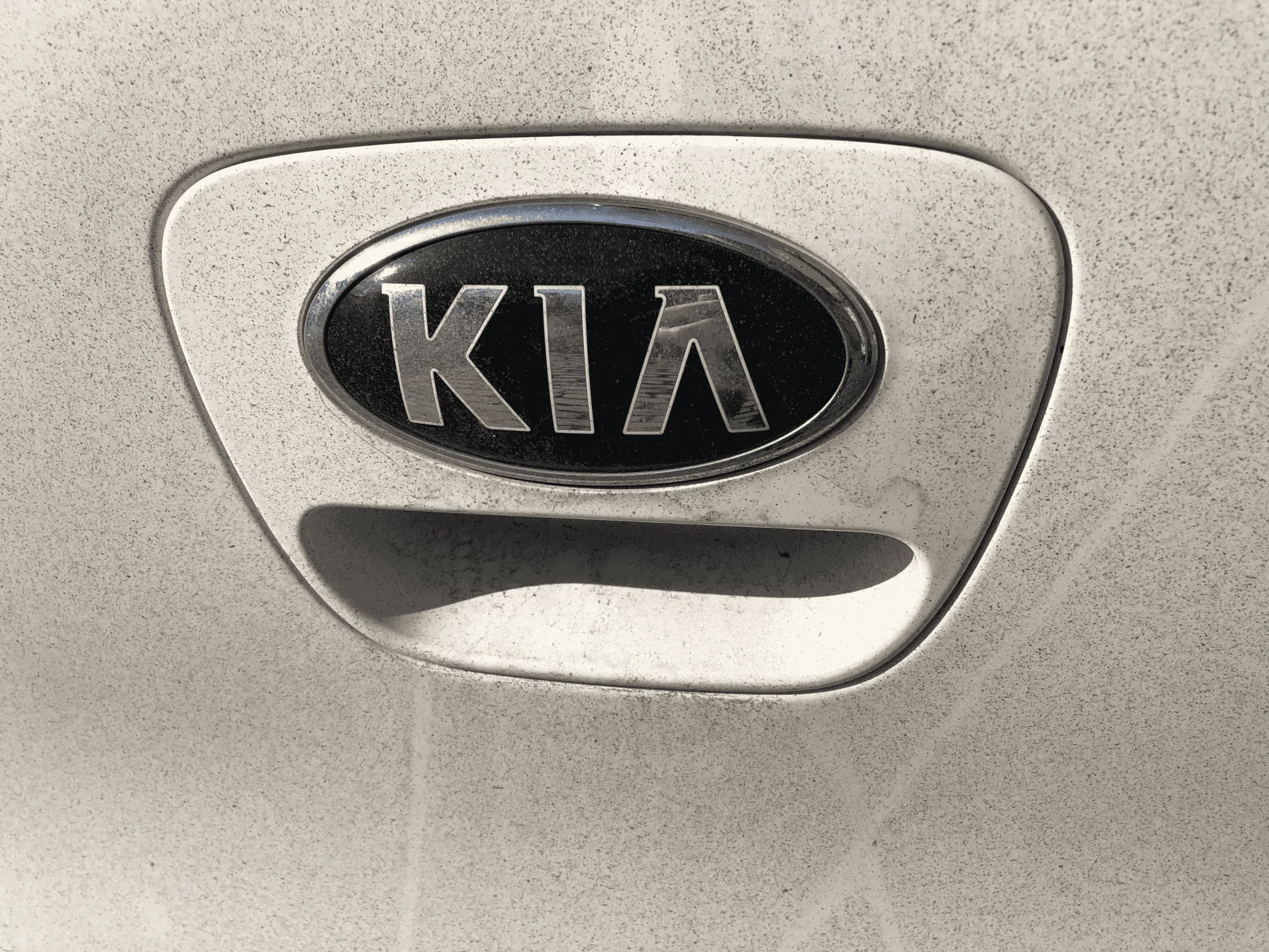

Side note, as @DFB5.0 mentioned that Bilt Hamber is on its way to the states, try this product for daily drivers :
Even with my soft water and typically very good ability to create foam, this one is quite runny / watery (so based on that other thread, apply it to a dry car), but its cleaning ability as a stand alone product is absolutely outstanding :like:

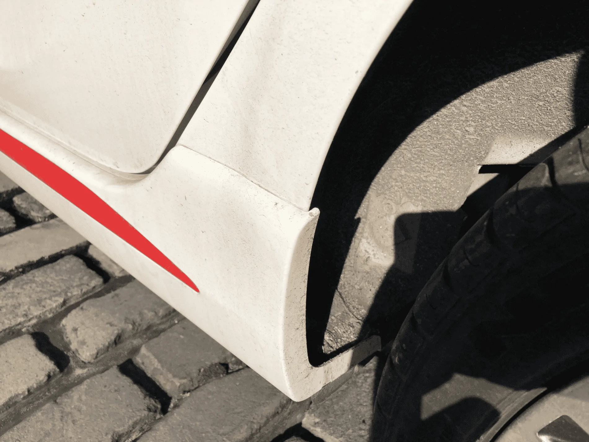

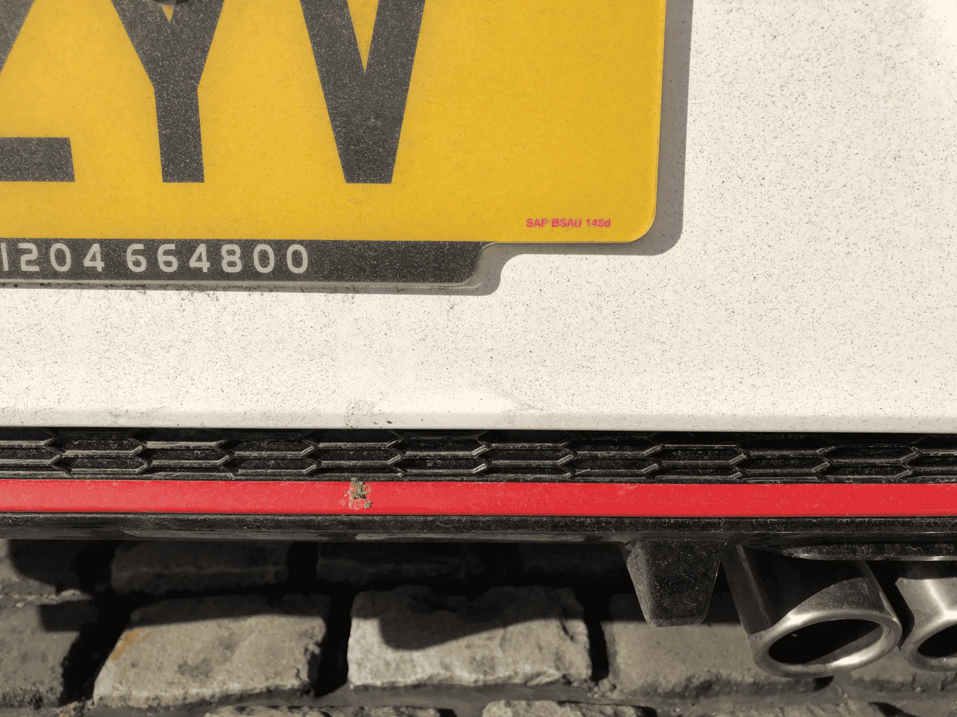

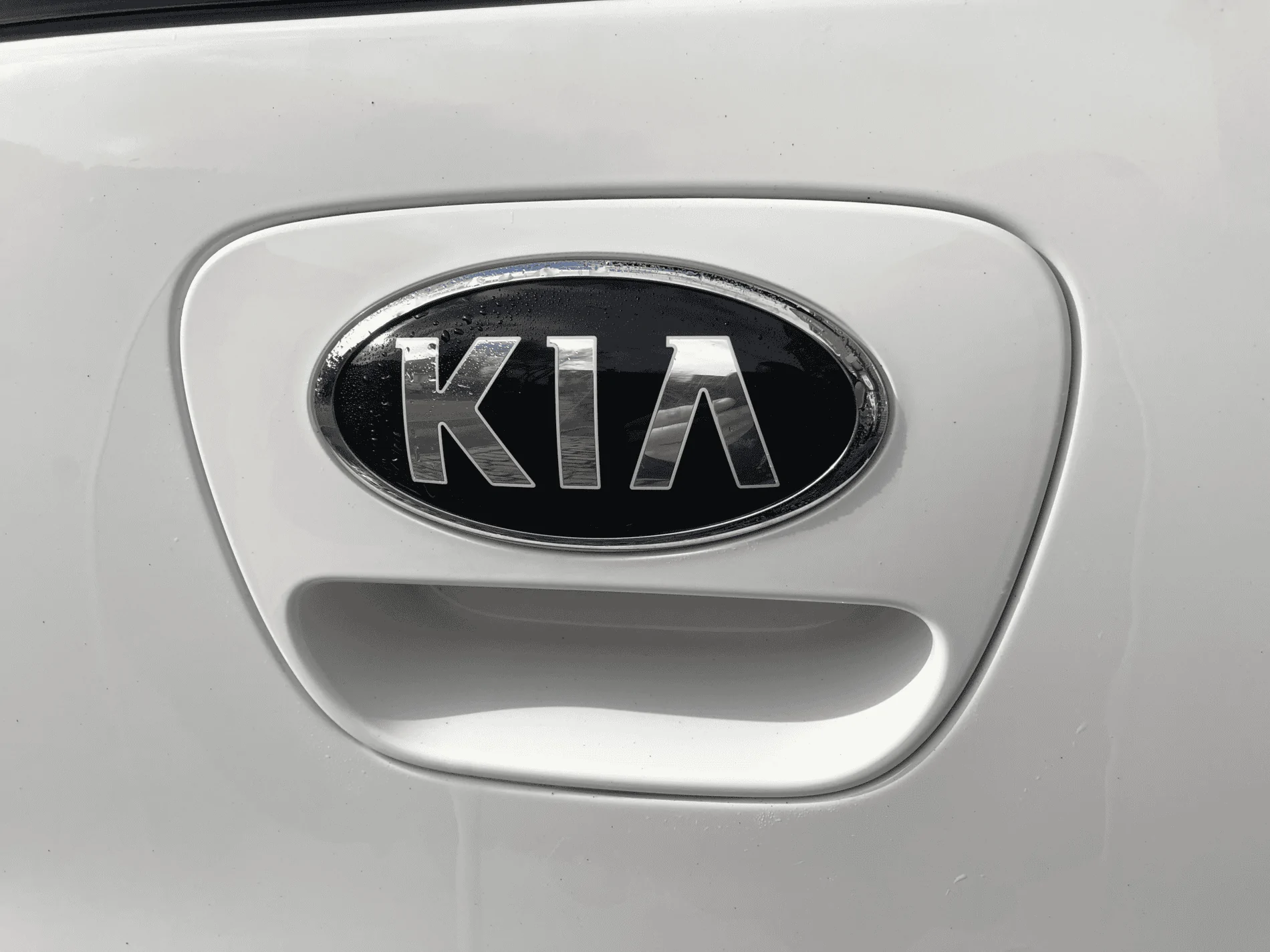

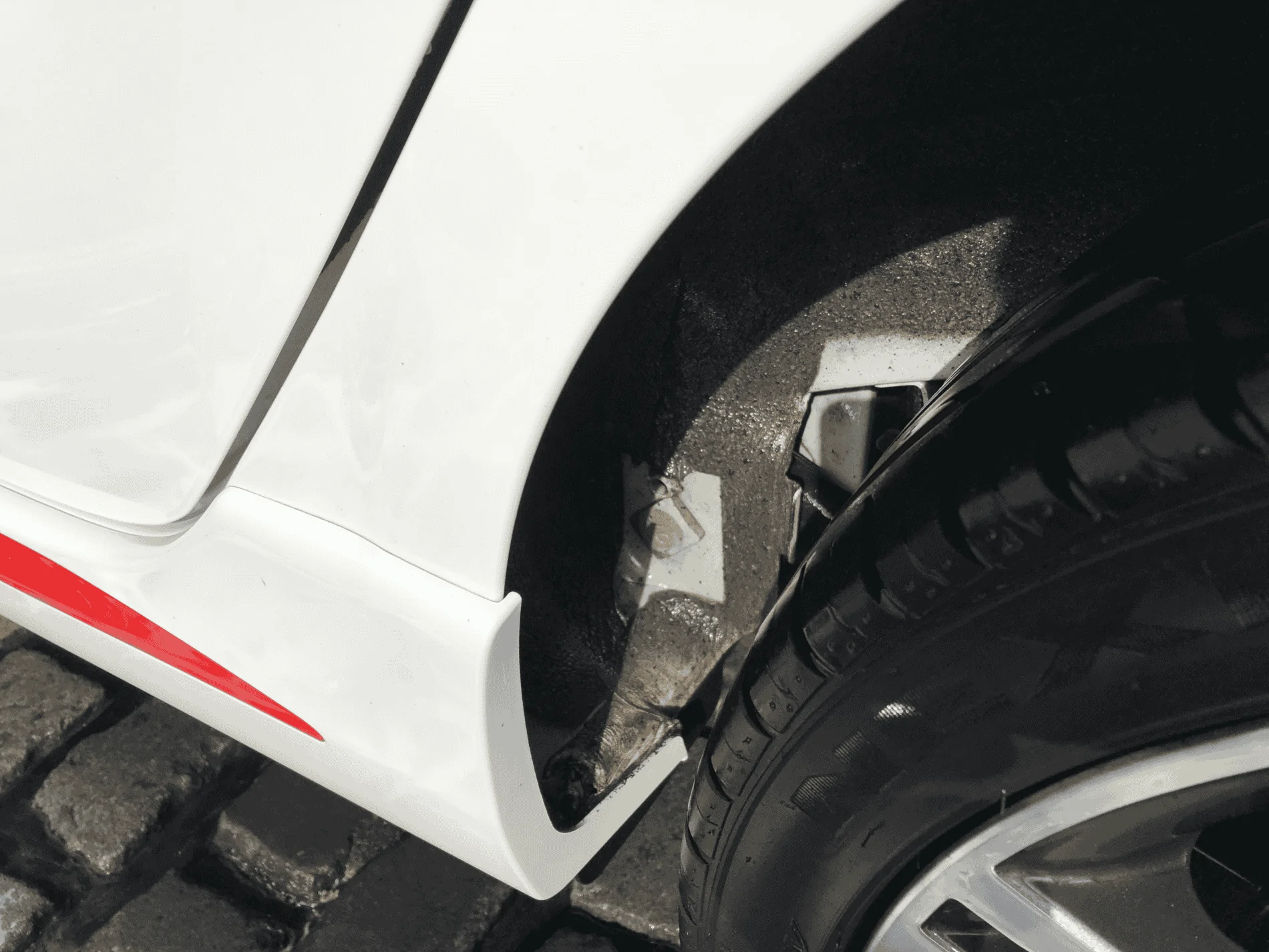

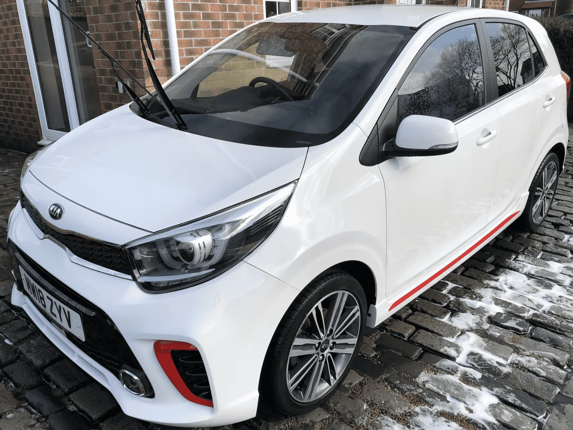

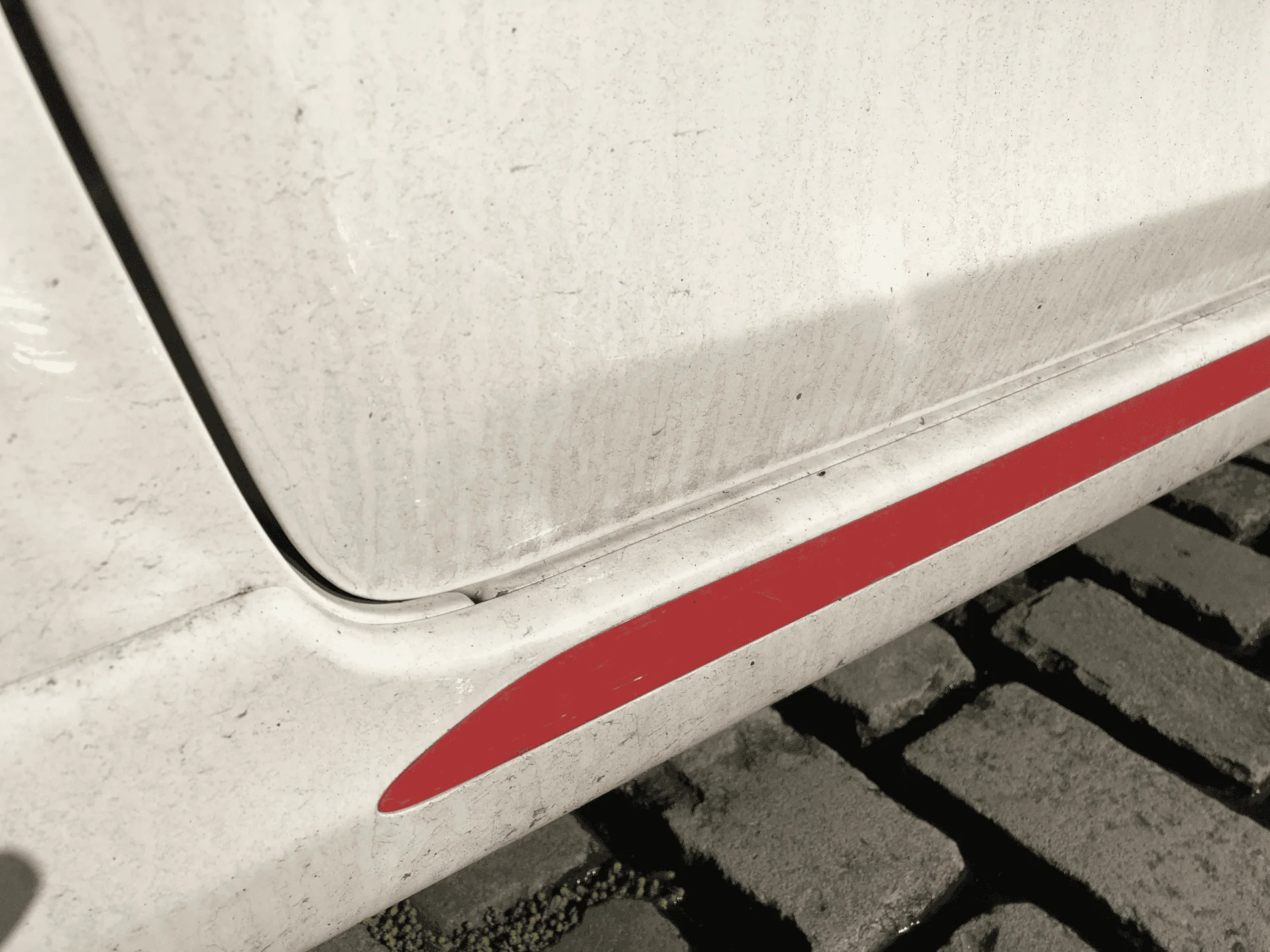

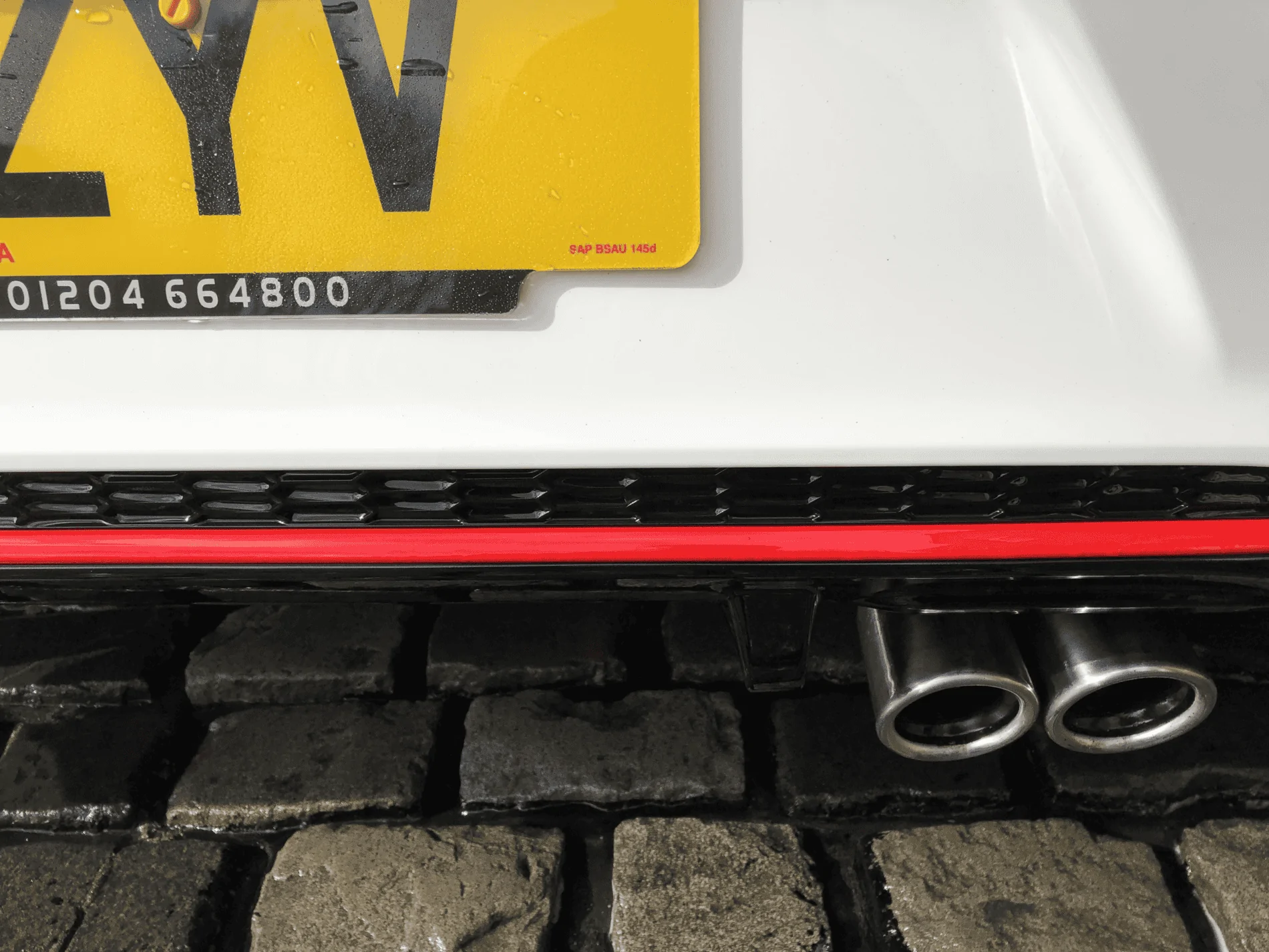

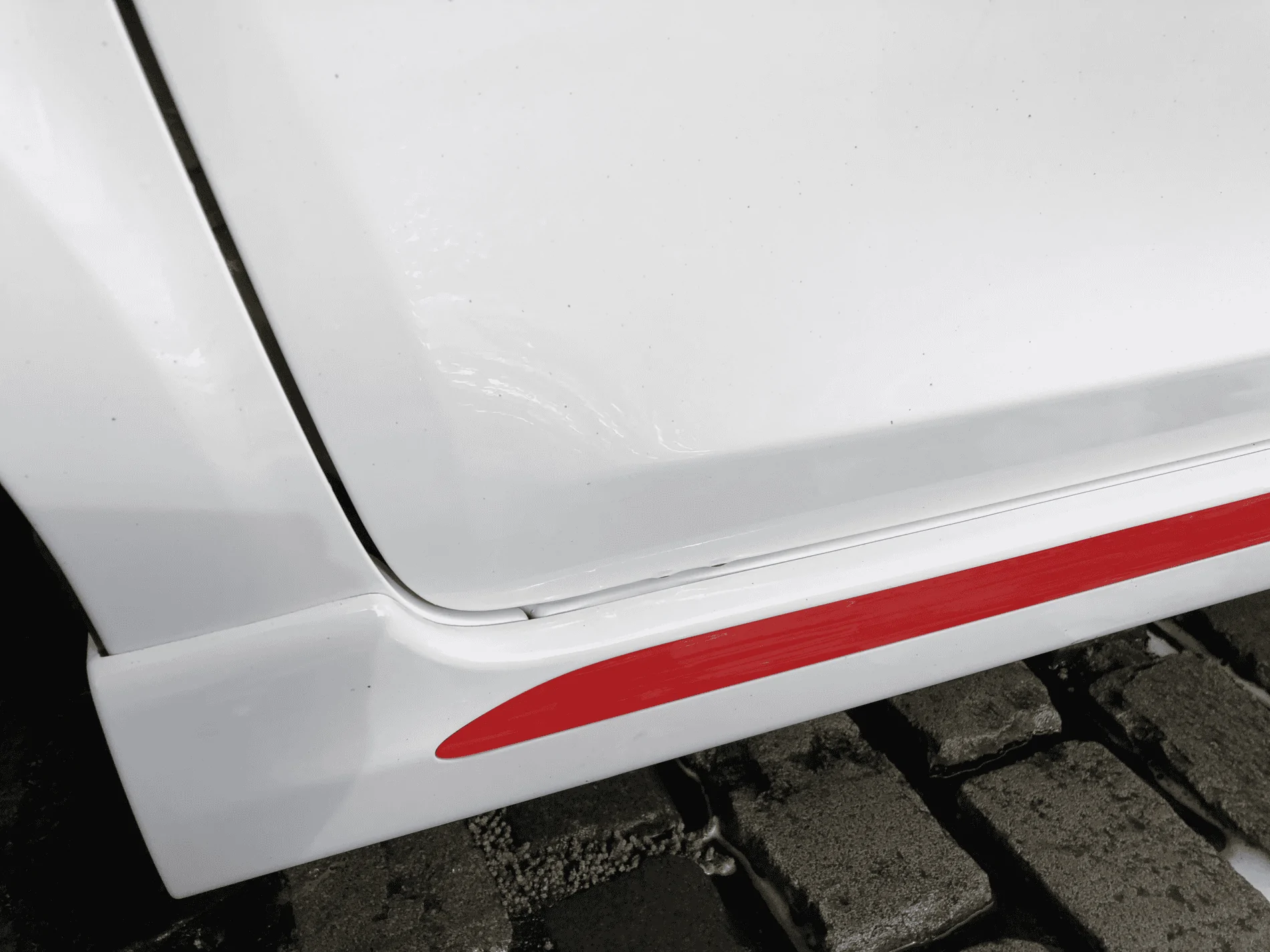

@clevernickname - Another example of foam and jet wash only - on a white car this time which wont hide anything :like:
I washed the misses car today. It doesn't get pampered (it's a lease), it's coming up to three years old, it gets used everyday and she doesn't really care about cars.
It brings it up good enough for me not to bother getting the buckets out for every wash :
It's never going to be a show winner, but in her eyes it's now a clean car and it gets me in her good books ... lol
A few things to note :
  • The car hadn't been washed for a few weeks, but the wheels were washed reasonably well last weekend (I had new wheel cleaner to try) i.e. don't use the wheels as a guide.
  • There are some debris left on the panels, but to be fair they don't come off with a follow up bucket wash either. They are mostly tar spots and fallout - the car really needs a good decontamination (which in turn will make the foam wash appear even more effective).
  • There is some light paint staining that a follow up bucket wash would help with. The camera doesn't really capture them well, the areas where water runs out from under door handles and door shuts etc.
Hope that helps :like:

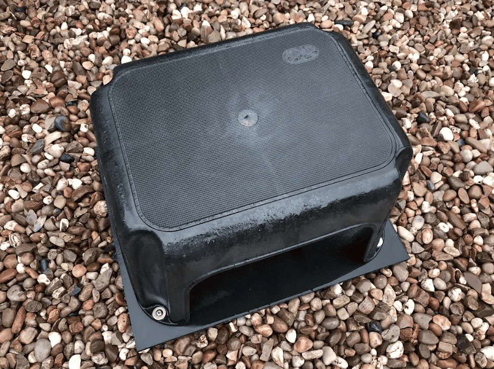

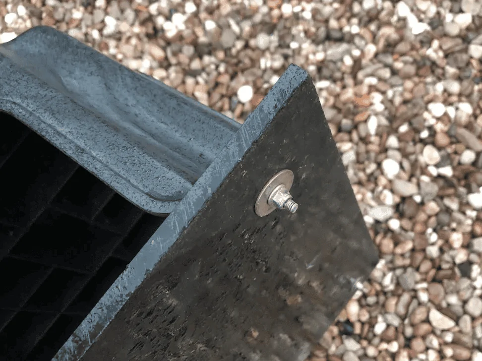

I've just nipped out on this wonderful U.K. day to snap a few pics of my poor man's version of a detailing stool :
:giggle:
I use it to wash the roof of the sportage and to sit on when I do wheels, when its not in car use it sits in the garden so the kids can climb onto the trampoline a bit easier.
I put the base on it to stop the legs getting trapped between the cobbles (I broke the first one) and to stop it sinking in the chippings. The studs purposely protrude so it doesn't skate on the wet cobbles on the slopped parts of the drive :
It doesn't stop me wanting a fancy one though ... :facepalm: :giggle:
