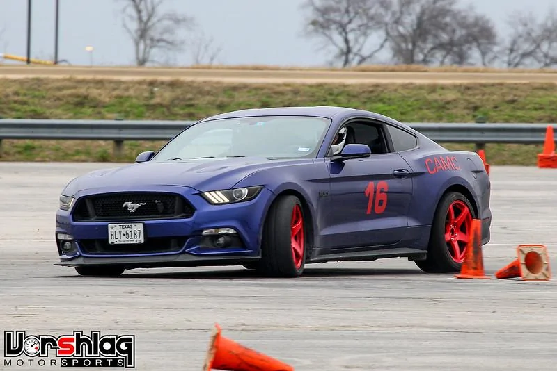

Here's a picture of my car running a set of 18x11 Forgestars and 315 rivals. The wheels and tires belonged to my codriver and unfortunately only made it half the season due to an unfortunate accident driving to an event.
