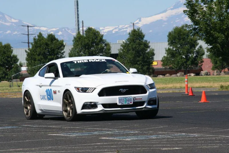

Lately been trying out a radical for Mustangs setup: RSB disconnected. I was running on 1440 lb 5.5" rear springs and have gone from Steeda bar on soft to GTPP bar to V6 bar and now bar disconnected with 1600 lb 2.25" springs. I really like how the car is handling.
Here it is coming off a turn-around at WOT:
