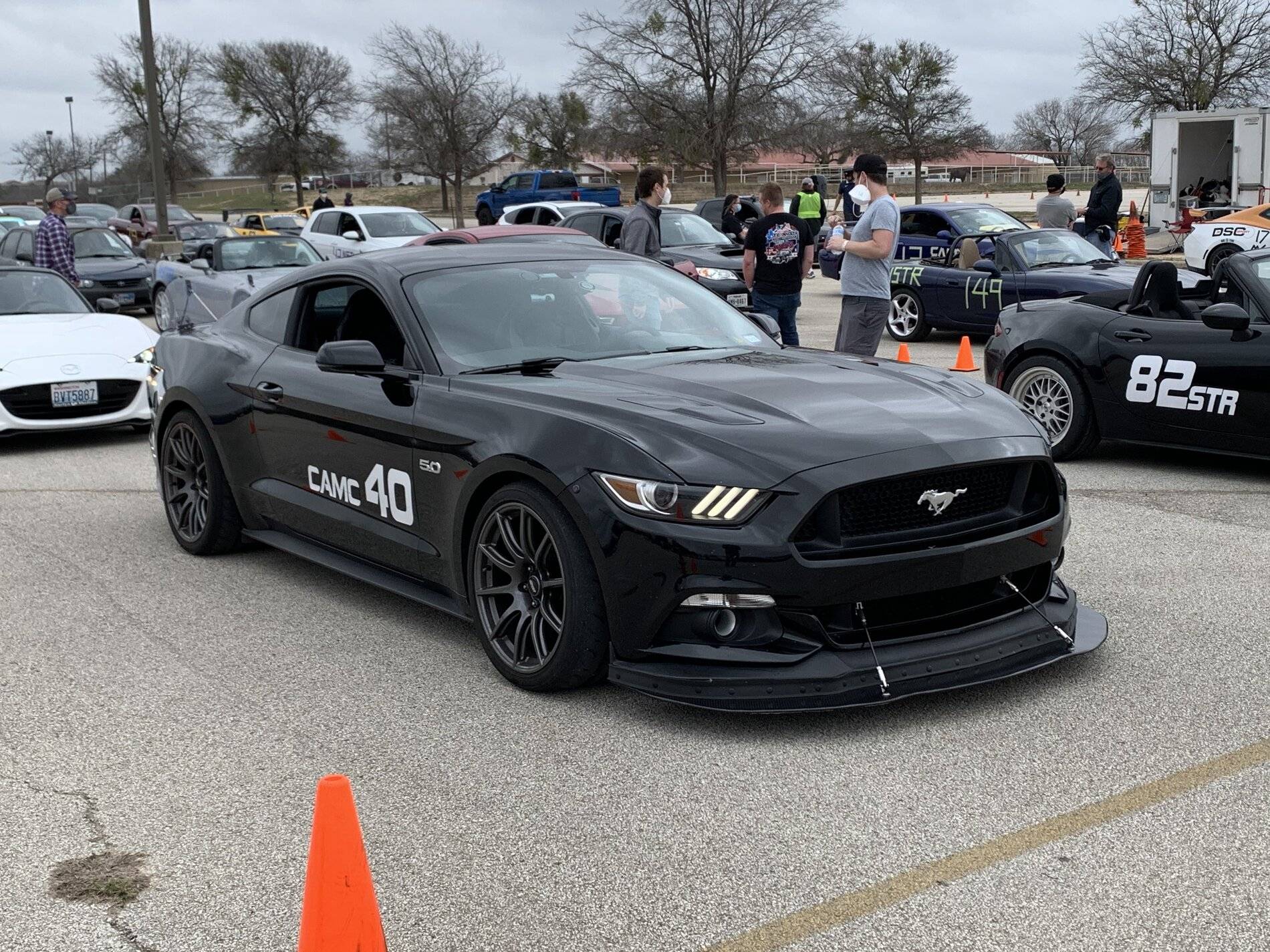

So spoiler and splitter felt good on course. Could have tricked me into thinking I was on stickier tires on my first couple of runs, esp through the medium to fast stuff. My car has always been neutral to ‘lively’ balance and it felt very solidly planted powering out of stuff compared to what I remember. Car felt planted.
My overall PAX for the day wasn’t wildly improved, but not any worse than how I normally finish (inside top 10%, 2nd in CAM class after a 630rwhp Optima ZL1 build which is technically not legal in CAM because wing and canards, driven by a top competitor). Also, my year old 100 run and multiple track day RE71s are kind of shot.
highway mpg was down about 3mpg or -20%, and it really wanted to drive straight down theroad with that airbrake out back. Everything survived the trip.
