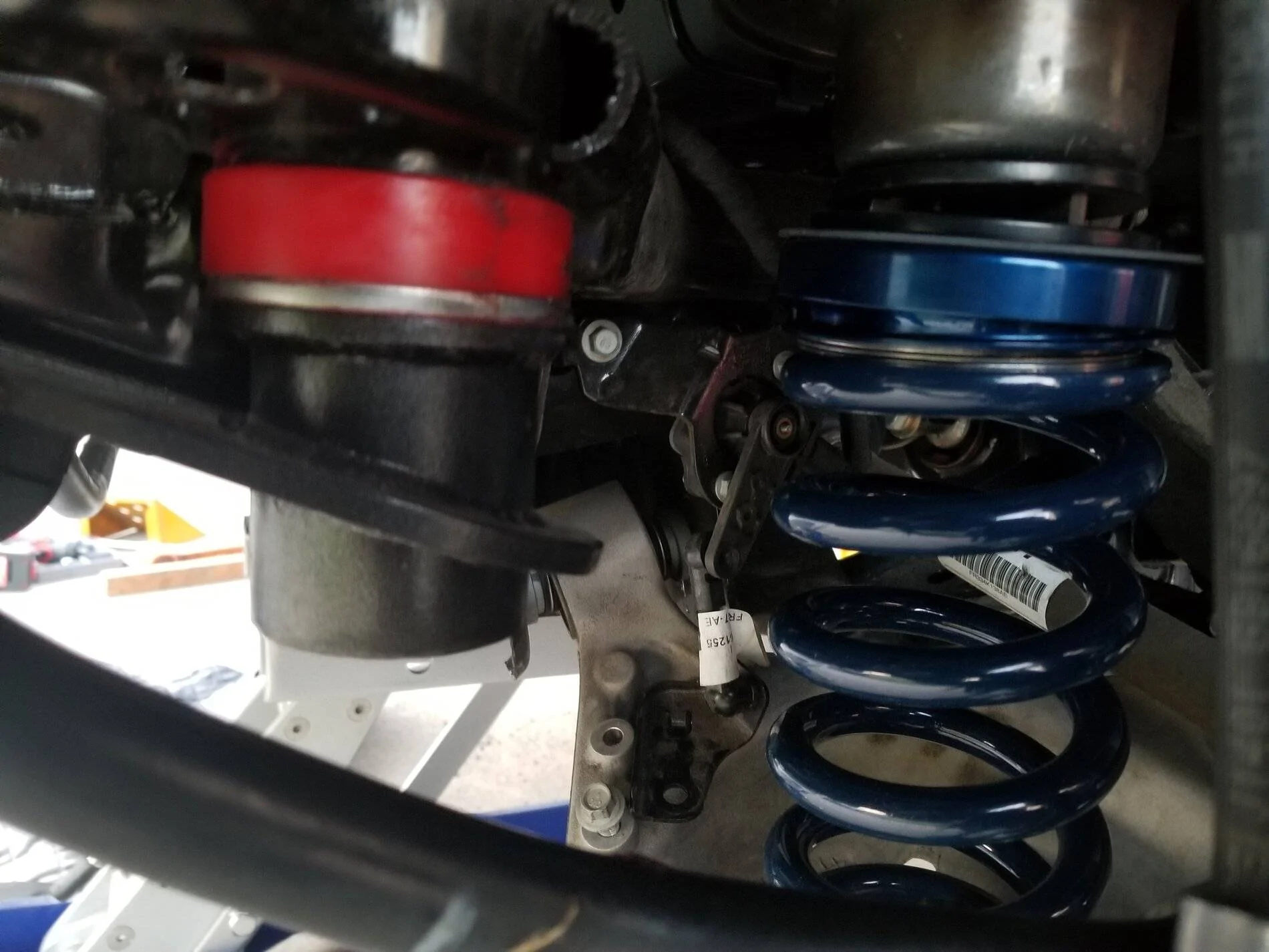

After a pretty brutal last 2 weeks away on a work trip, I'm finally back and get to play with my car. I felt the rear spring rate was too stiff last time I ran, so I'm dropping 200# and seeing where we end up. I'm also running a longer spring to give that a go.
What you're seeing in the picture is a 8x2.5" 750 #/in spring on the Mike Maier weight/jacker ride height mounts. The blue aluminum spring perch is called a Hyperco hydraulic spring perch. It allows the spring seat to 'wobble' to accommodate the arc as the spring is compressed. It's riding on Torrington bearings to allow for easier turning of the weight jacker when the spring is preloaded.
I don't have the car on the ground, yet, but hopefully the ride height is acceptably low, because I don't have room to go further down right now. If it's not, I have an 850 x 7 x 2.5 that will take its place. Ya gotta cover all the bases.
Nice find on these. Might be worth getting this and taking out my helpers. The lower perch of the MMI setup already rotates freely, so not seeing why torrington is needed up there?
Any special fitment needed to install on the MMI upper?

Welcome back!
The Torrington might not be strictly necessary. Consider it a choice of habit. There is nothing tricky about installing the perch, it's just a fancy spacer. I did get 1.5mm thick rubber sheet & cut out a donut to put between the chassis mount & the top of the perch in an effort to avoid a metal on metal situation.

Thanks.
I wonder if it makes more sense to have on the lower perch to avoid the chance of rattle due to unloading the suspension. Gravity assist.

Maybe. I kinda wanted something between the spring & the perch so I didn't mess up my new pretty piece. A single thrust washer would have done the same. With the 7" spring, there's not much rattling at full droop. Because of all the angles, it is always engaged a little bit. If you want to run a stiffer rate, you would probably want to have a 6" spring.

Yeah I already have the 1200# 6" springs on the car.
