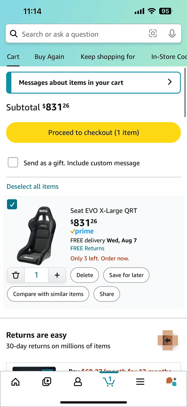

OMP WRC XL might be worth looking into also. I know people like the Airtex material and one of the things that sells them on the seat.
Also it may cost more than other places but Amazon sells the seat with free returns. Just an option

Good to know! 1320 shop near me has one for $720, maybe I should ask how their returns work if anything goes wrong
Ah okay. I was saying if it didn’t fit that you could return it. But if you have one local to you then that’s a better deal.

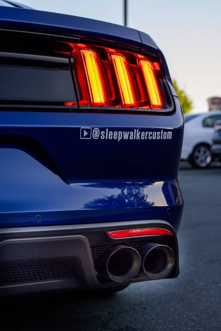

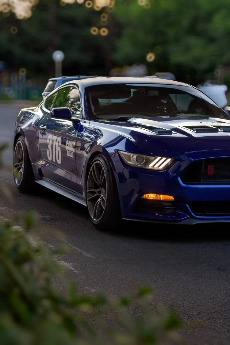

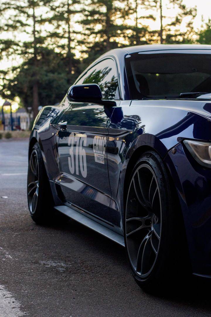

@mavisky how is my form...me and some close friends got the Cobalt Filly out for pics, inspired by you and your Flatplanefury. More to come. Two autocross events coming up and two track days. Seat time seat time seat time, just like you all advised! Also will be adding Sparco seats, harnesses, and roll cage soon to the mix so I can stop floppin around like a rag doll.

Looks great. I can't take photos to save my life, but luckily I've met a few people who actually can LOL.
I totally felt that! My photos are meh because iphone, but my friends have the cannon cameras and know all about the lenses...crazy what pros can do!

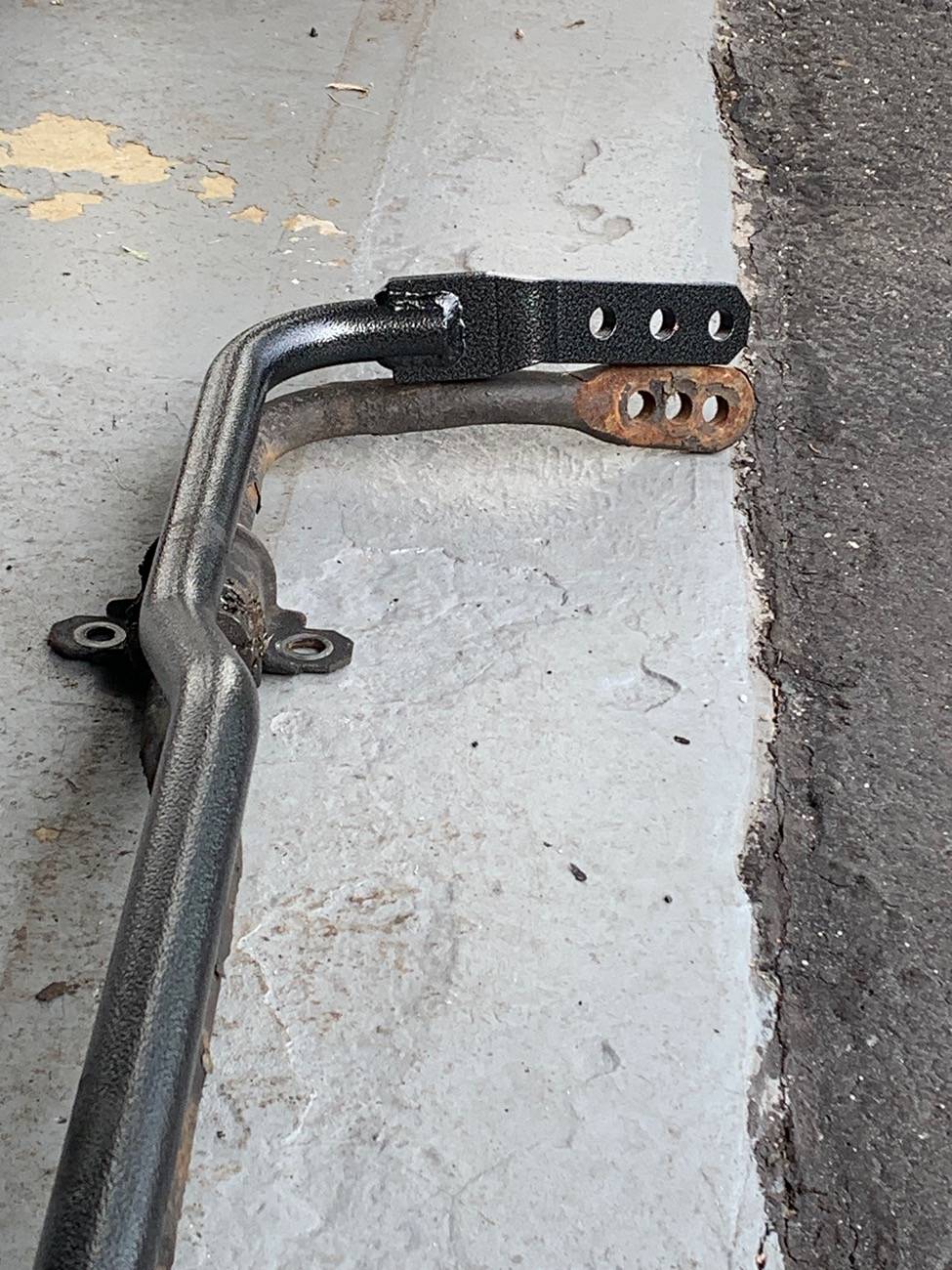

For your viewing pleasure, Strano 22mm bar vs bmr 25 mm rear bar.
currently the BMR is installed full stiff. I don’t care if I live or die, I will be entertained at the next event Saturday.
Edit now that I'm at a PC: I have been very unhappy with the understeering since installing the wing, even at very low AoA. I drove a CSM Mustang a few weeks ago and it was so darn fun to have some eager rotation and life in the vehicle. So now I'm just going for a Mustang that eagerly throttle steers. Hopefully this gets me there.

So surprisingly, a BMR 25mm rear swaybar on full stiff can produce a drivable car:
I'm very happy with the result. 3rd in PAX. Car much more enjoyable and based on the numbers, faster.

I'll admit I'm a little surprised you're not struggling with oversteer coming out of corners, but it hell ya it definitely looks like its carving really well!

knowing what was on the car, it was psychologically difficult to “just drive” for most of the day, but it seems to be basically fine. I’m not changing it for next event.

What front bar do you have that paired with? I found out last weekend that I have been preferring a stiffer rear bar than what is typically suggested.

BMR 38mm on full soft. Before the wing, that much front bar made sense. I'm on GT350R springs, so pretty soft by AX standards.
