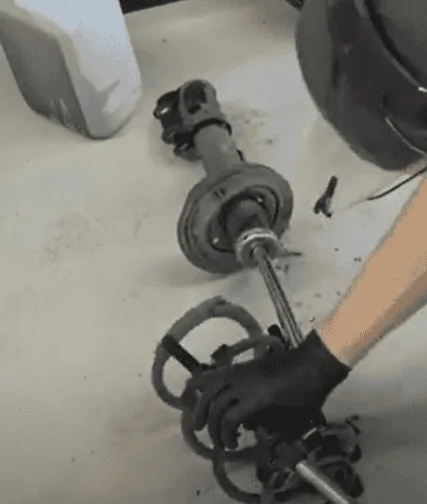

My Kia spring - I understand the rubber sleeve is to prevent the spring from causing a blowout if / when it fails (it did hold it in place, I had to tear it to remove the broken piece of spring from within the remaining coils)
The rubber isolator/insulator on springs are for preventing vibrations/noise, not for tire blowouts.

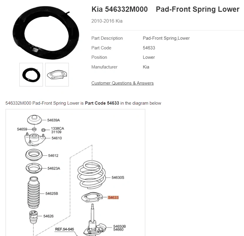

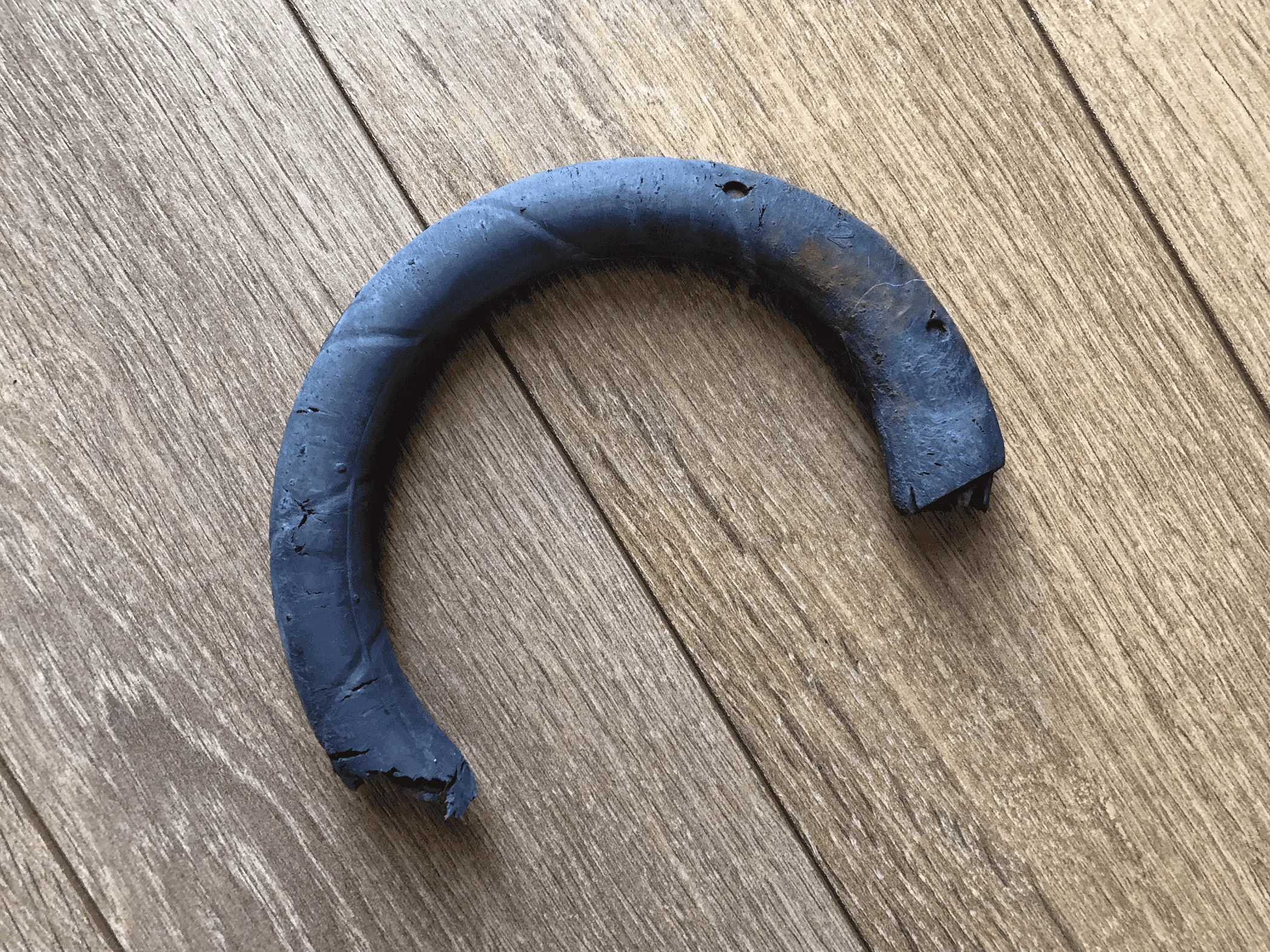

It's not the isolator, it sleeves the first few coils and if I remember correctly, it was a low level recall that was done during service (maybe around year 4) and breezed over.
You can see the sleeve on the photo I posted - the full section of spring is covered in it, the remaining bit of the sleeve is still on the car :
This is the isolator for my car :
You can see both items separately in this screengrab (same car) :
And you can see the rubber sleeve has retained the broken part of the coil.
That's what this part is...
https://www.steeda.com/ford-6r3z-5l302-a-mustang-front-coil-spring-isolator
This isolator slides over the lower portion of either the left or right front spring to minimize NVH and allow free spring rotation during bounce and rebound. Steeda recommends that both left and right isolators are changed in pairs to eliminate height variance side to side.

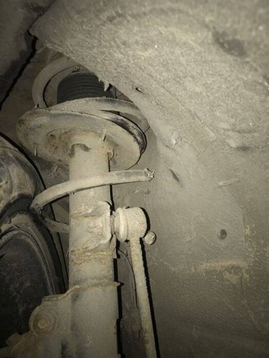

I've posted the info relative to my example, not much more I can say ... ?
Here is the exact same car, without that addiotnal part (I assume it was non Kia serviced) at 5 year 79k :
The additional tube part (separate to the Kia isolator), fitted FOC to my car, by Kia, after manufacture and during a routine yearly service, potentially saved me from the scenario shown above :like:
Which interestingly, is the exact scenario that cost my wife a tyre and a drop link on her mini ... :frown:
