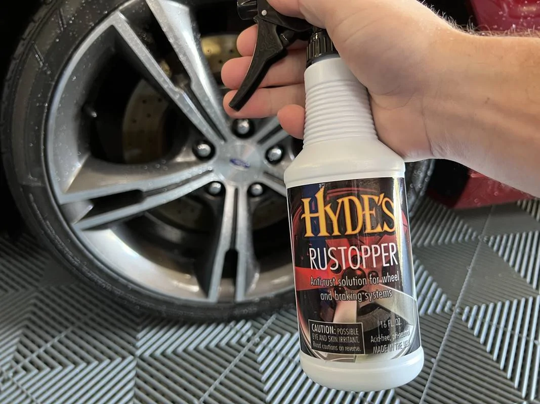

Rusty rotors that shower your freshly cleaned wheels the very second you next apply the brakes...............................a conundrum that has annoyed car enthusiasts and detailers for eons. Very frustrating and most noticeable on black or dark colored wheels.
The old prevention for this situation was to drive forward and backwards several times to dry out the rotors. Time consuming and a display that will certainly have the neighbors perplexed.
However, there are two products that can help reduce or eliminate this issue.
Hydes Serum Rustopper - for brake rotors (detailingshed.com.au)
BILT HAMBER ATOM MAC corrosion inhibitor (detailingshed.com.au)
Rust Inhibitor For Cars | Hyde's Serum Rustopper | Obsessed Garage
Bilt Hamber Atom-Mac | Rust Prevention | Obsessed Garage
These two are used and work in the same way. After you finish cleaning each wheel, spray the product onto the rotor, be somewhat generous to ensure even coverage. For best results, I apply it again after the final rinse and before drying the car. A leaf blower will help dry them out a bit quicker, which also helps. Both are safe for your wheel finish should it drip from the rotor onto the wheel.
The Atom Mac appears expensive, but is dilutable, so a 500ml bottle will take you a long way.
I wrote this article for Detailing Shed on this subject -
Bilt Hamber Atom Mac: A Quick Guide | Detailing Shed

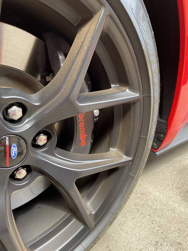

At the end of the wash my Audi has a tiny bit of rust on the rotors so I was wrong to suggest it had no rust but it is barely visible. The Mustang rotors on the other hand are super rusty before I even finish half the wash. The problem really is that the rust comes off as soon as I drive and so my black wheels end up with brown rust dust all over them. 😜😜😜
