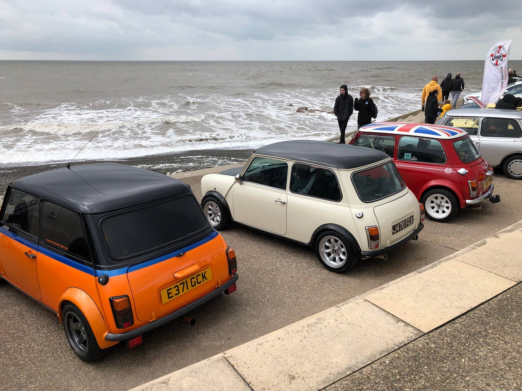

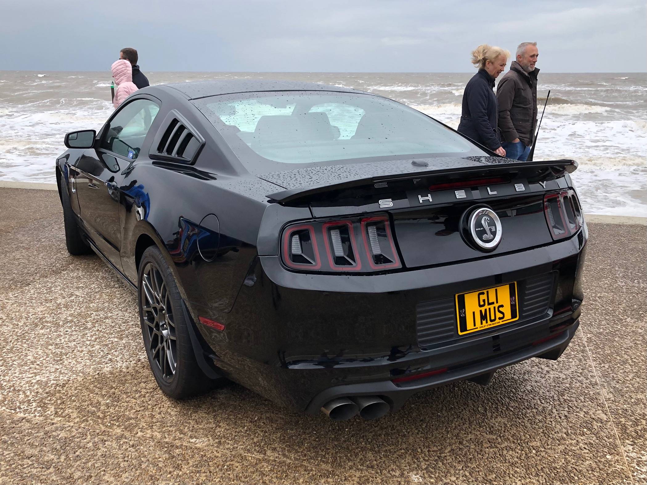

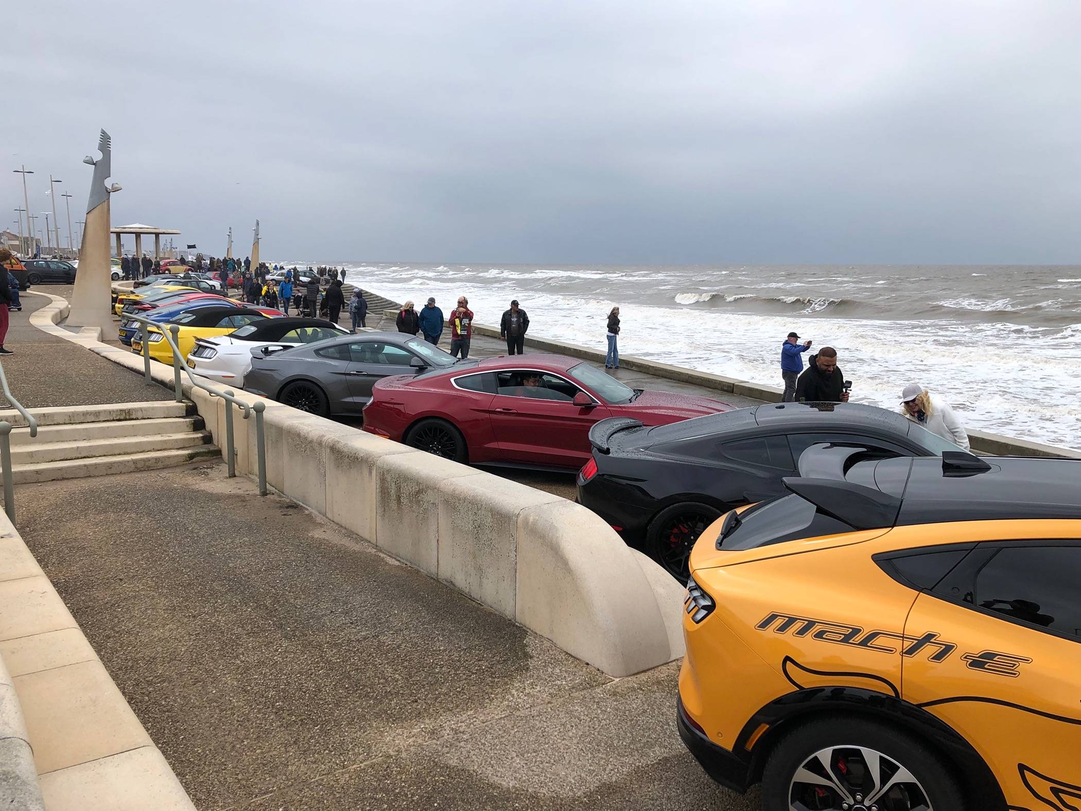

I was at a car show on the coast today, we turned up about two hours after it started and all the cars already had rusty disks …
The ones just off the prom were better, but not by much.
