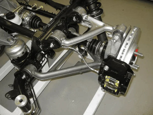

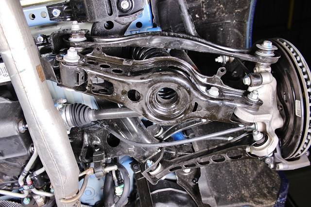

I don't know who the primary designer of this suspension was, but it's the same basic package that was on the SN95 Cobras 20 years ago, so that guy is probably living on a Florida golf course somewhere enjoying his retirement. It appears he was kind of in love with the whole virtual ball-joint thing front and rear. I haven't dug into the numbers at all on this thing at all. Sometimes it's fun to just be a hot-rodder.
For a road car, I understand using big, stupid bushings. If the designer is clever on how they build those bushings, they can make the compliances do some pretty neat things. I don't see much evidence of that here, unfortunately. To your point, there are way better designs. This is off the last generation of Aston Martin Vantage V8. Why not something like this? It would have made our lives easier.
Aston's base GT4 car had poly bushings at each of these suspension points. The spherical upgrade was an expensive upgrade that was only worthwhile if you were really at the pointy end of the stick. It's much easier to pull off with this layout, though, than ours, because all the motion is planar.

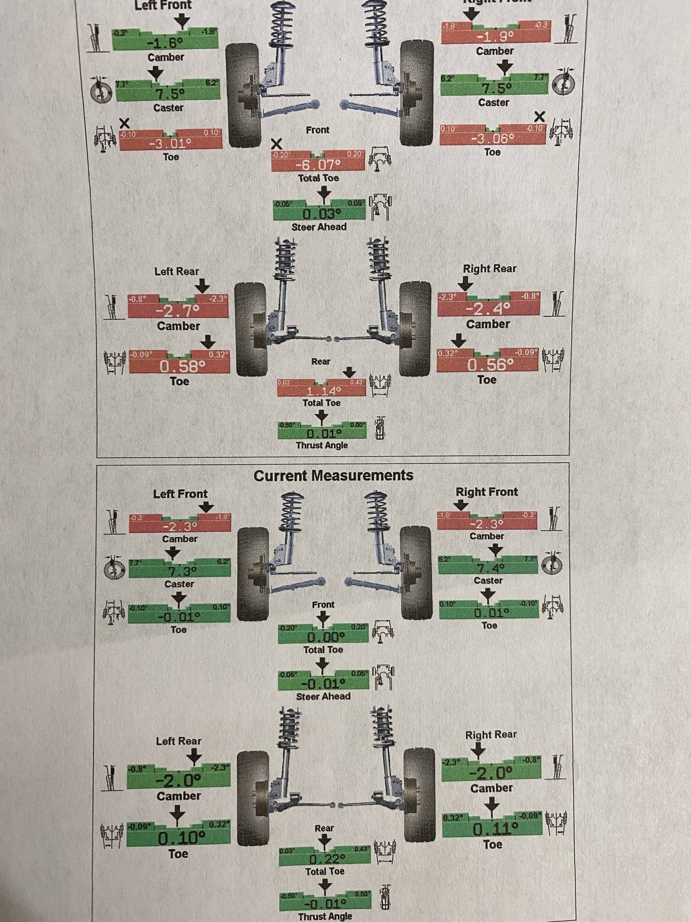

Here is a picture of my alignment. I mostly went with this aggressive alignment in anticipation of a track cross coming up in November. Ill most likely switch back to a street alignment at some point.

^ That's a fantastic alignment sheet.
Yeah you know why all the car pundits say that the Camaro Alpha chassis is so much better? It's nothing to do with the front...those are nearly identical conceptually. The GM multilink is far superior from the perspective of balancing road manners, longevity and performance. No joints forced off axis. Smaller voids. A subframe that has a lot less movement. Once you've fixed a lot of this on the S550, it becomes apparent how much the performance and subjective handling gap is closed.
