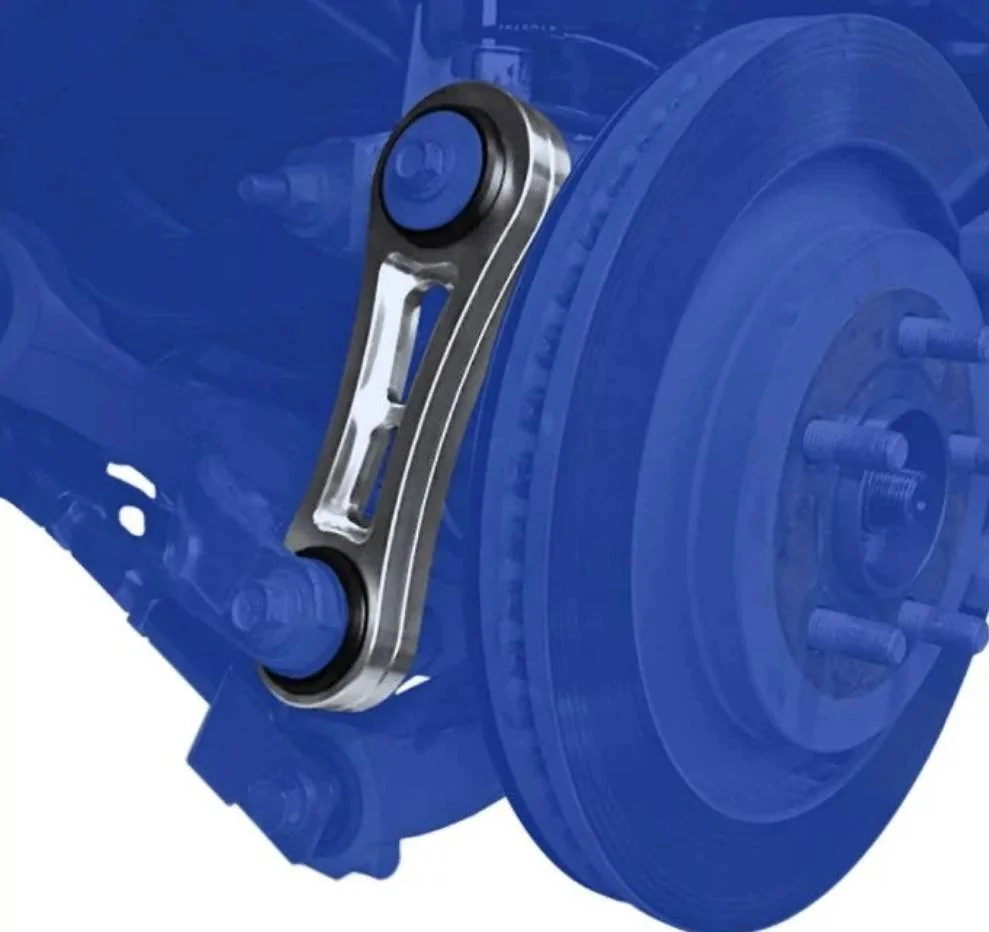

"""""I've never seen an OEM design that did not use double shear for suspension attachments, unless you're thinking about front sta-bar endlinks. But at least those things do not provide any kind of wheel location."""""
See pic below.
Tons of single shear thru out automotive history. When you have worked on thousands of cars that span more decades than anyone whos alive on this forum you see more than an S550 mustang Chassis.

As for single vs double shear & parts YOU FAILED TO SEE ON YOUR OWN CAR??
PROLLY 1st After Market PART we saw built for S550s were these links..
Guess you call this double shear?
See pic below.
So the integral link didn't cross my mind at the time (I've never worked with one). Do you have anything else?

Just use Stainless Teflon lined Spherical's and you will be fine for many yrs of driving.
I would use spherical's in an instant but my race class only allows delrin, poly or rubber. I'll take your abilities and vast sum of knowledge at your word.
You know the S550's weird multilink suspension and the off-axis issues at the bushings.
Post up what your design would be for the RLCA (and the Front too) for those bushings in delrin. I really need a class legal solution.
