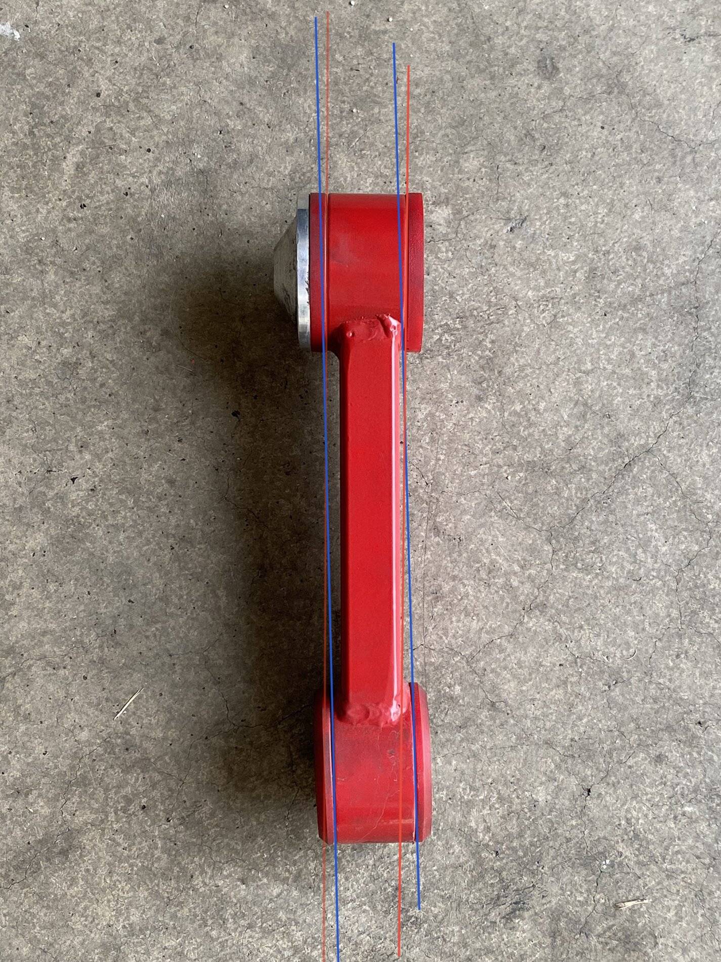

Slightly off topic- I know it’s not your baby anymore, but FYSA. I managed to put a slight bend in a TCA048… maybe 2°. Just happened to notice it. Stock power level, almost full BMR suspension. Links were the last piece, but I had a really bad wheel bearing causing some nasty wheel hop. Dion suggested the hop from the bad bearing may have taken a toll on it

Honestly;
Id say its more likely they were built a little off.
Good thing is that it's not really a big deal as the poly enables it to be acceptable.

No, unfortunately… cleaned it off for a pic, and Somehow didn’t get a pic. I’ll pull it this weekend and get one.
It bent on the bottom side at the weld point. Only 1-2°… but you mentioned bending one in one of your videos, so I was inspecting specifically looking for a bend.

I got a little ambitious. Here’s a pic.
Red line is parallel with top mount. Blue line is parallel with bottom mount. Measures right at 1°. Slight, but still measurable

Downside - likely a bit more NVH, and possibly hitting the tires a bit too hard under some conditions (and tire choices).
Upside - sphericals will allow the sort of angular rotation that would try to bend the link exactly as you pictured it. While polyurethane will tolerate small amounts of this off-axis rotation, it only does so while generating forces much larger than when softer materials (OE) are used. This is polyurethane's curse/unwanted side effect.
Wheel hop not only exaggerates the magnitude of such forces (it's an impact factor thing), it also runs up the number of severe alternating stress cycles much faster than you'd ever see in anything even remotely resembling normal driving (a cumulative fatigue effect, which can and does have a limit).
