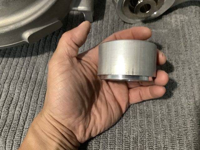

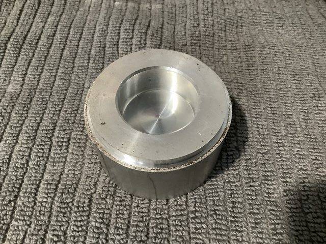

@SlowStangGT, here is the Steeda press tool that came with my spherical bearing. I had my buddy turn it down in his lathe (created a lip on it), to make it fit perfectly into the sleeve. Maybe you could make one from aluminum to suit your needs as well.

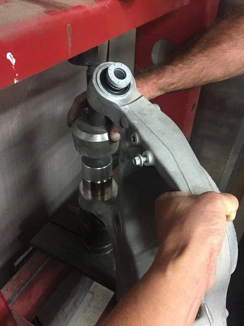

To install just the polyurethane bushings, you can press the rubber out of the factory sleeve and then burn the residual rubber out, using an arbor. This is what I did with my 12 ton shop press. I only ran into trouble when I went to press the sleeve out. My brand new 12 ton press was no match for the sleeve and bent the press ram, rendering my press useless. It was at that point that I had to take it to my buddy’s shop (as seen in the pic), where he used his large 20+ ton press, which was still a bit of a struggle to press the sleeves out, but eventually got the job done.
