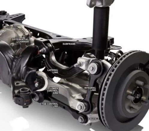

Hopefully you’re able to read the descriptions.
Personally I prefer camber arm over lateral link and vertical link over integral link.
Note where the toe link attaches to the knuckle (outside end). Regardless of spec, this point is a rubber bush From the factory. This is where we fit the FR Toe/knuckle bearing.
I'd give you "camber link" but not "camber arm". A link is geometrically free to rotate in off-axis directions where an arm is not.
If your "camber arm" was really an arm, there would be no need for the vertical link (or integral link, I don't much care which) because the now upper arm would be able to resist fore-aft movement of the knuckle at its attachment. Of course then the suspension would be called a short-long arm suspension . . .
Picky? Probably. But that's how confusion can be at least minimized.
Norm
Ok. However, strictly speaking, the camber link itself (arm?) isn‘t designed to allow off-axis rotation (Eg, at the subframe end, any off-axis rotation that does occur is purely the result of bushing deflection.) Ergo, the camber links are in fact generally marketed as camber arms...
Semantics.
The reality is that the camber arm/link operates exactly like an arm, until you bolt the knuckle to it. The camber arm itself moves in a prescribed arc and there is no intended off-axis rotation of the arm itself.
If we were to apply the same logic to the lower control arm, which acts in the same way at the subframe end of the equation as the camber arm does, but also allows the knuckle to move off-axis via the simple fact that there is only one point of connection via a spherical bearing, it also would have to be considered to be a link rather than an arm because it allows off-axis rotation of the knuckle also.
Food for thought.
