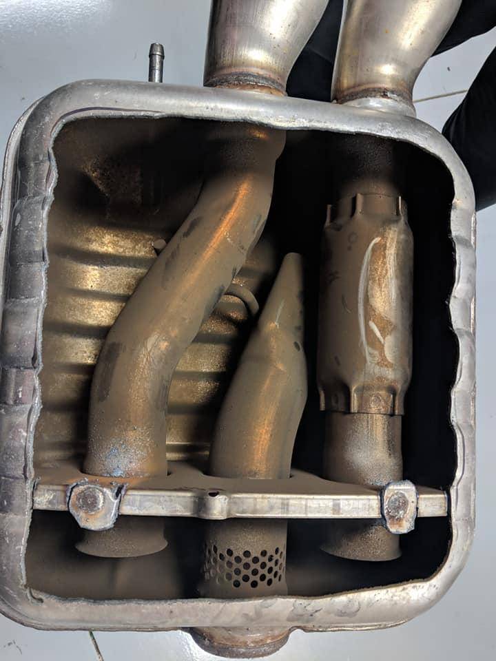

Here is a non active silencer :
Doesn't look so nice in there does it ...

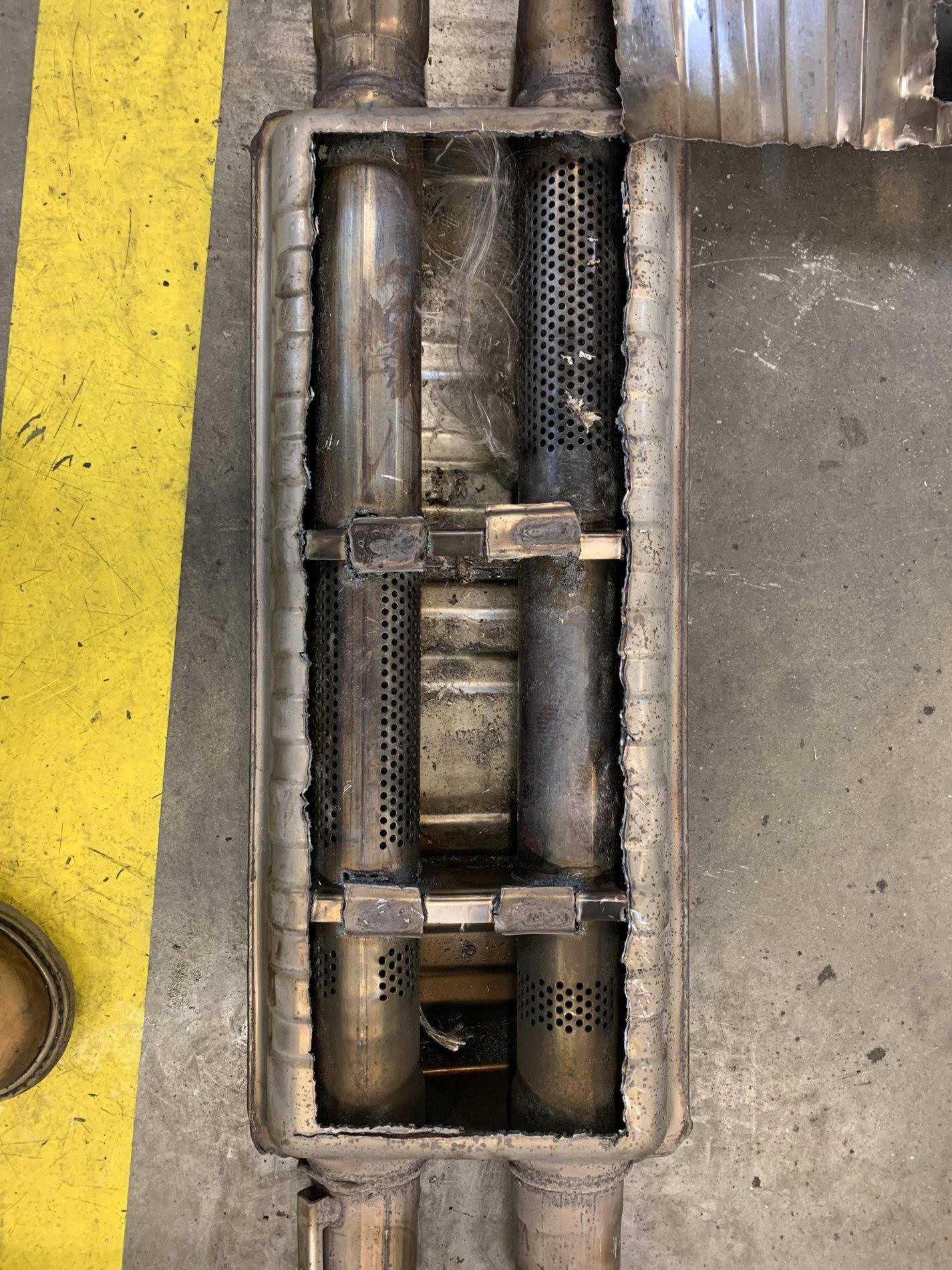

Anyhow, the descriptions on how the box works further up this thread are perfect, but I can add a bit more info when you reference these three photos.
Note the spot welds around the box :
They hold an internal baffle plate. splitting the box into two chambers.
I will call the first smaller chamber number 1 and the second larger chamber number 2.
Chamber 1 has a condensation drain.
Here is the non valve outer exhaust pipe internals :
That's the outer box wall you can see (remember our euros have a GPF so the internals are pretty mush as clean as the day they were made).
That pipe is perforated and runs through both chambers, pretty much up to the outer box wall.
Here is the valve inner / central exhaust pipe internals :
Note it was really hard to get a good photo down there as the valve took all the flash and the focus.
By naked eye, you can see straight down it, out of the back of the box and right to the first bend in the exhaust tubing.
Like the outer pipe it's perforated and as best as my eye can make out, I think the pipe has a small gap in it that vents into chamber 1 i.e. rather than one continuous pipe, it looks like two pipes perfectly in line, but slightly separated.
So ...
Valve open = Gas is straight through both chambers with some pipe perforations.
Valve closed = Gas backs up behind the valve. (depending on the box stuffing in chamber 2) a small proportion of the gas will pass through the perforations into chamber 2 and out of the perforations into the other tailpipe. Majority of the gas will pass through the pipe separation into chamber 1, head to the back of the box, to exit the other tailpipe passing some more perforations on the way.
Hope that helps - and saves @skinnyb from taking the sawzall to his exhaust ... lol
