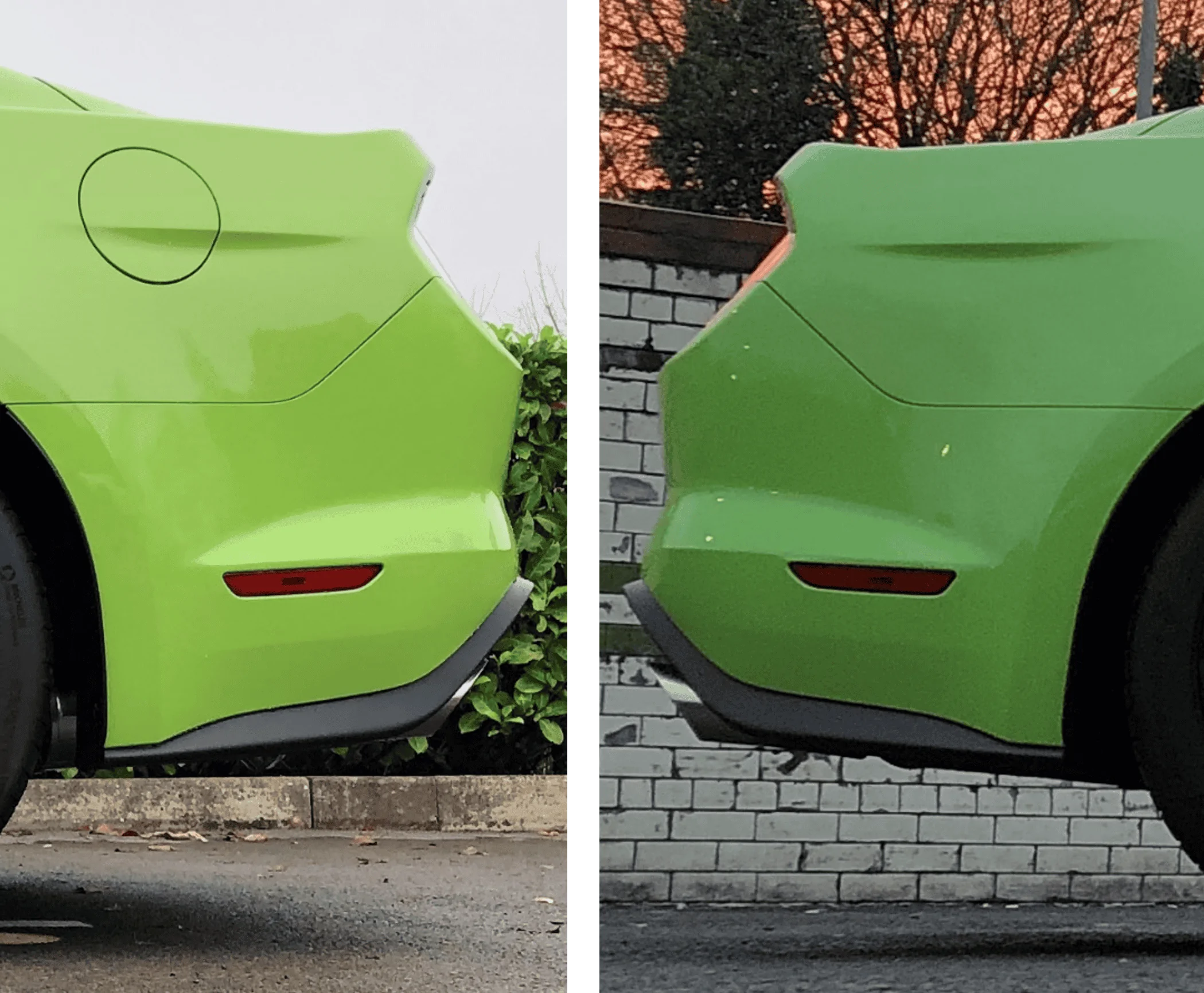

@Mikestang20 The only thing Ill mention is to make sure your pipes are not cut too long or you will risk a short on your exhaust harness on the back. I would even go a little shorter for comfort (assuming you have active exhaust).
This is the way. My shop took an extra 1/4-1/2” off. Just enough slack there now where it won’t get pinched or rub and short out
Before (right) v After (left) :
Loads more info here :
https://www.mustang6g.com/forums/th...blem-after-corsa-install.122416/#post-3701941
WD :like:
